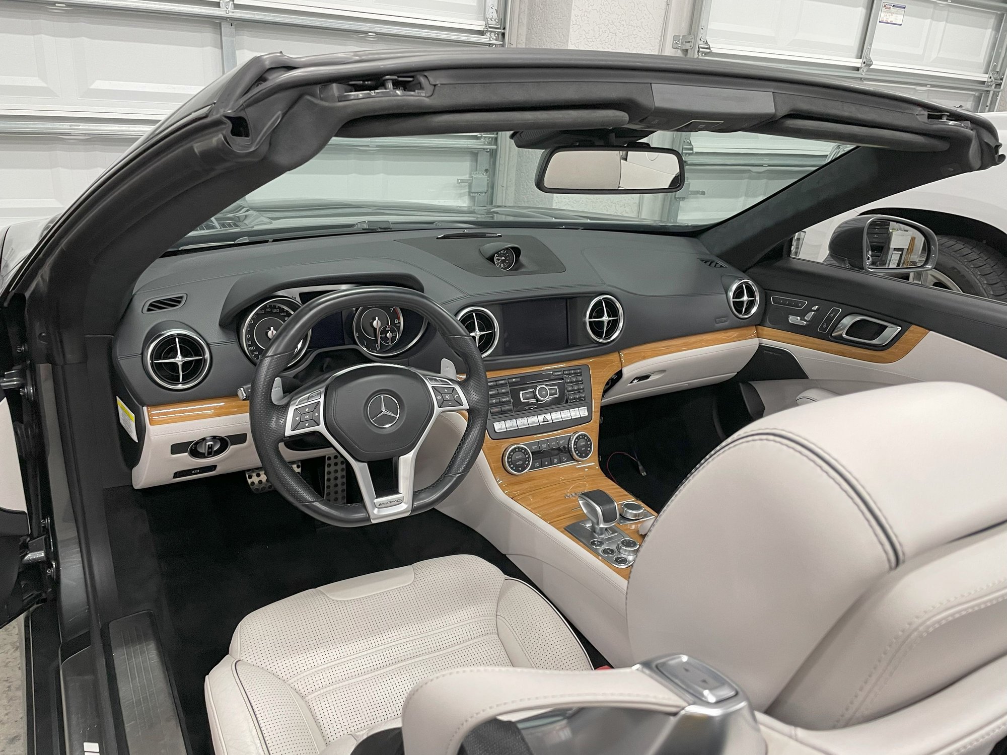

My SL63 has bubbles in the Designo Leather Dash Pad and I was thinking I would have to take the dash pad out and replace it. I was skeptical of the 'steam process' but though I would give it a try. To my surprise, it worked and was relatively easy to do. I hope it lasts. Thanks very much to KiethS for sharing the process. Below are before and after pictures (the bubble on the right by the windshield was removed by the same process after I took the after picture).

Could you describe the "Steam Process" that you used. My S550 has developed some similar bubbles that I would like to correct. Many thanks!

Basically took a smooth wet/damp sponge, wet the area that has the bubble, let it sit there for a minute, blotted it dry with a towel, than took a hair dryer to it on high heat going back and forth around the area. Also smoothed it out with my hand and roller while it was hot.

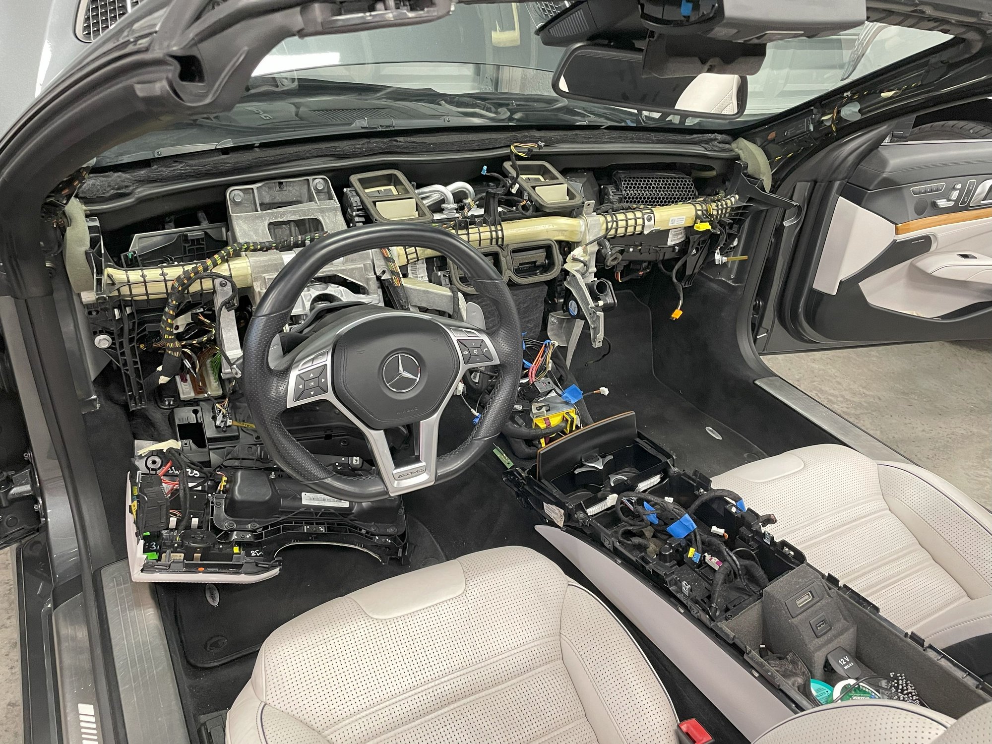

Unortunately, the steam method repair did not last very long so I order a new dash pad (non exclusive leather because it was discontinued plus it was more than $5,000 instead of $2,000 for the standard) and ~ 8 hours later the issue was gone.

Wow... Great work. I'm in Central Fl: fancy a side job? LOL
You didn't do this yourself, did you???

I am impressed. No way I could even attempt this job. Well done.

@DCF Would love to see more photos of the work in progress if you have any? It's helpful to see that the dash cover comes off without requiring pretty much all the innards to come with it.
If I took mine off I think I would take it to a good upholstery shop and get a quote to have them strip it and re-cover it.
