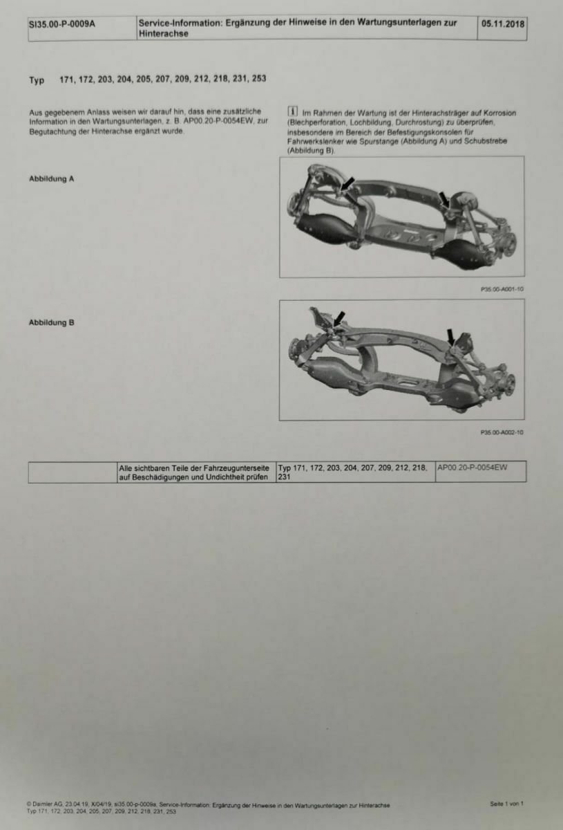

There are a number of models built in the last decade that have excessive corrosion and deterioration to the rear subframe, the R231 being one. Here's a link that discusses everything on another forum (I could not find any discussion here):
W204 rear subframes deterioration | Mercedes-Benz Forum (benzworld.org)
There is a service supplement addressing this: MB Service Supplement Document regarding rear subframes: S135.00-P-0009A
Is there any evidence that this issue applies to our R231's and if so does it apply to all model years?

Yes, the R231 is included in the service bulletin. I will post the list when I get home. I have not been able to fine a copy of the bulletin yet, but will keep looking.

To keep this in perspective, there are no known instances for the R231.
This is a note to check for rust during rear axle maintenance, not a service bulletin.

Not trying to create panic, but just making folks aware of a potential problem.
Here is an English version for us mono-linguistic types.

Makes sense but keep in mind that it is a supplement to maintenance notes and covers a whopping 21 Model years (2000-2021)...Originally Posted by JettaRed
Not trying to create panic, but just making folks aware of a potential problem.Here is an English version for us mono-linguistic types.

The Service Instruction is available in the WIS/ASRA.

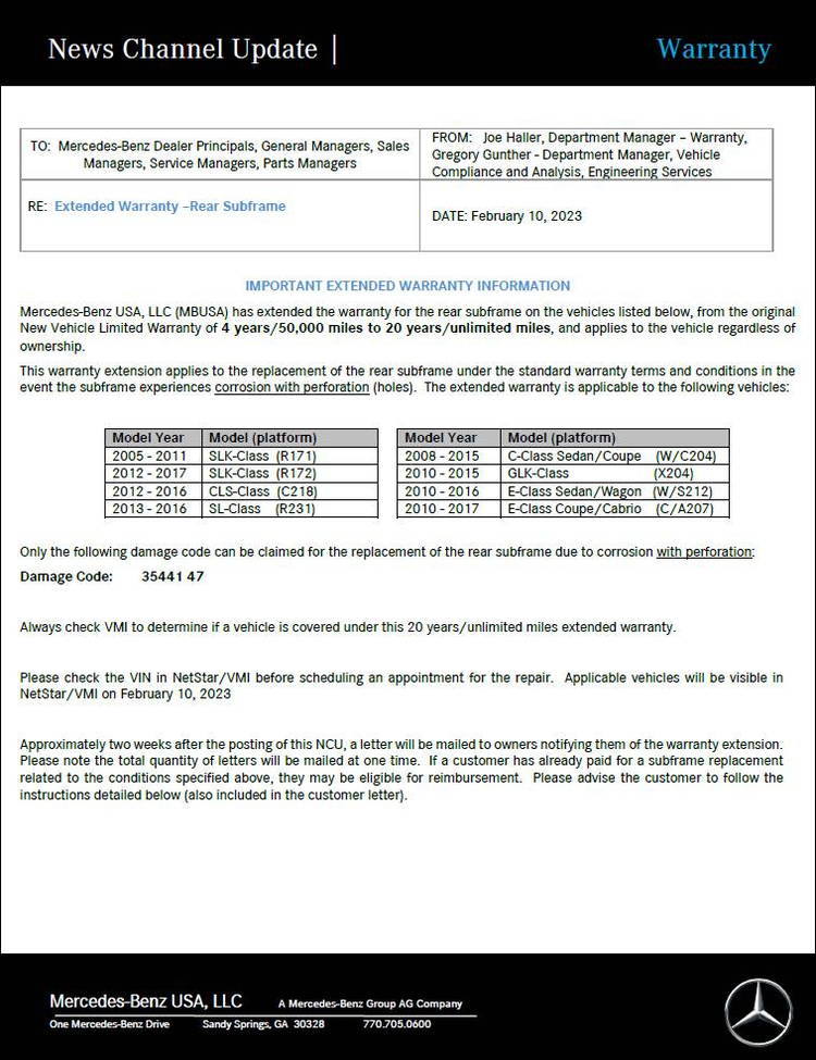

An extended warranty has been issued (Feb 8th ?) that covers corrosion PERFORATION in the subframe for 20 years.
https://cimg8.ibsrv.net/gimg/www.mbw...5455cd4b05.png

Quote:
🤦🏼🤦🏼🤦🏼Originally Posted by Montreal300
because the subframe is mild steel not alu
Does this mean the 2018 and newer SLs don't need to be covered and if so why; are the 2018 and newer years built with better rust resistant materials or what??

Yeah but, Montreal's attachment states only for MY 2013-2017 SLs so........looking for answer to:
Is there any evidence that this issue applies to our R231's and if so does it apply to all model years so it will cover my MY 2018?
