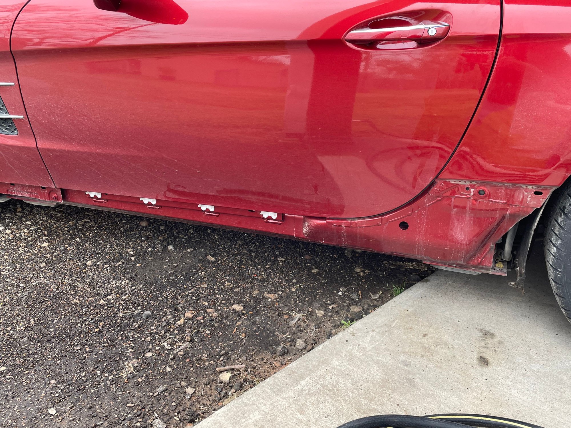

It finally happened on I-10 today in my ‘19 SL550. Construction trailer drops a 150 pound roofing tar block on the freeway at 70 mph. Bounces off the median concrete wall spinning and hits my drivers side behind the front wheel, slides down the lower rocker panel and takes a huge chunk out of the rear tire.
Pressure drops immediately but I am able to get over and make a illegal u turn down a up ramp closed for construction. 90 minute wait for AAA and a tow back home. Two new tires I will pick up on Monday since it was recommended to replace both at the same time. Fortunately only the lower rocker panel needs repainting and nothing above. I hate not having a spare tire!

Yes, If I had been at that spot just one second sooner it would have hit the front end. Into the windshield or wedged under the car. I hate to think what might have happened…..

Lower rocker panel painted and to be installed this afternoon. New rear tire and rocker panel strengthened, repaired and repainted $1600. Could have been much worse if it had been head on….

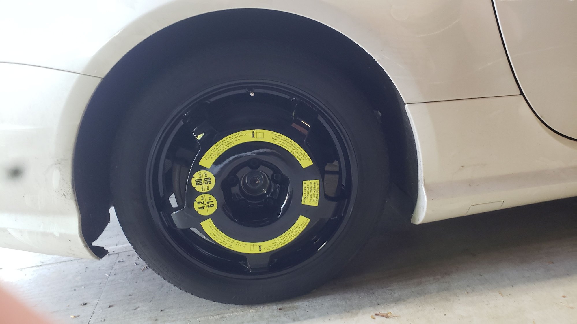

Spare for SL400 (2015) P/N: A2124018802
I have a 2015 SL400 with 19" wheels, 8.8/9.5 width. I cracked a rim, had it repaired, now it cracked again and this model does not come with a spare.
From reading, I read that I can use the CLS model spare, it suppossedlly fits my car. So I purchased a spare from eBay and hoped for the best. I can report that part number A2124018802 not only worked, it uses the stock lugs and fits great. It is 18" vs the stock 19" rims, but since the tire seems taller vs the 35 series OEM 19" tires, it drives fine. I plan to keep it in my garage, and if needed, I will get a ride home to pick it up along with tools if I am ever in a situation where I need it.
The run-flats work, but what they did not plan for was what to do when it is not your tire, but in fact the wheel, that needs replacement? The dealership said the lead time can be 30+ days as the OEM rims need to come from Germany...
Just sharing my info, I was not 100% sure this spare would fit, I can confirm it does.
But it looks so sad with the spare, like a three-legged dog. It gets around, but still looks sad.
David
There may be some refurbished factory rims you can get without waiting for one to swim across the Atlantic. Just Google "refurbished factory wheels".
