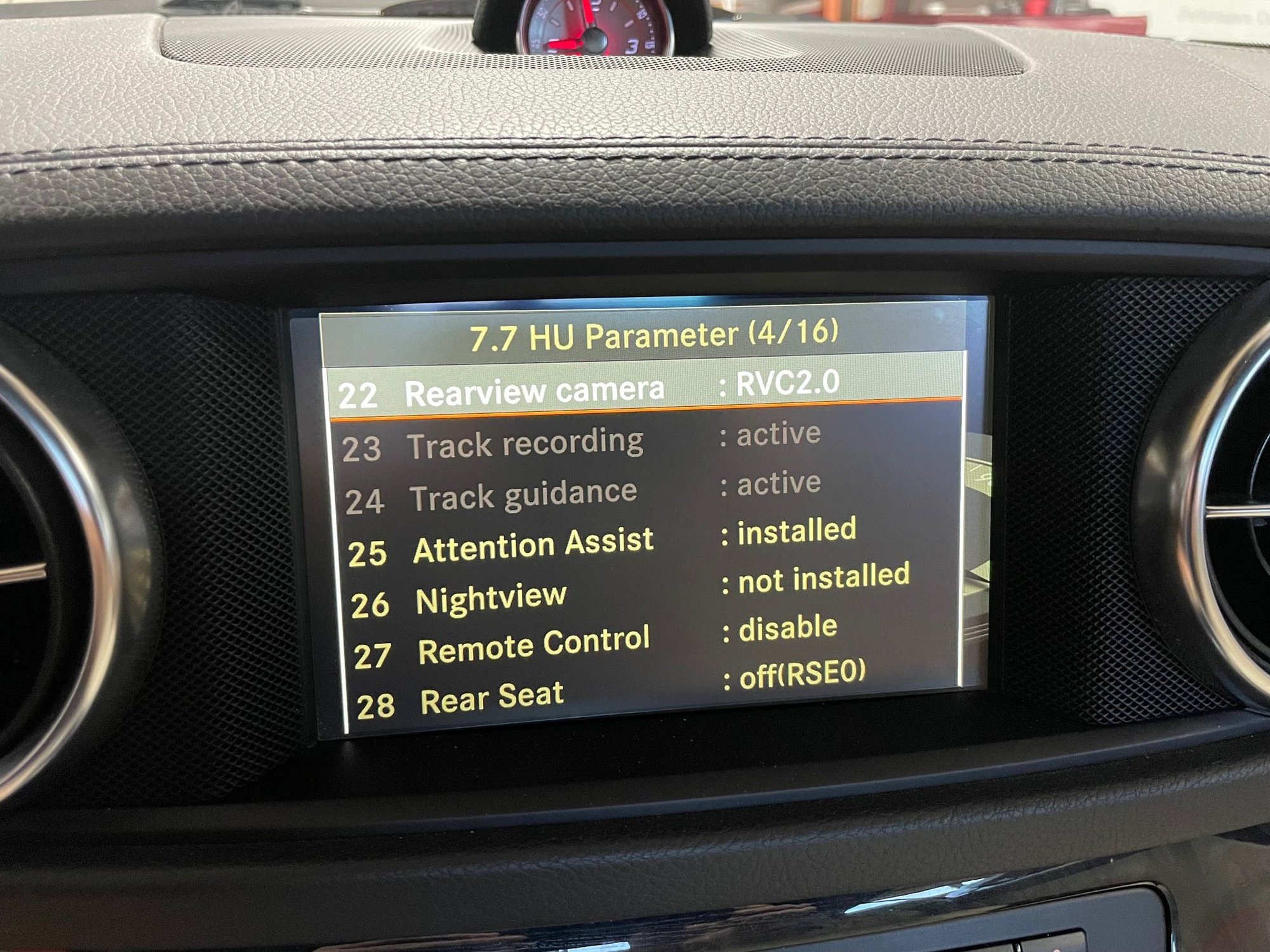

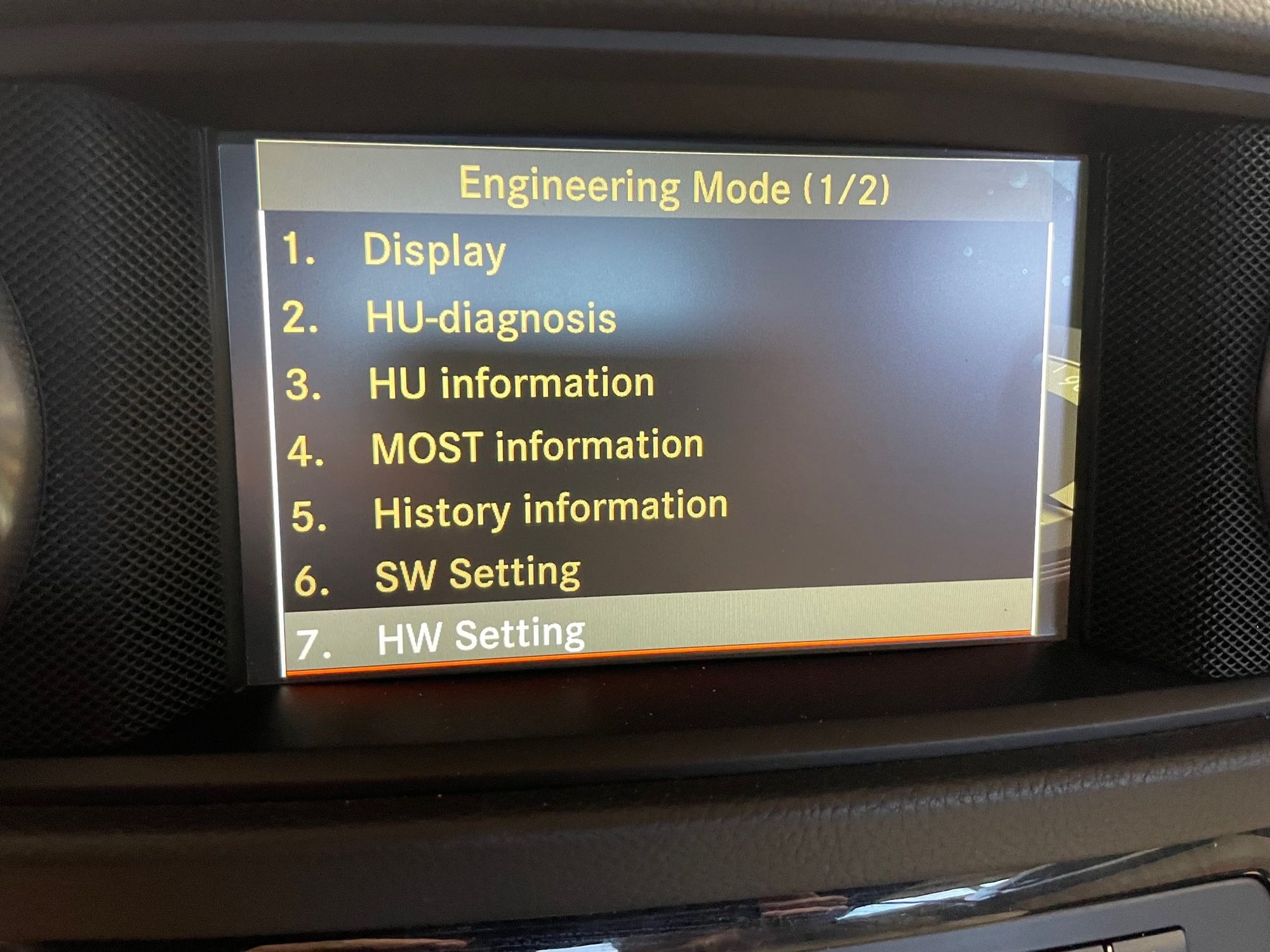

Anyways, You may be able to code it out thru XENTRY/ Vedeamo, though I've never had to or tried doing it. I know calibration is available thru XENTRY alone.
Without Xentry, you can access some camera functions in the engineering menu. Depending on your NTG version/firmware. I've seen some cars you can enable/disable the grid lines. (Euro Cars?)
It might be worth a shot....
There is a thread on how to access to engineering menu here:
https://mbworld.org/forums/c-class-w...ed-thread.html
On my R231(SL550), the options are grayed out. Your car being an AMG, may have more access. You can also change camera type from Advanced (RVC2.0) to standard (SRC) to see to that changes your access. Just remember your settings!!!
(don't muck around too much in there as you can really hose your car!)
Good Luck!

Thanks JR & CR for the responses...sounds like solid info! I fully understand how easily one can fubar their rides with port tools like XENTRY/Vedeamo or VAG COM; no worries here as I am a back it up each time before touching ANY setting guy. 😜 I greatly appreciate the pics as well!
Again...my gratitude. 🙃
