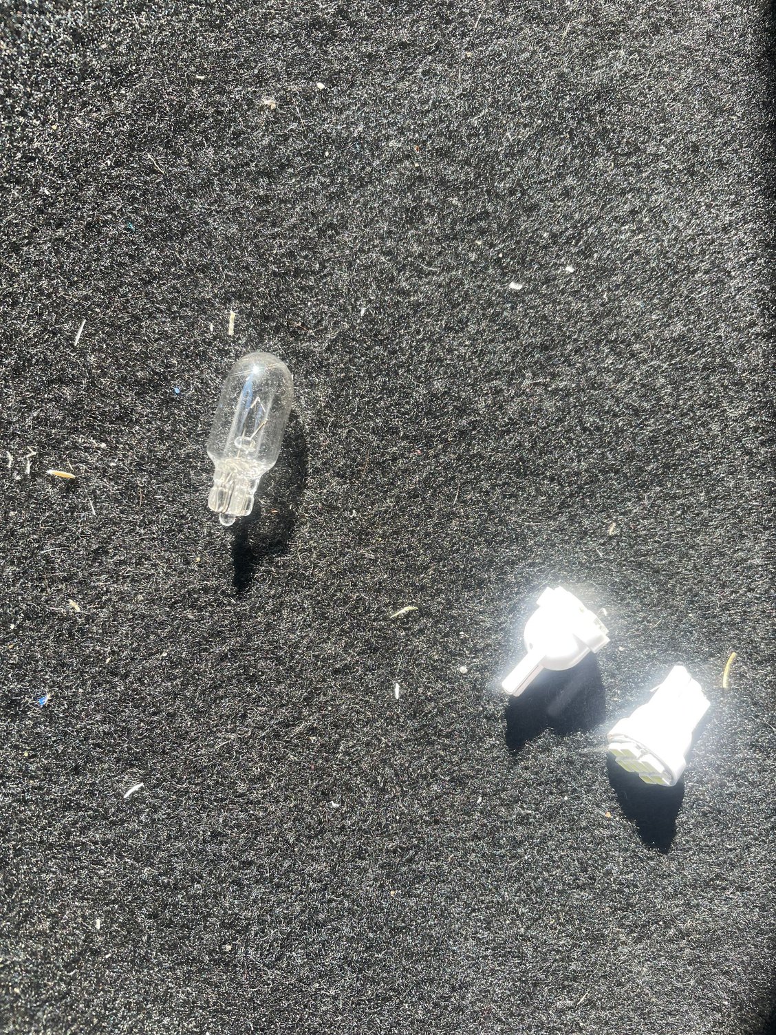

Hello all,
just a quick post to show those that don’t know to take a few minutes and swap out any interior light bulbs you can with newer LED bulbs.
Besides the LED bulbs running cooler and using less power, the yellow looking factory light bulbs make any car look older than it is and the whiter looking light bulbs just shine brighter/whiter and look more modern. Plus at night it looks like I’m caught in a beam of a UFO because they are soooo white and bright. I have always loved the look.
Anyway, swapped out my trunk light bulbs and sun visor light bulbs with LED bulbs. The difference is evident in the pictures and takes less than 15 seconds to swap each one. I had already swapped my glove box light bulb before, but don’t have a picture.
I had purchased a bag of mixed LED bulbs many years ago and have been using that same bag for years. Each time I got a new ride I went back to the bag to find some LED bulbs. Best way to do a swap is to take the old one out to match it up. Since my bag had many different sizes I have always been able to find the ones I need in the pile.
Enjoy.
Trunk after
Trunk before
Trunk after
Trunk after
Drivers side swapped compared to passenger factory.
After both sun visors
Factory left, LED right.

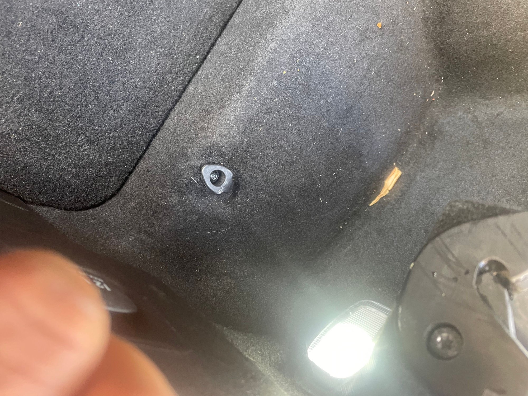

I also was able to swap out the light in the trunk lid. The one that is both red and white. To access that one, you need to remove the trim piece. The others I have been able to pop the lens out to swap the bulbs.
Any special tools or knowledge needed to remove trim?

There are 4 or 5 push pin type connectors on the inside part of the trunk. Remove those and pull down and back away from the car. There are three more barbed connectors that pop out. I will try to get a picture tomorrow.

Here are pics of the pins you need to pop out.
