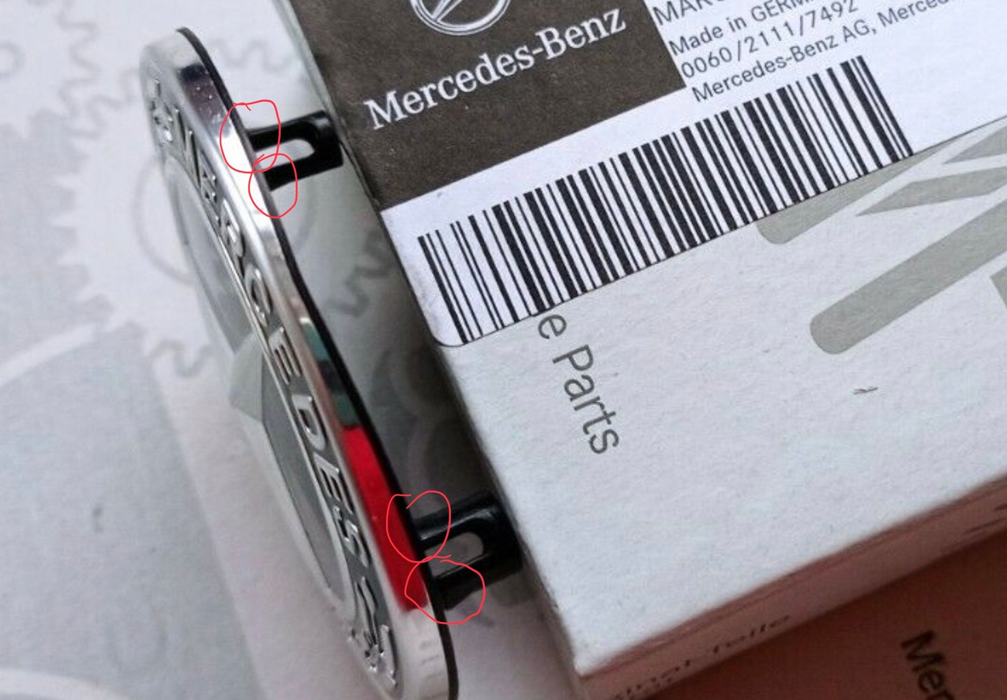

No that’s pretty normal. The plastic is flexing slightly. You have to pull the emblem down via the male pin clips, while pushing up the plastic female surrounding area of that bumper/ front end right where those emblem clips pop in.
The clip should be real tight and cinch at the very top. You can kind of see where the clips lock in on the picture below. (see red circles)

Closer inspection shows what looks like a very small crack in the lower part of the larger key hole. My guess is some one stole the original and there was damage, etc. I think taking off just a bit with a round file may get it, along with possibly some thin automotive double sided tape to make sure. It’s always something!

Yep, I saw where the area is on the posts that is supposed to cinch down…what a PITA…I suppose to do it right the bumper comes off…ugh. I miss emblems and speednuts.
I personally wouldn't enlarge the holes. You want them tight. I’ve seen them fly off when they’re not on tight. 🙁
If one hole is cracked all the way through, 3M VHB Tape may be a better “temporary” solution.
Good Luck.
