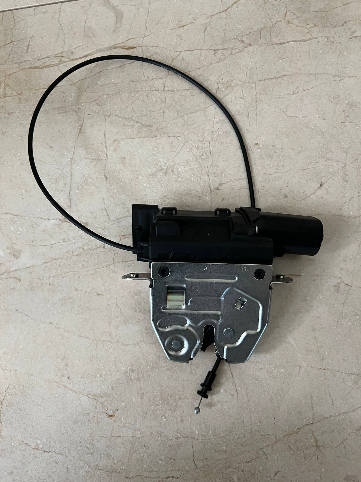

Past 2 years, my R231's trunk will intermittently not open during cold spells below 60F. Using the interior or foot switches was an exercise in futility. Only by pulling the trunk switch/handle twice or more in rapid succession would it open (or use a key). It's not the struts as when it's open, it stays open. No sagging. We're now in the middle of a cold snap here in Houston TX. 1st one this season. The trunk is now totally inoperative. Only way to open was to use a physical key. The culprit is the Truck Lock Actuator Motor PN #231 700 00 85. Fits all R231s. The actuator contains a couple of microswitches. I believe over time, the microswitch springs get weak and is unable to function.
I scoured the internet looking for a reasonably priced actuator. Best price was MB of Warrick. $489.52 on Amazon Marketplace. Easy 45min job.

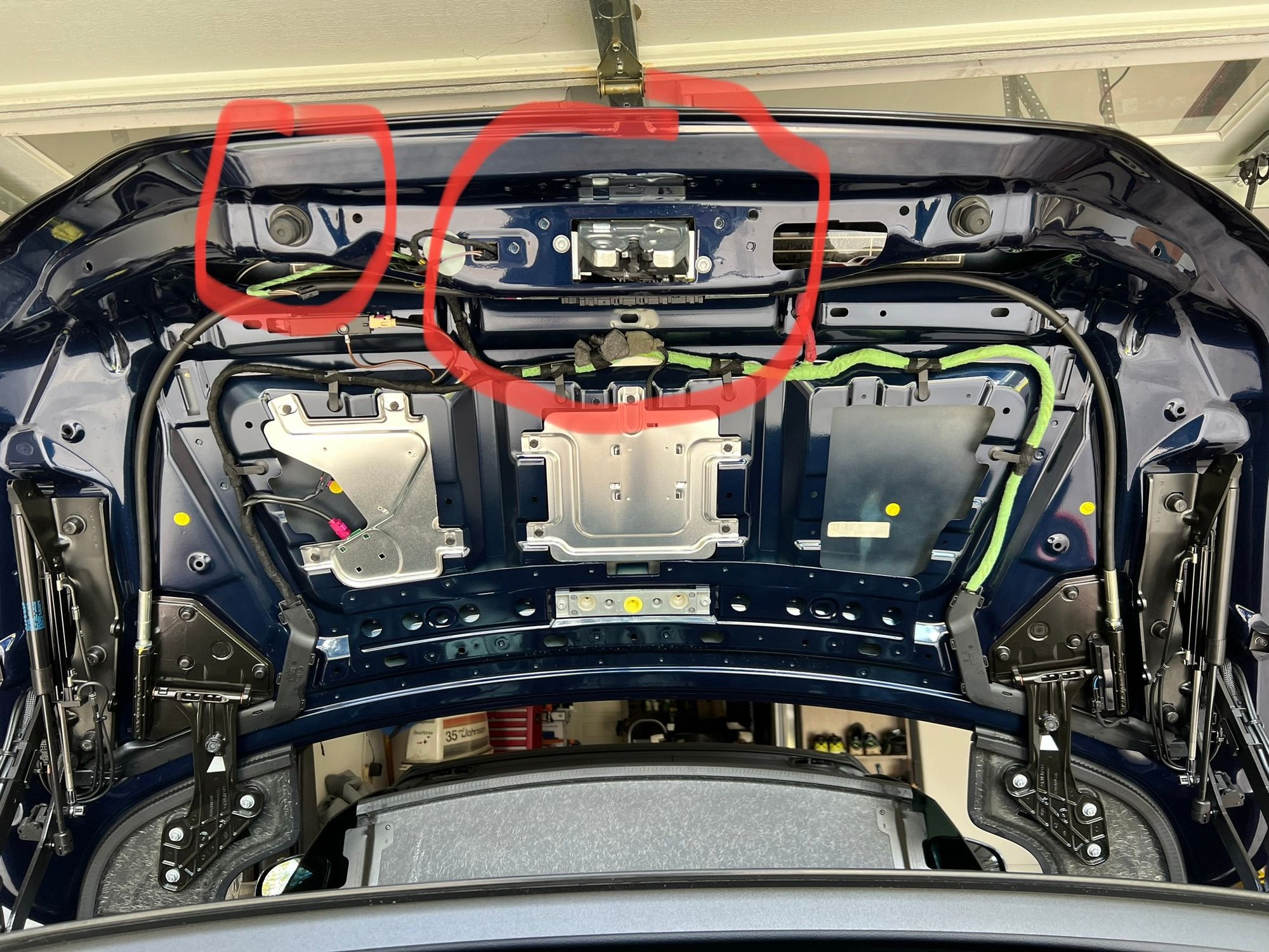

-- Lower top and open trunk. This is so the flaps fold outwards to expose felt trim push pins.
-- Disassemble the actuator decor panel and trunk felt trim which is held in place by a bunch of push pins. this will expose the actuator and the key tumbler. See photo.
-- Don't forget to disconnect the light, close switch and emergency trunk open.
-- Undo 2 torx screws holding the actuator to the trunk.
-- Remove key tumbler by unscrewing one torx screw and rotating counterclockwise. This needs to be done as there is a cable from the tumbler to the actuator that will need to be removed. See photo.
-- Reassemble in opposite order.
Fleabay is full of used trunk actuators for super cheap (below $100) or aftermarket Chinese knockoffs. Do not be tempted. Just buy OEM new and get it over with.
