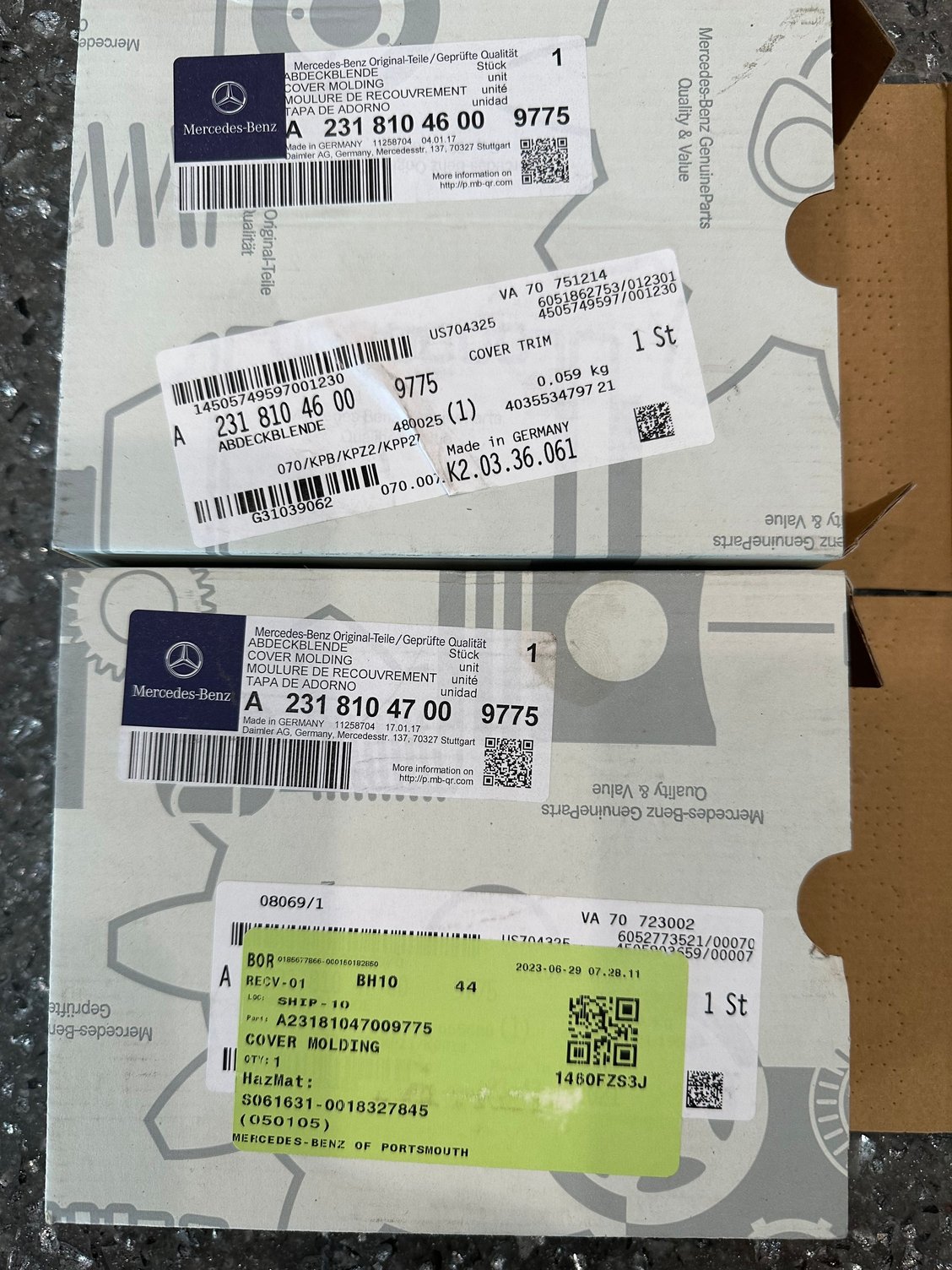

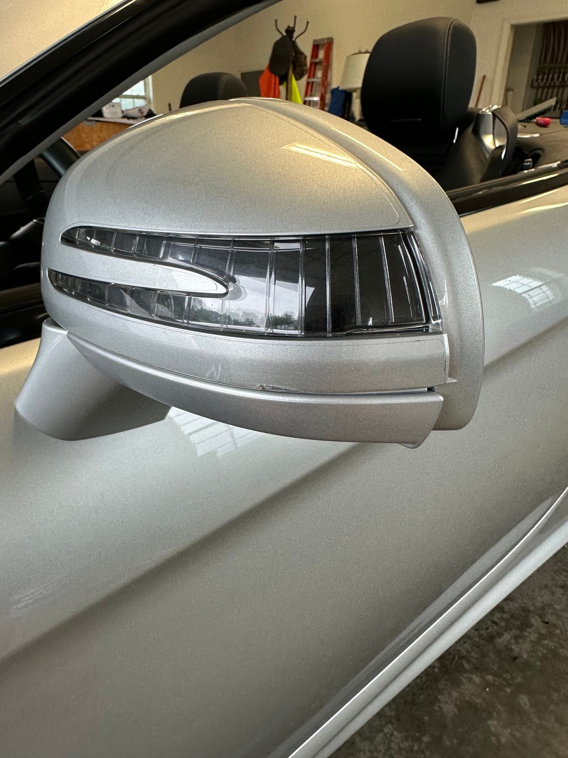

I wanted to give a quick tutorial on r231 puddle lamp replacement. I have no dog in the logo no logo preference… I happen to like them. If you have an r231with plain puddle lamps you can order logo lights from a later model year that came with logo lights. My 2016 came with no logo puddle lamps.. other later models had them. Another thread got me on the search for a part to fit my car. This thread should serve as an instructional post to replace the lamps .. with or without logo. We are talking about swapping a part referred to as cover trim.. the very bottom of the mirror. Here are the parts I ordered WITH logo.

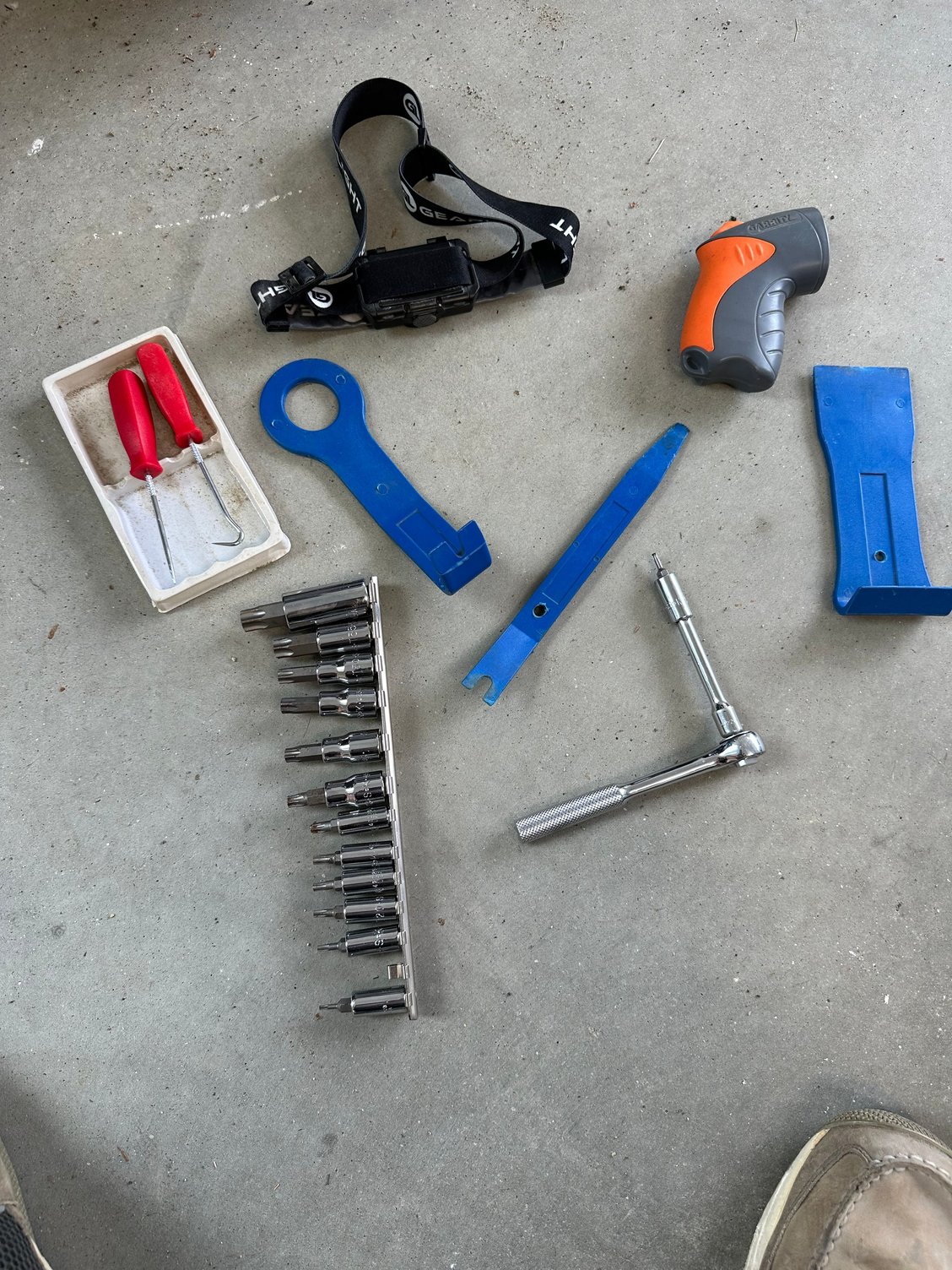

Here’s what you’ll need for tools

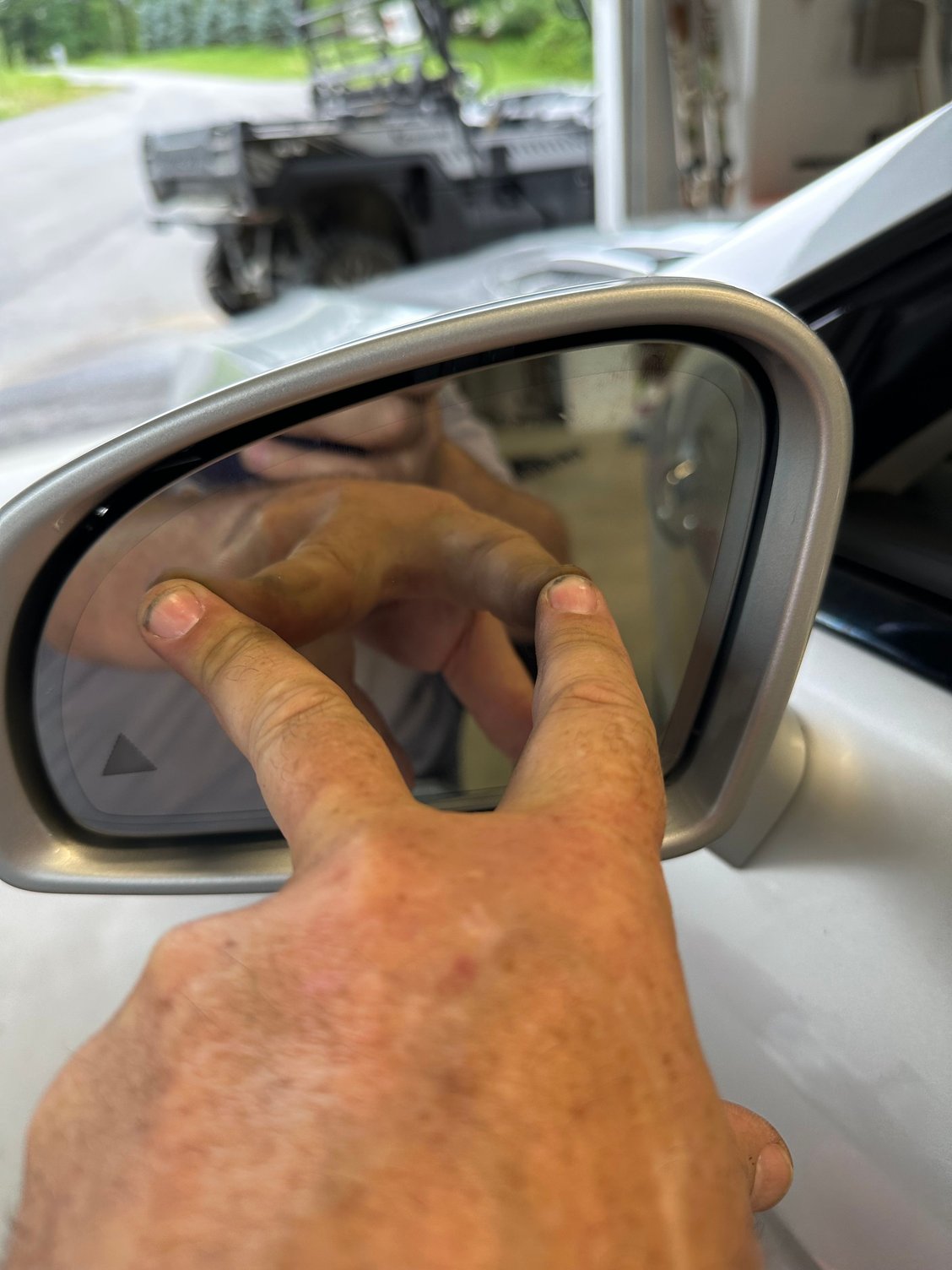

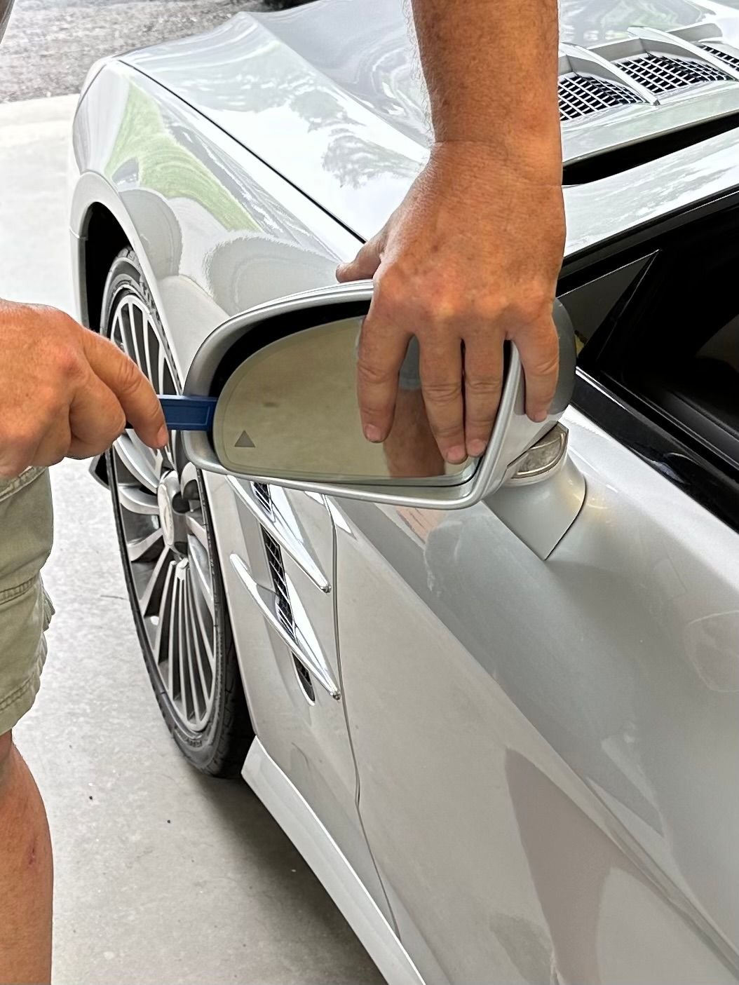

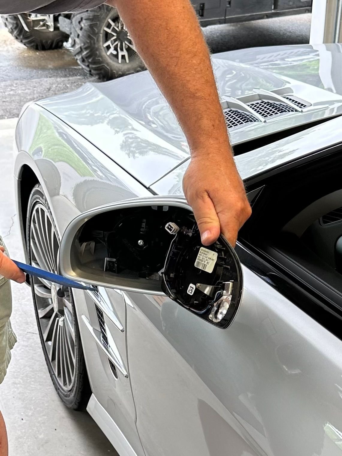

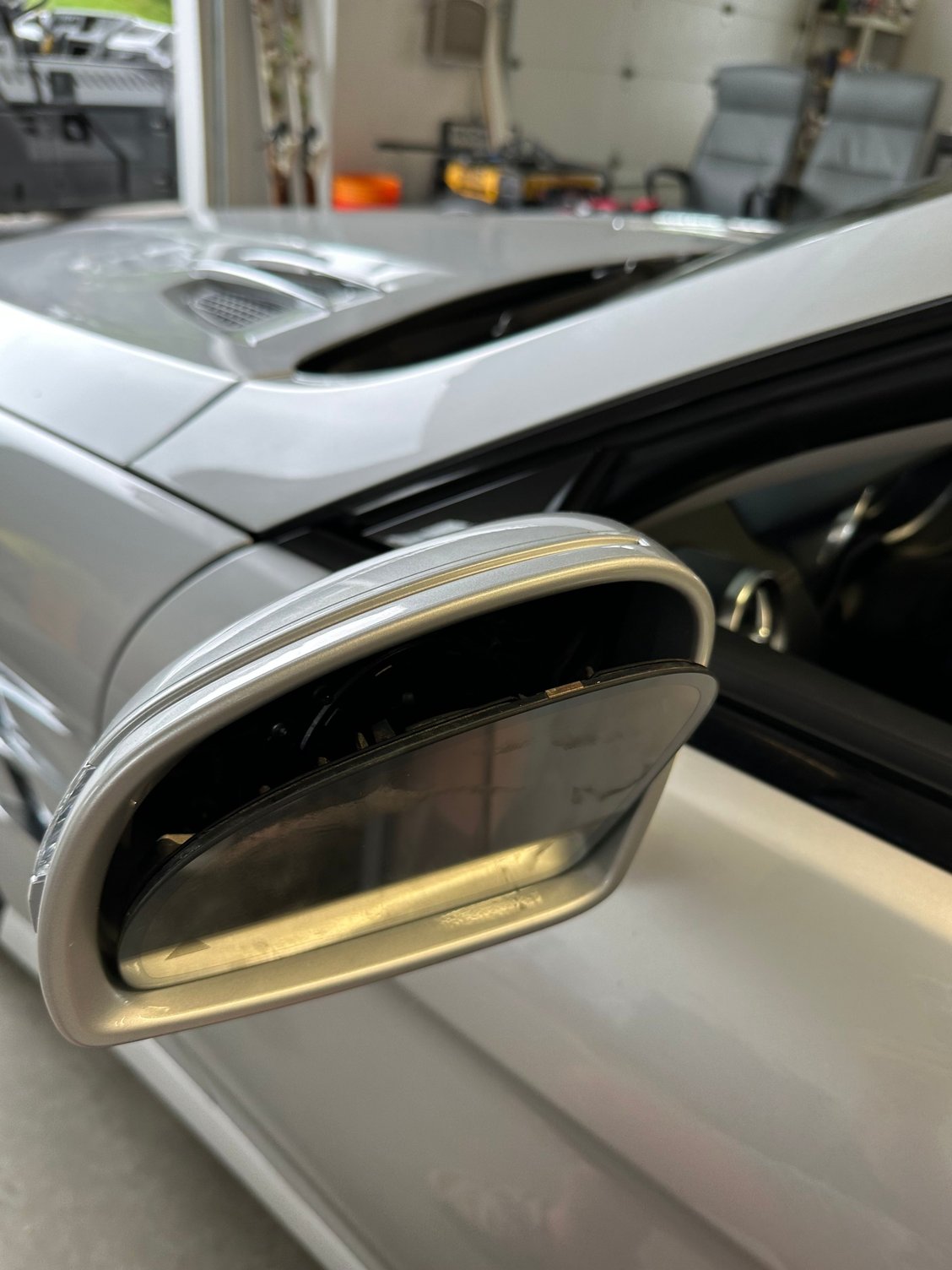

The first step is to remove the glass mirror. To do this move the mirror all the way to one side creating a gap for the plastic tool and pry it out gently… pops right out easily.

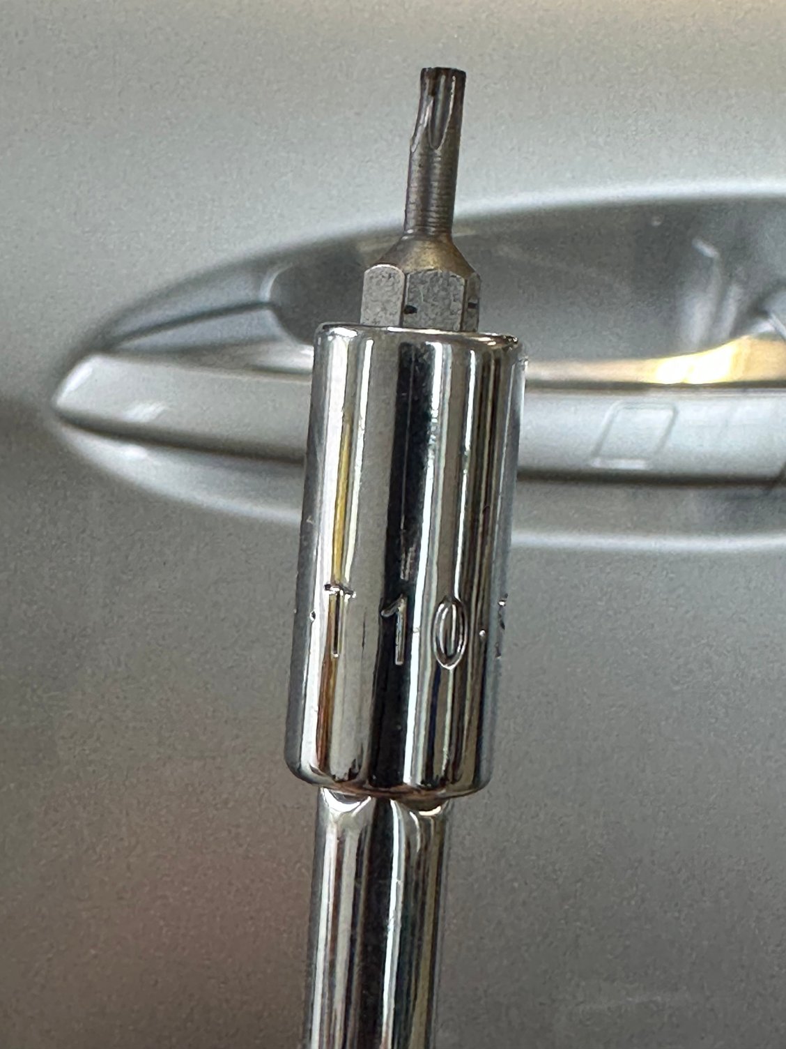

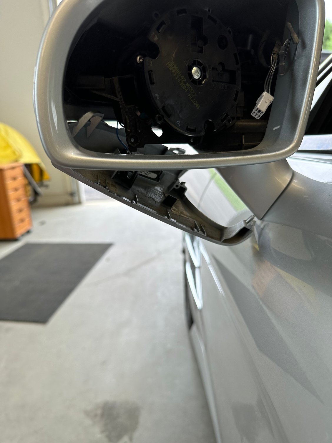

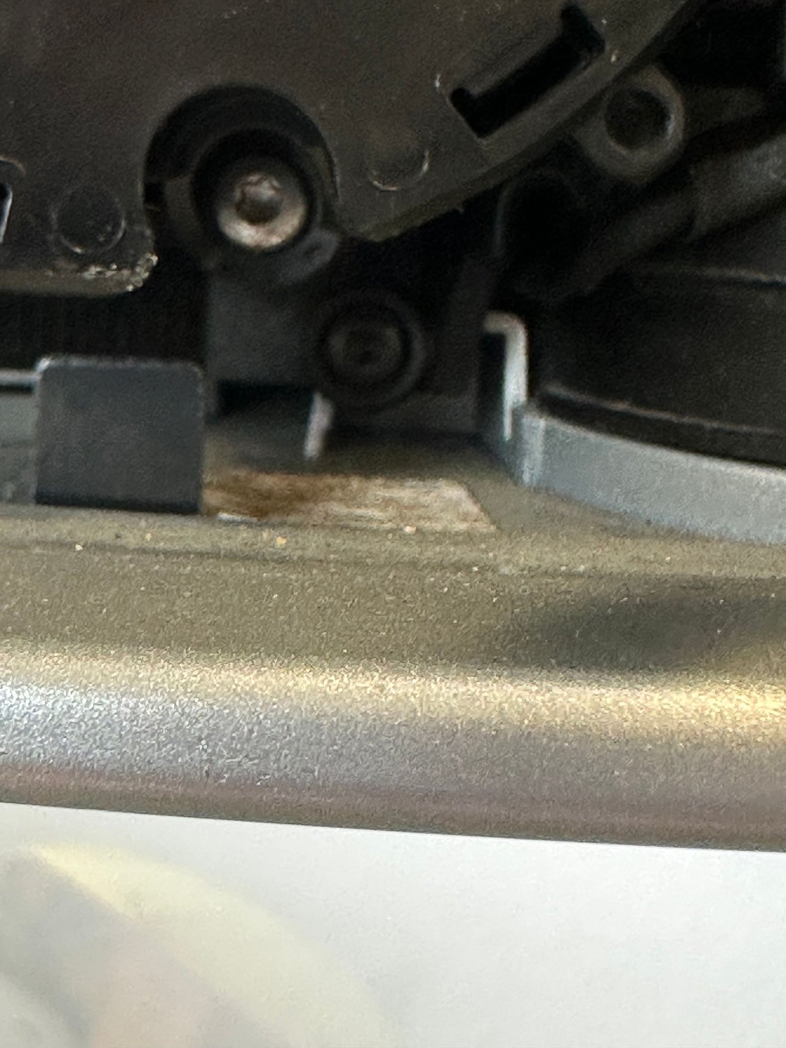

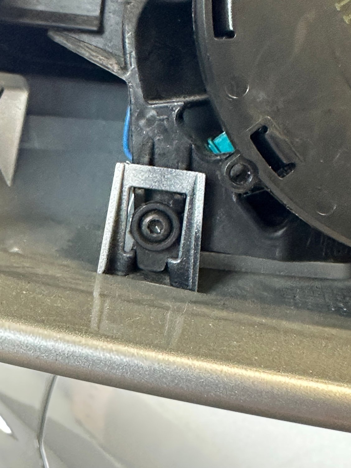

Next remove two small torx screws at the bottom.. mine were t10’s
Old Jul 4, 2023 | 11:30 AM
Kapitan's Avatar
Joined: Jul 2023
Posts: 22
Likes: 10
S550. Sl550

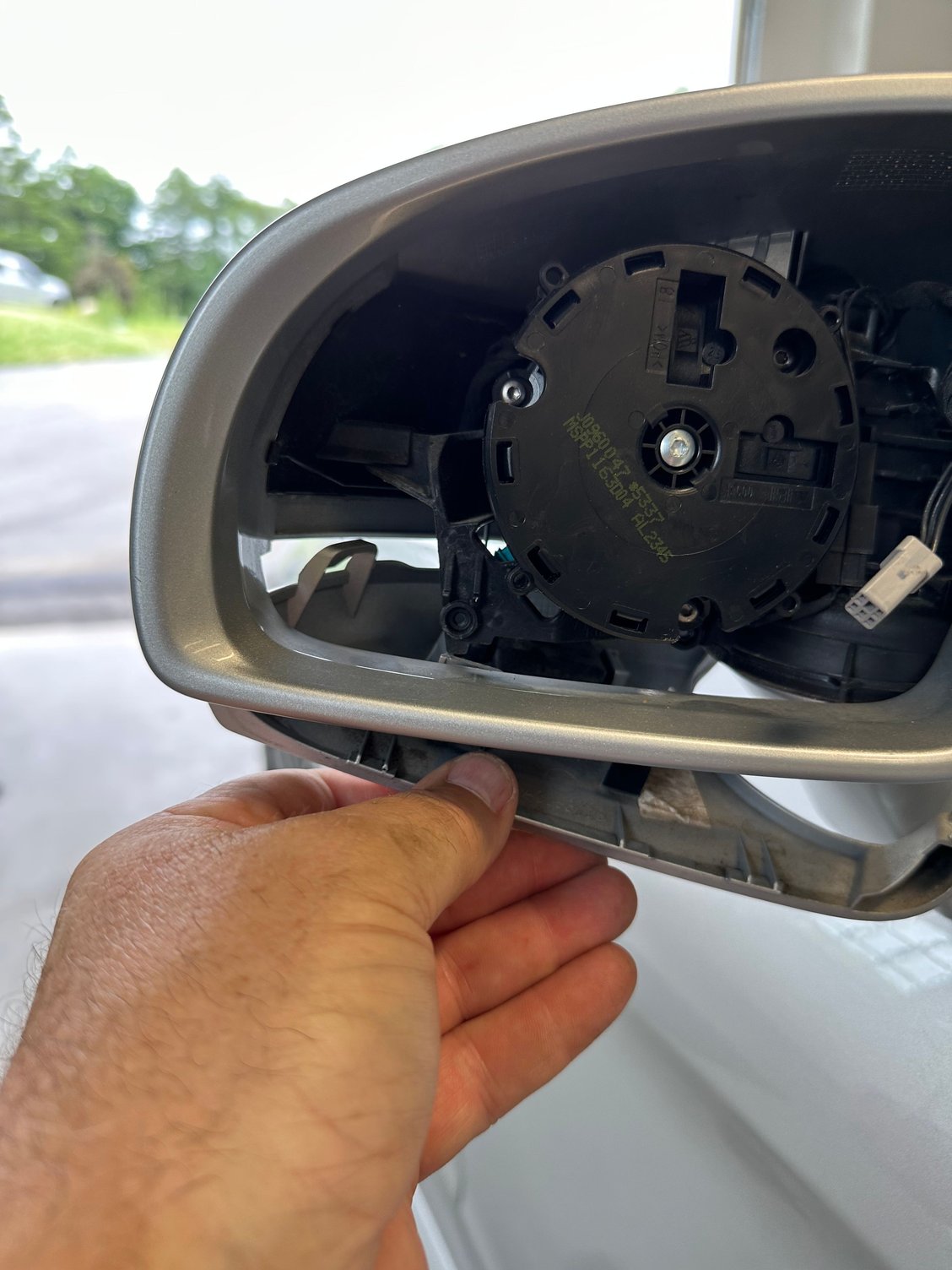

Now with a little gentle prying around the bottom perimeter the lower cover pops out

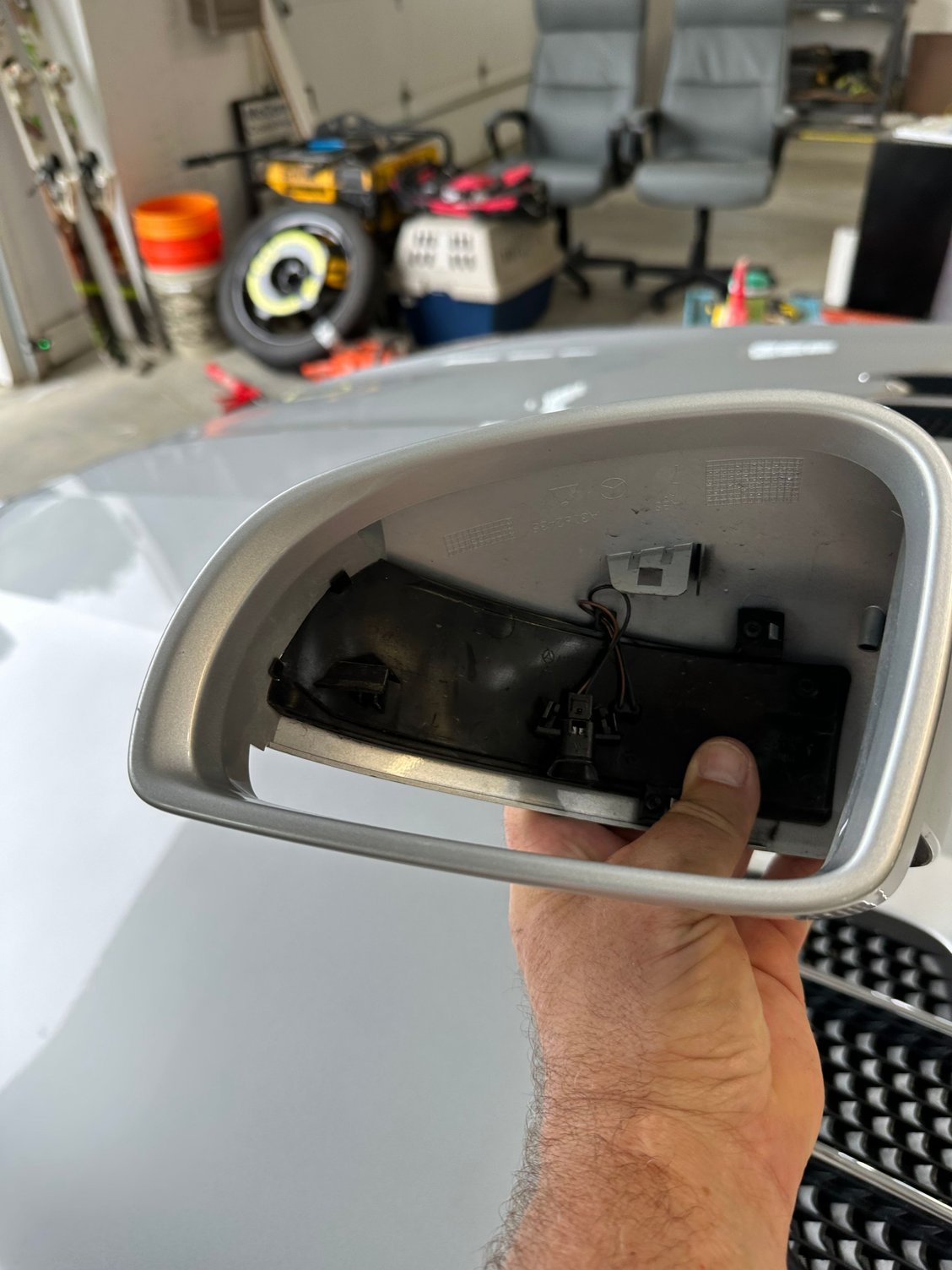

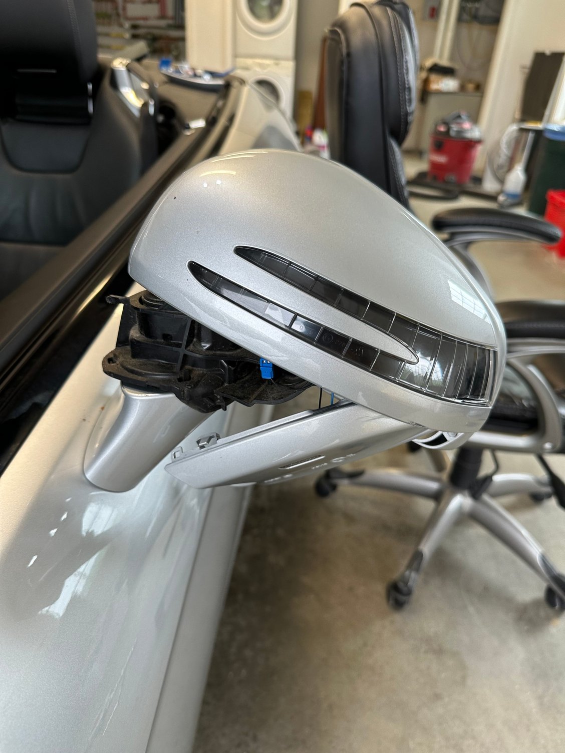

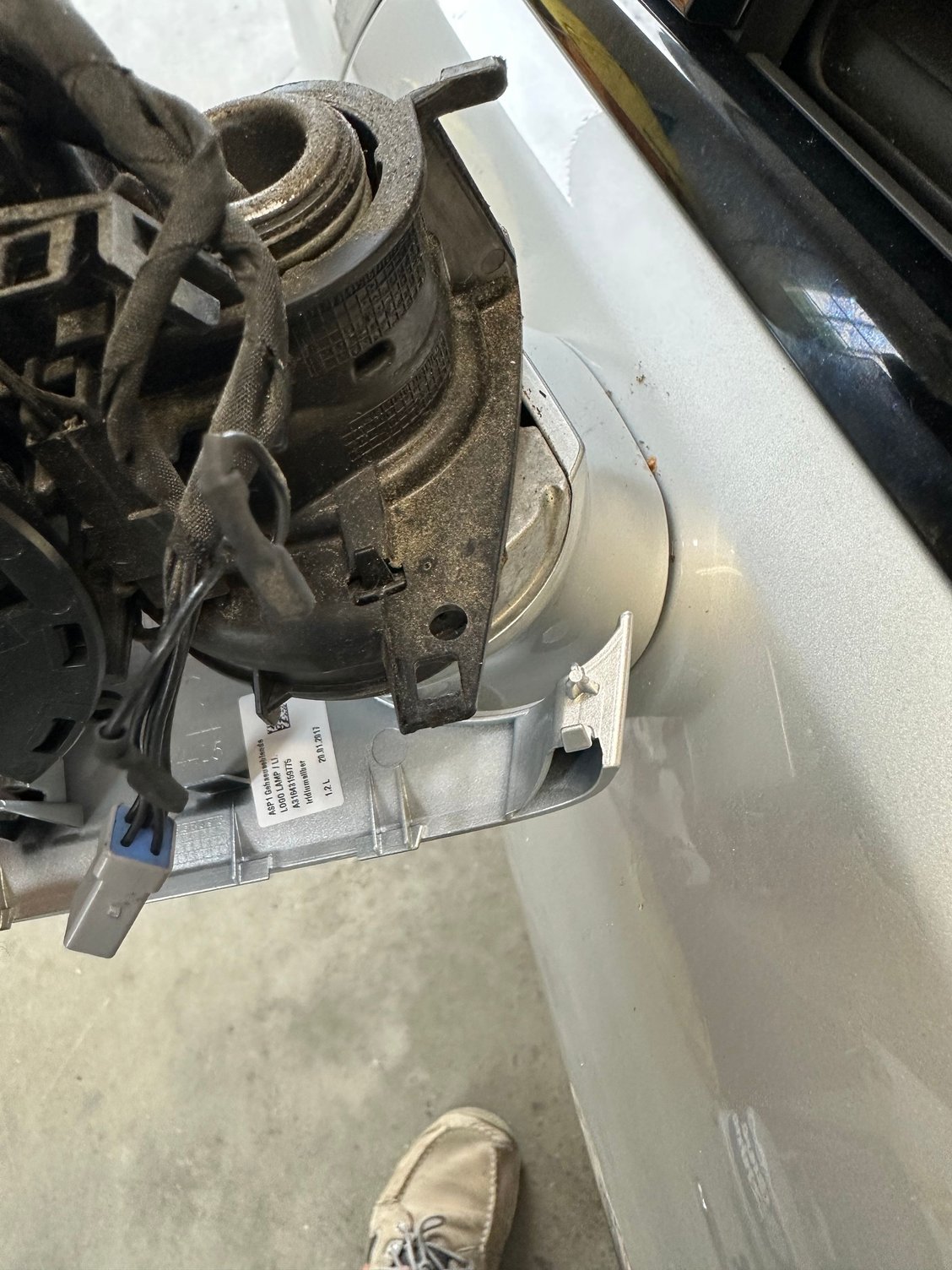

Now the top cover is removed by pulling almost straight up.. it took a little wiggling and a bit of force. There is a plug here which may become dislodged from its mount during disassembly.. check and reposition if needed.

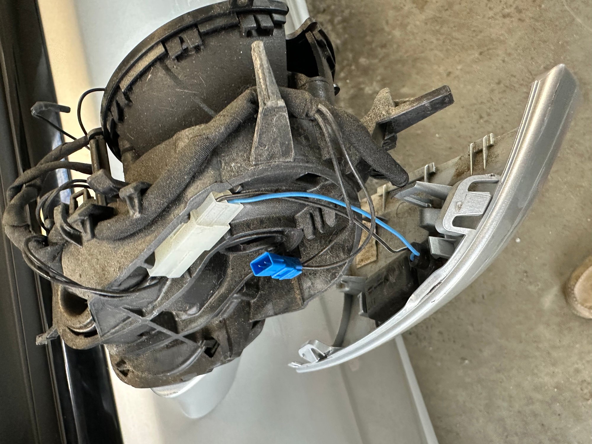

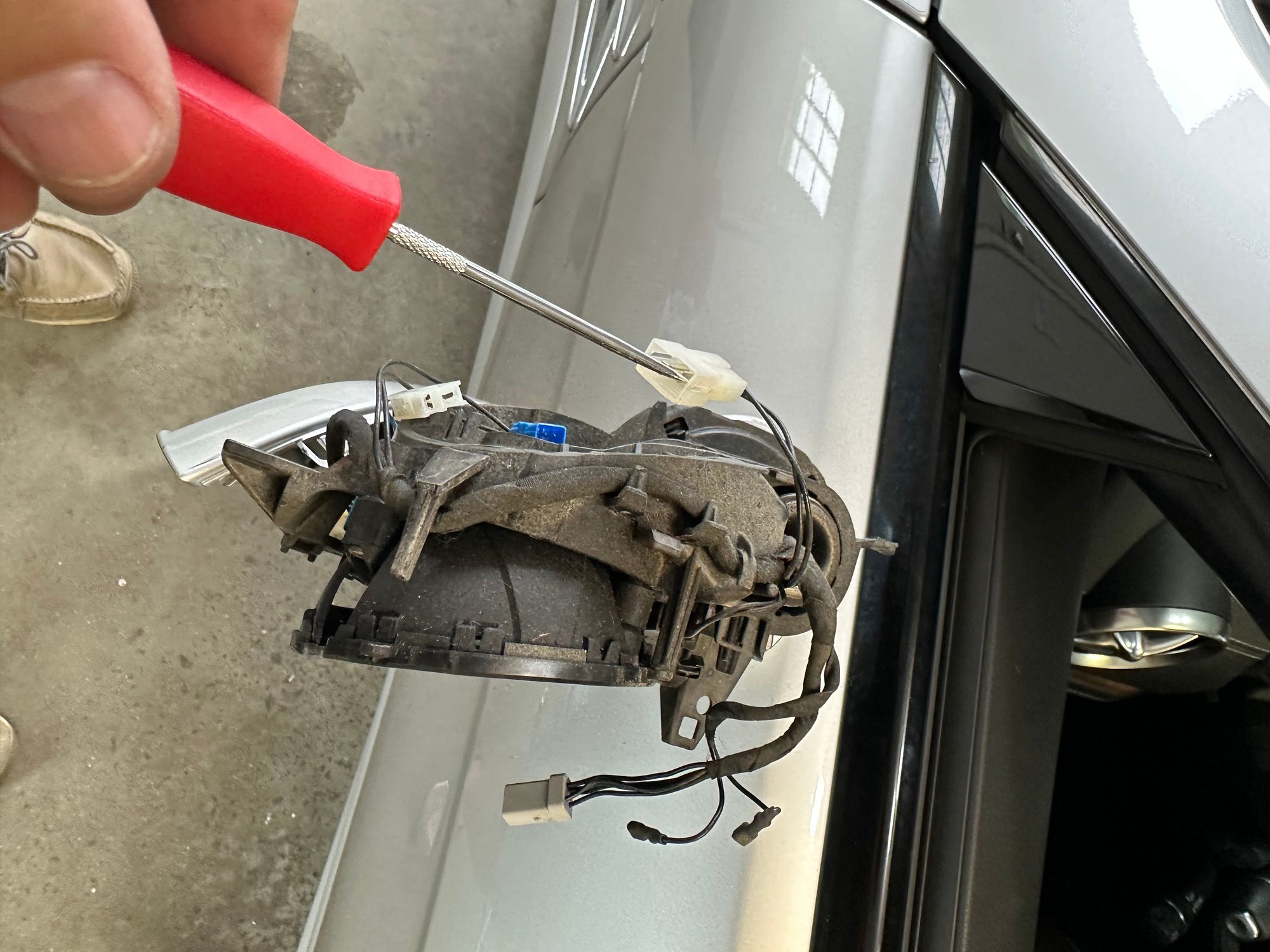

Disconnect the various wires to remove the top cover. I used a little pick for some of the clips, others just pulled apart.

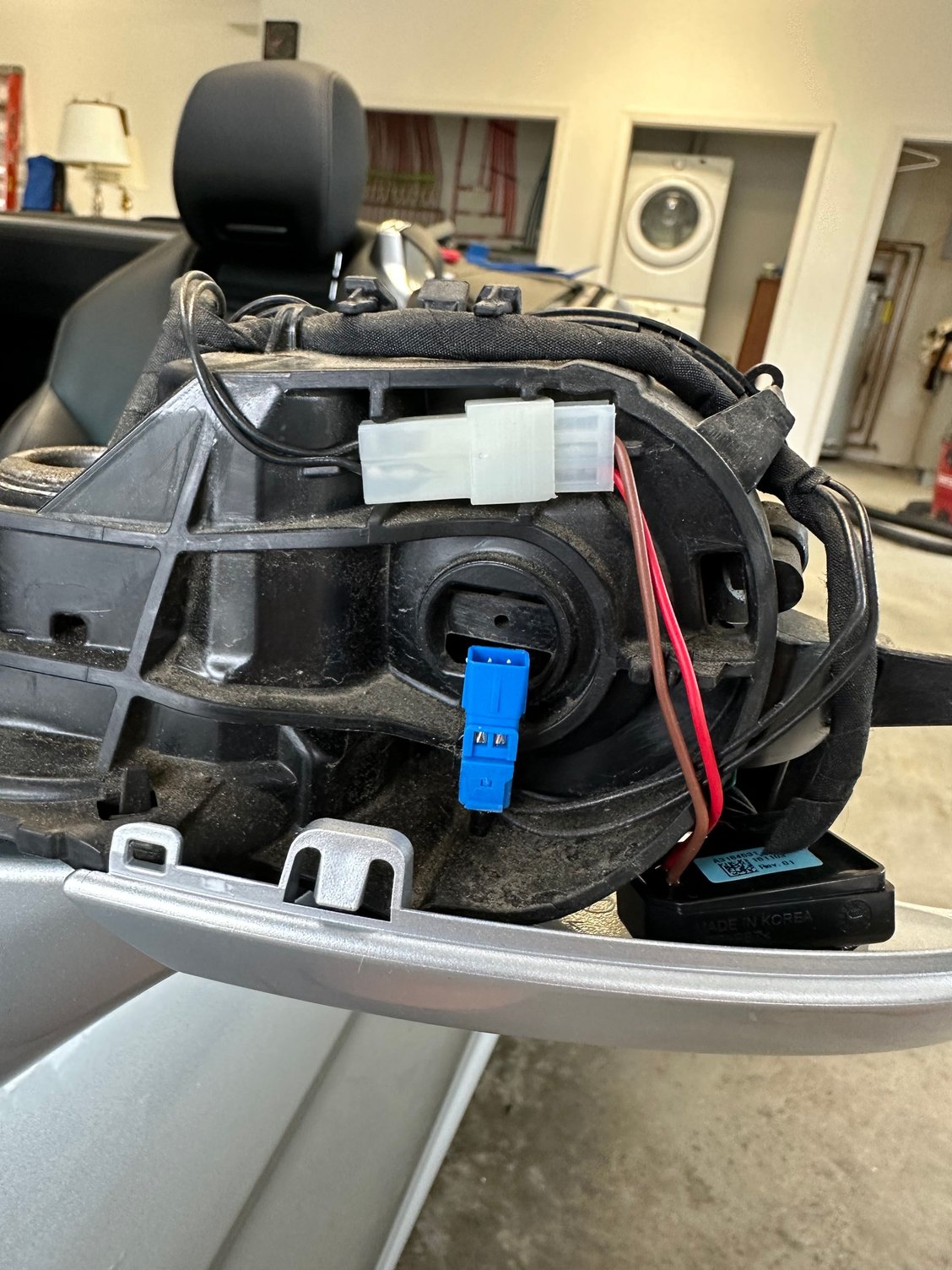

Next disconnect the actual puddle lamp and cover most of the plugs only go one way.

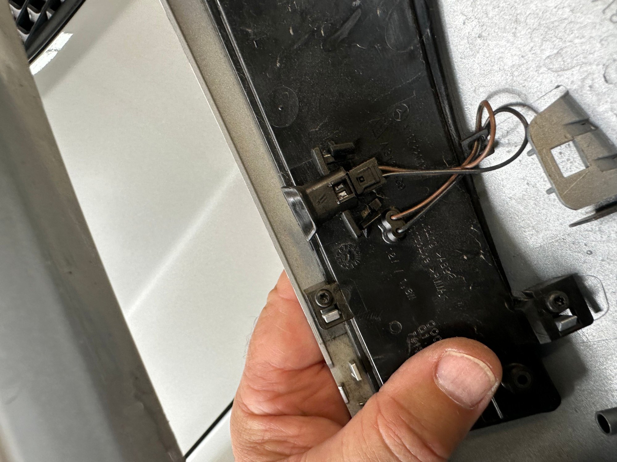

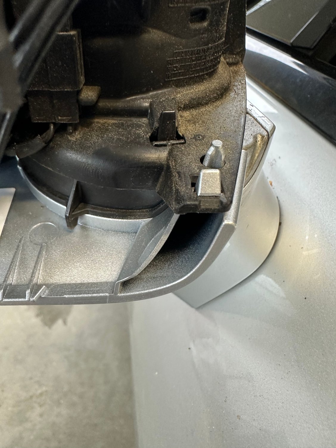

Next step is to put in the new cover. Notice the line up pin. Go in at a slightly upward angle , line up the pin and click it into place.

Make up all the electrical connections except the glass. Install the two torx screws at the bottom.

The last step is to replace the mirror, it snaps in easily with two thumbs where my fingers are. Press firmly and double check . Check all mirror functions and you are done
