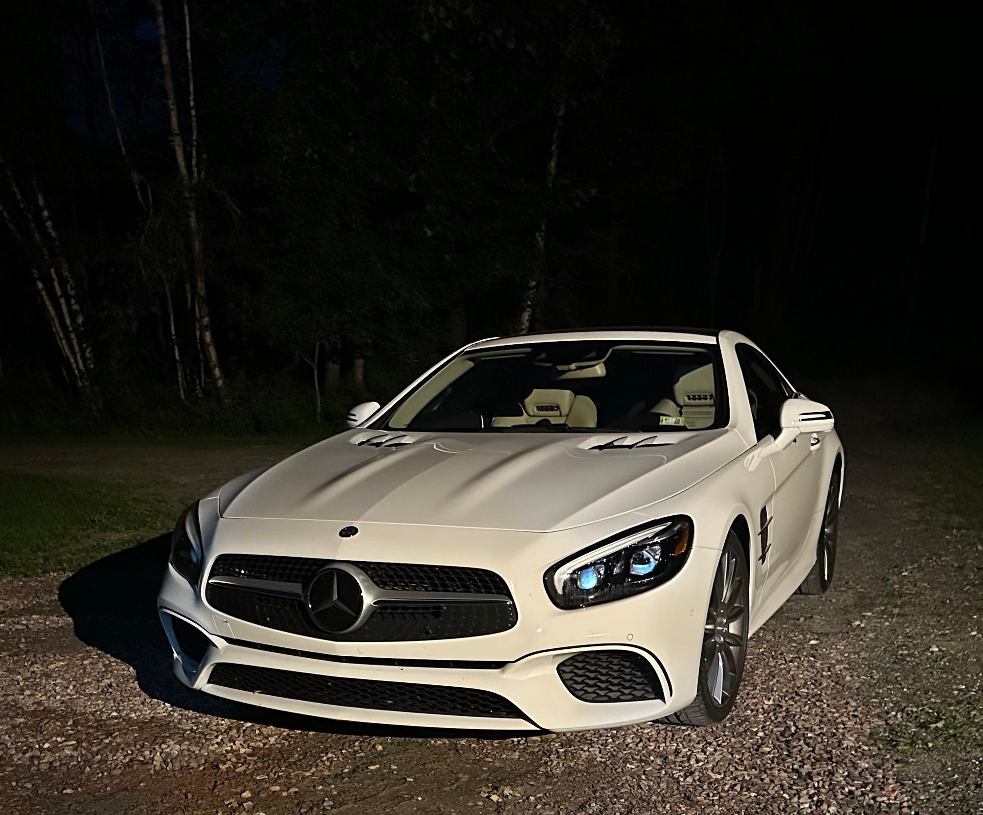

I am glad to hear you guys say quality is normally good... I bought a 2017 SL450 yesterday. My First Benz. It looks like no one ever touched it other than a spot on the seat where you push to help yourself get out has a TINY bit of discoloration. 40k miles. carafe looks like this thing was beloved and detailed all the time at the dealer. I was so excited I drove it home with my daughter who is too young to drive and went to go get a friend to pick up my SUV from the private sellers house. Half way there (90 min) the ABS, ESC, ESC Off, lights all came on at once... a few minutes later the check engine light came on. It still seemed to run and drive fine, so I decided to try and get to the sellers house where I could get my SUV (I kept a careful eye on temps and drove slow and easy)... But then it started to sprinkle. The Vario roof would not go up. It was stuck open telling me I need to reduce speed. I am in park while doing this. also tried with car off and in Acc mode. Same message. Day one of owning an SL450 was amazing! Day 2 sucked! The seller feels terrible and is paying to have it sent to the dealer on a flatbed. I do trust that these light were not something he had seen before and it was just a coincidence. My guess is there is a speed sensor or something that went bad. I will update.
Here is my question though... I do not have the air suspension or magic roof but otherwise it has everything. Should I be afraid to take this car on long trips (3-7 hours)? Currently I am worried I will be afraid to drive it as it is unreliable in my head. Can someone convince me that it was bad luck and with only 40k miles I really should have a few years of mostly trouble free driving other than maintenance (3-4 k miles per year ).
Apologies for the long first post! I just have such mixed feelings. It is a dream car I bought cash and now fear I made a huge mistake. It is less the financial aspect than the fear of getting stranded.
Thanks!!!

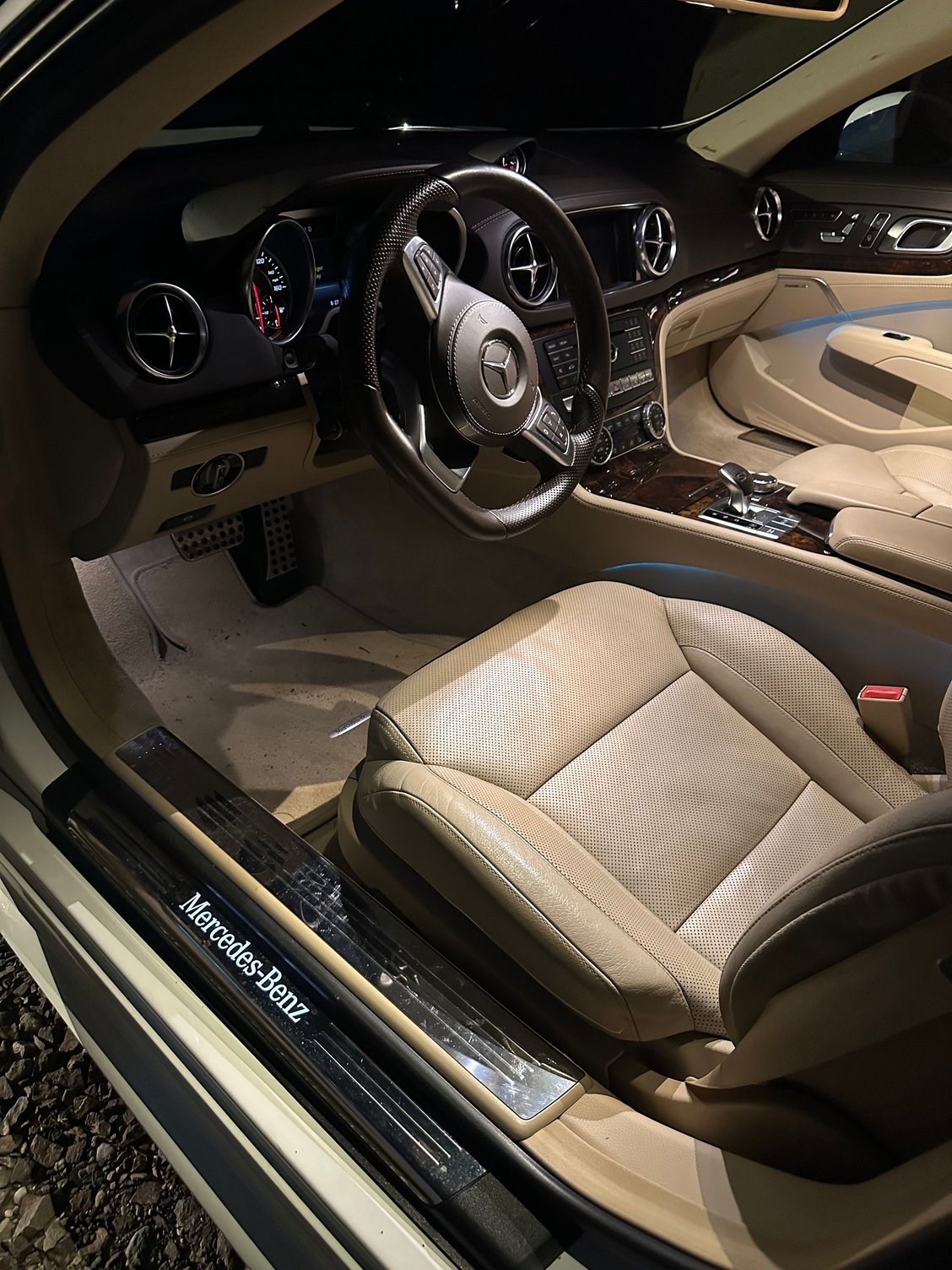

I only had time to take two pictures last night when it was already dark… will take some good ones later. :-)
