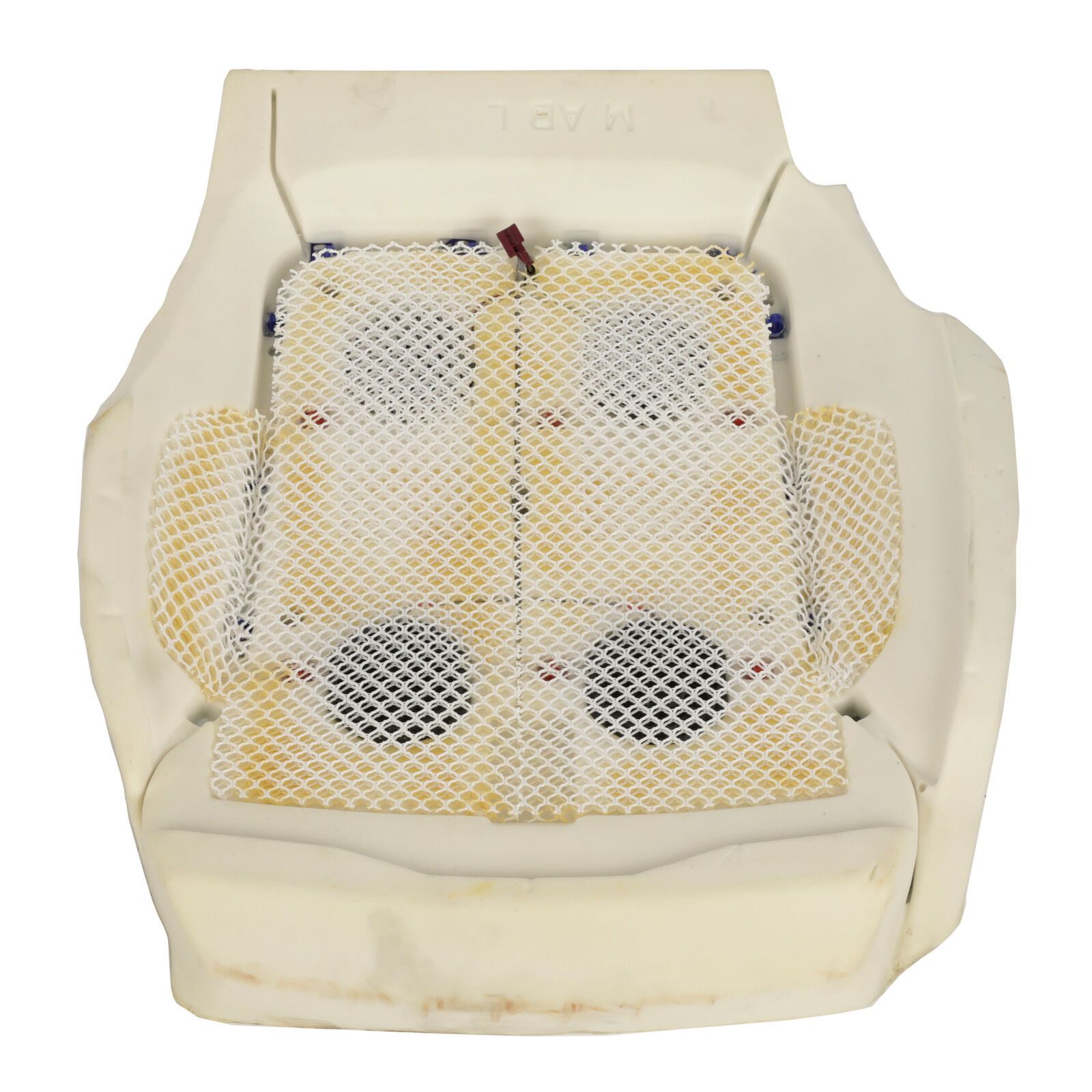

I think the previous owner must have weighed a lot, because my driver's seat cushion is FLAT and has no support. The upright back, and the sides are fine. To compare, I sit in the passenger seat, and it feels fine.
So, my question is: Can the driver's and passenger's seats be swapped? They look to be the same in my 2015 SL400.
Alternately, has anyone added cushioning or modified the driver's seat to restore it to original level of support?
In mine, the flat part of the seat near the rear of the seat just has no support; it sinks in with little pressure. The passenger seat does not do this.

I believe the foam (and seat) is not interchangeable, but it is still available from factory MB PN 231-910-35-00. It’s around $350.00.
https://www.mercedespartscenter.com/oem-parts/mercedes-benz-seat-cushion
If you’re going to do the repair, it would be better just to buy the part rather than take two seats apart and still end up with one bad seat.
