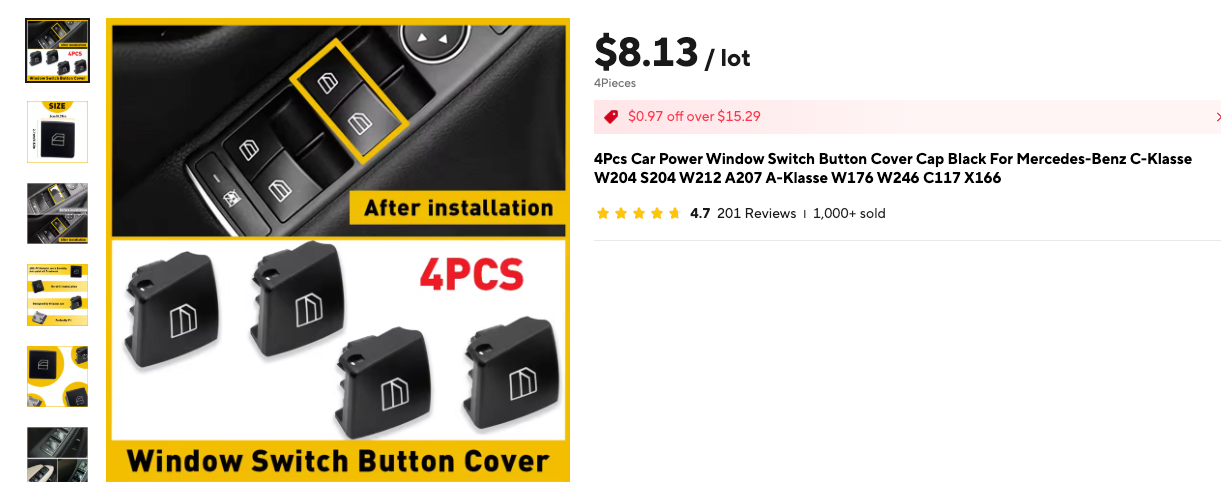

My window buttons started to peel so I replaced them with ones I got off of AliExpress or Temu. I will have to look up where I got them.

I started to have one of my window buttons flake the black off, so I replace the button part with ones I got off of AliExpress. They worked on my 2015 SL400 R231.
https://www.aliexpress.us/item/3256806439513454.html?spm=a2g0o.order_list.order_l  ist_main.4.465e1802zhyuHy&gatewayAdapt=glo2usa
https://www.aliexpress.us/item/32568...yAdapt=glo2usa
