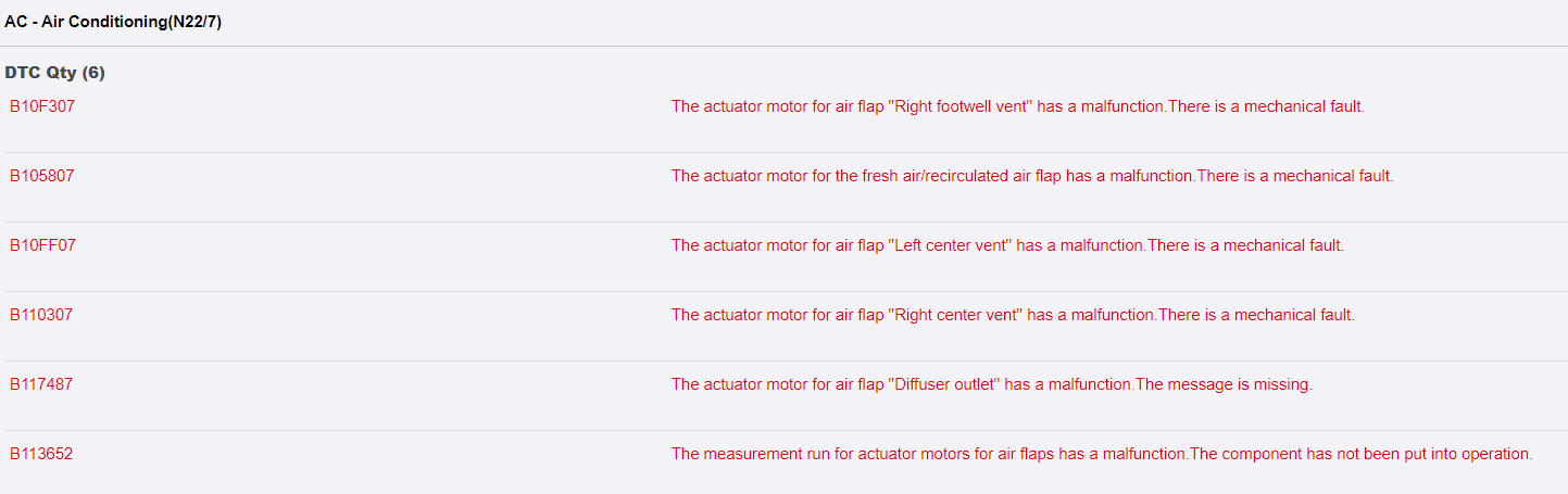

This is what my scanner came up with. Any ideas what to look at first?

Can you do actuation tests with your scanner? That's where I'd go next.
A lot of coincident codes like that suggests that maybe the controller went bad.​​​​​​​
