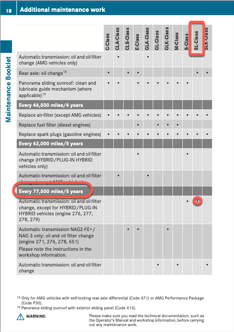

Get the kit from FCP Euro and pay the dealer the labor to do it. Figure about 2 hours labor. There are plenty of youtube vids on how to do it. FCP Euro has a good one. If you have a lift, then it will be much easier. But since you are asking how to do it, take it to a mechanic that has the skills, knowledge, tools, and ability to do it. As @rmorin49 said, you only do this every 7 years (or 60,000 miles). Should be about $700 to have the dealer do the whole thing with their parts.

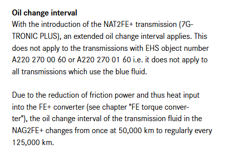

If you have a 2014, you almost certainly have the newer 7G+ tranny that uses the ATF-134FE fluid with the longer service period (77,500 miles/5 years). While the mechanic may be right, it is contrary to anything Mercedes has published. (Also, he should have corrected you with regard to the mileage and time intervals. That would make me question what else he is wrong about.) The transmission service should not cost $1000; more like $600-$700. You can do whatever you want, but I personally will keep to the schedule. Fluids are probably the most critical maintenance service you can have done.

I have a 2015 and decided to have mine changed at 35,000 miles and and 7 years. They also replaced all the pan bolts, gasket and filter. Cost was around $800.

I go by a 5 year or 25-30K mile transmission service interval on all of my vehicles.
Every automotive fluid deteriorates over time, especially fluid in service and exposed to contamination from normal use / doing its job.
Pentosin, who manufactures the fluid for MB, puts a 5 year shelf life on new fluid in sealed containers.
As a general practice, I consider the recommendations of the component / fluid manufacturer first, followed by the automotive manufacturer.
