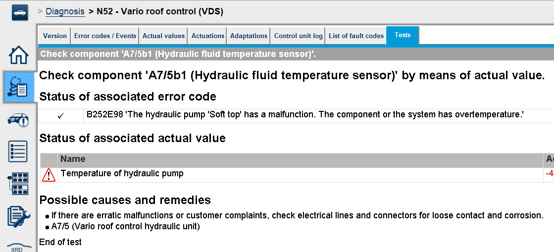

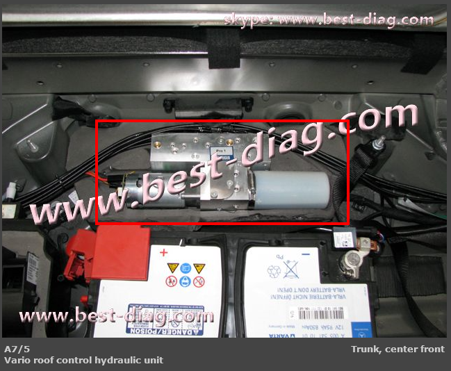

I intermittently get DTC B252E98 under the control module VDS - Vario Roof control (N52). The pump is located next to the battery in the trunk. XENTRY (simulation) says to check for loose or corroded wires. I will try that once it warms up outside a bit. It is 17°F at the moment. 🥶

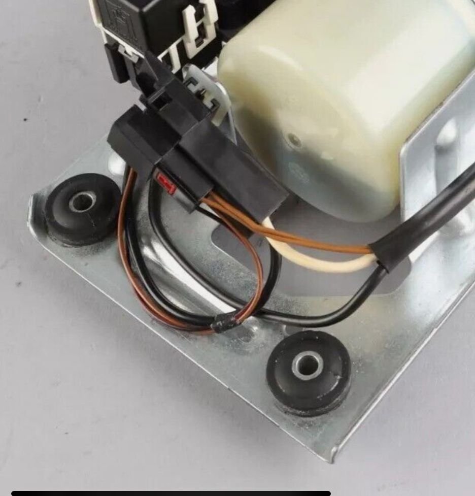

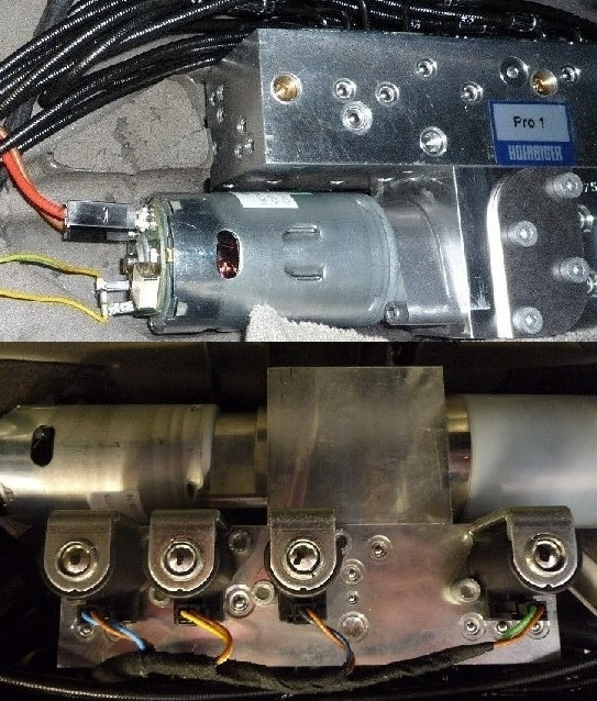

Can’t really tell from the pics but connections to the pump motor look a little oxidized. May be worth cleaning them with electronic cleaner and small wire brush…
Thought there was a “plug” (connector) for those connections to the pump motor, I’ll check mine when I can to compare.
Good Luck

No connector on mine.
You have some parts options if you need the motor or wiring.
Wiring harness
and wiring
Pump Motor
I was thinking of the pump connection on the R230, with the connector for comparison below

Thanks, but those pics are from Starfinder and actually XENTRY. Not my car. Haven't been outside yet. Too fricken cold!

Those motors do fail. If the wiring looks good at least the motor is available separately at a reasonable price.

Actually, I've not had any problems with the roof opening or closing, it's just that this code pops up intermittently when I do a full scan of the car. I will say that I first detected it last summer but dismissed it as one of those flukey things our cars do.

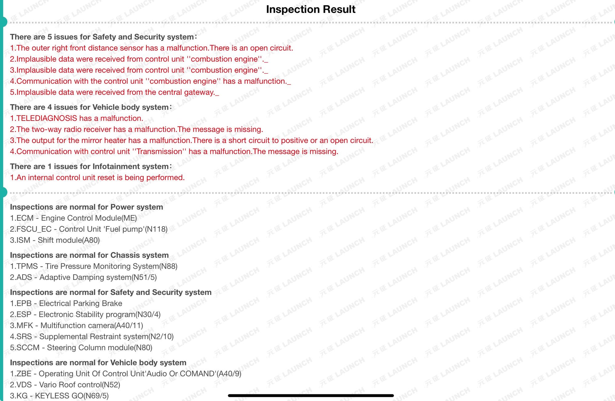

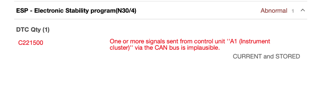

Are you getting the error in both XENTRY and LAUNCH Creader?
on aside note, I purchased one ( LAUNCH) to try out and compare to XENTRY.
As you have suggested, It’s pretty decent and a good alternative for folks here who don’t want the setup complexity of XENTRY.
Also looks like some versions of XENTRY may be missing some vital portions of the diagnostic functionality.

I was using LAUNCH and cleared the code. It was stored, not current. Next time I will wait and scan it with XENTRY if it shows up. Very good observation because sometimes aftermarket scanners pick up codes that are ignored by XENTRY. On my C-Class, there is a persistent code associated with traction control (ESP) that is ignored by XENTRY.
Also, I went and checked my electrical connections to the pump motor and they look brand new, much better than the picture above from XENTRY.

That is interesting, I'm thinking it's the other way around. The LAUNCH Creader is generating false codes. But will scan cars with both, to try to see if I can duplicate on my end.
Also, I suspect different XENTRY installation's may be missing some functionality depending on how they were installed

Interesting, I think @S-Prihadi and others touched on the subject that different aftermarket scanners may be generating or picking up different codes.
I scanned my car with the LAUNCH, which scans clean in XENTRY. It is Generating a bunch of codes which have never shown up in XENTRY.
So the question is does XENTRY have a “tolerance” of which codes it is generating, as some of the other scanners may be too sensitive, therefore not reporting on false codes, or is it just missing these errors? I believe XENTRY is accurate, but it may also depend on individual installations…
I have a legit parking sensor and drivers door mirror heater code, but the rest are unrecognized.

So, @JettaRed, if you haven’t figured it out yet, CREADER is reading “ghost codes”
Codes that were triggered on previous repairs, and cleared with XENTRY.
But for some reason LAUNCH CREADER is still recording these codes.
Your overheating pump code was from when you had a leak in your trunk/vario roof hydraulic system as that would have caused the pump to overheat and trigger the code you currently see.
Also, I am unable to clear these ghost codes with CREADER. They continue to come back.
I checked several cars I know the repair history on and confirmed these results.
I guess this tool is great if you want to see your cars repair history, but I would be careful using this tool to diagnose any REAL issues pertaining to repairs. It would be difficult to determine if they are ghost codes or real.
All the codes above on my car were also from previous repairs, except for the current parking sensor and mirror which it did show.
I would also be careful on how this tool writes code back to your car thu any mods it may do.
Good Luck!

At this point, this is my working theory on the codes generated by Creader Elite but am open to suggestions. I could be wrong, but this is what is happening to the cars I scanned and know the repair history on. Sounds pretty cold right now over there and those gas struts always have issues in cold temps, so the extra force could be generating the B252E98 code.
I was hoping this would finally be a good alternative to the setup complexity of XENTRY. Especially for the owner's who simply want to check their cars. Bummer....
I will reach out to LAUNCH if this behavior is consistent and not just user error, see what they say.
If you know your cars history and progressively archive new codes as they appear, or if you want to see the cars repair history, It may be of value. But as a diagnostic tool to an unfamiliar car, it could be troublesome.
When comparing software/hardware. its important to note software revisions along with hardware.
FYI: Using CREADER ELITE LAUNCH 2.0 - Mercedes Diagnostic Software 50.36
