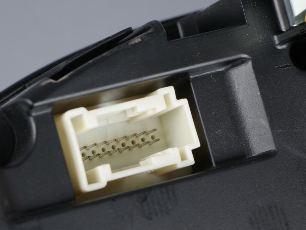

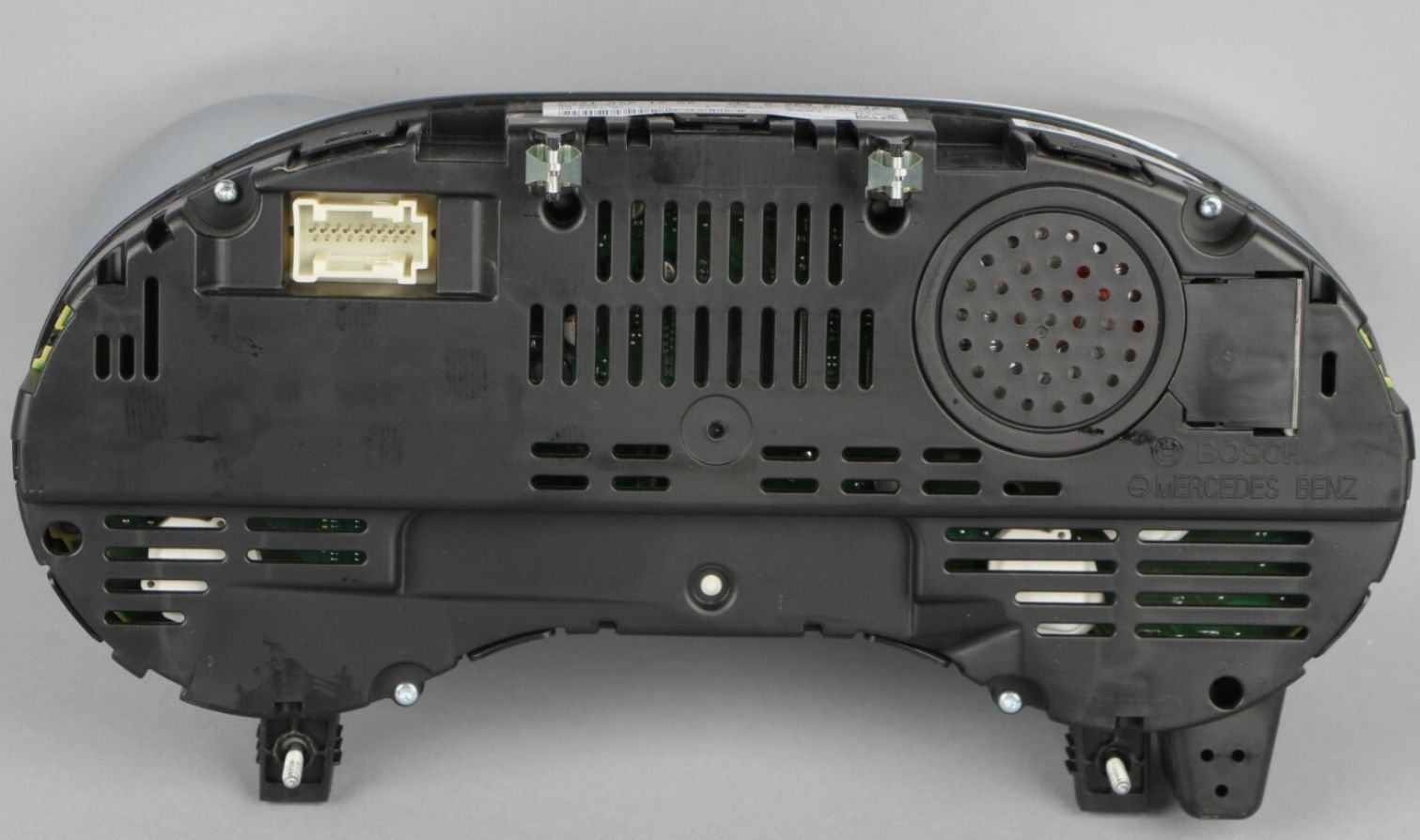

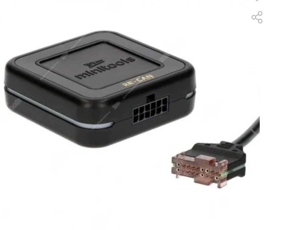

In case you need to bench test the instrument cluster,
Here’s a can bus signal generator for MB IC’s in link below:
https://store.minitools.com/en/can-b...k5RiJ3T1Eg3TXr
Good Luck!
Good Luck!
Thanks for that link! Have you used one of those? Do you know if it tests both CAN bus connections?

I’ve used the older version Mini Tools used to sell (SEP-AD002). The old one powered the Instrument Cluster thru the rear connector, looks like the new version functions the same way ( See Below). Electronics isn’t my strong suit, and as they say, I know just enough to be dangerous, So this was easier than jumping individual wires to power the clusters for that particular job.
If you search YouTube you’ll find guys hooking up MB Instrument Clusters to video games! So there are other ways to test….
In your case, it’s probably something connected to the IC causing your issue. But as you very well know, at some point, you may need to isolate the individual components and test them separately.
There are other CAN BUS signal generators, but they are upwards of $4k They are very flexible and use a PC to configure….
Good Luck!
