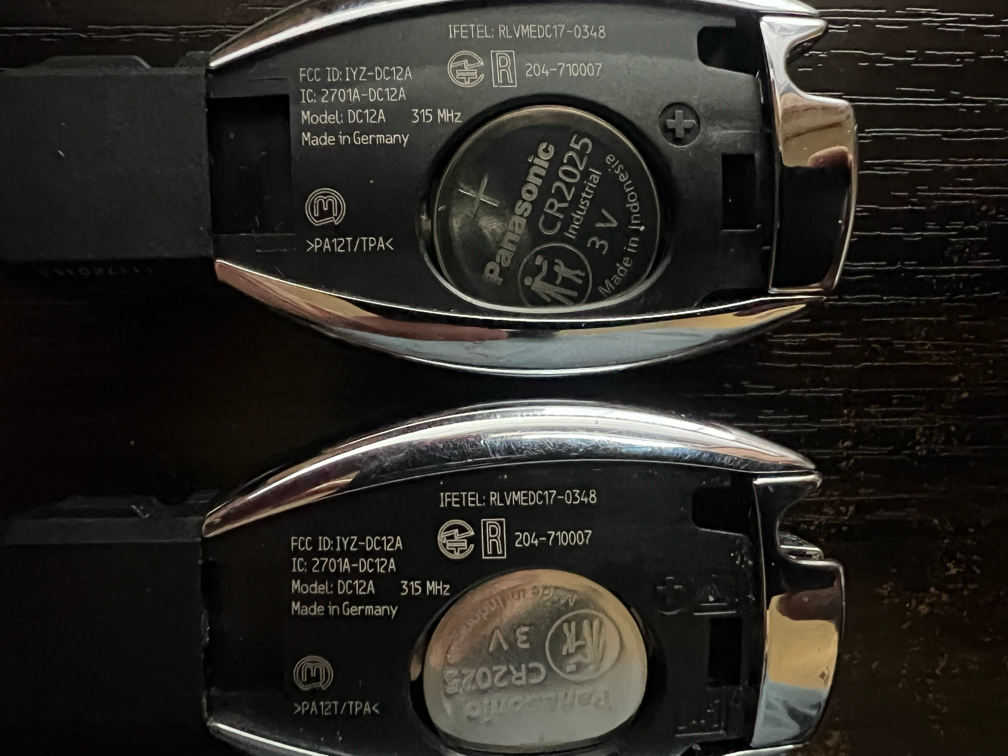

Please differentiate between a key and a fob. The key is the metal blank, and those must be ordered from Mercedes and shipped to the dealer; the dealer apparently cannot cut them. They are cut based on the VIN. A good locksmith with a laser key cutter can make a copy -- I have one. It also does not need to be purchased with the fob, at all. When I had a spare made, the "emergency" key (metal) was $99 from the dealer. The locksmith cut one for me for $40. The blank was less than $1. Bottom line, you can get an emergency key within a day or two if you need one from the dealer.
The fob may be a different story. The dealership can clone/program a fob to work with your car (or at least they should be able to -- they did mine, but I had to buy the fob from them). My dealer keeps "virgin" fobs in stock. I really don't know if they can't or won't program a virgin genuine key purchased online, but they claimed they were unable to program it. Again, what does "unable" mean? Not physically possible, or policy prohibits it? I figured it wasn't worth arguing -- I wasn't going to win. I have added AirTags to all my keys.
Here is a picture below of a virgin key fob that I just received from NorthCoastKeyless and my existing key fob that has been programmed to my car. Can you tell which is which? (Hint: Only one unlocks my car.). My understanding is that model year 2014 and earlier (FBS3?) can be programmed by a locksmith, but the new FBS4 protocol cannot. (By the way, my key fob from the dealer was $650 programmed to my car. I brought my own metal emergency key already cut by a local locksmith.)
