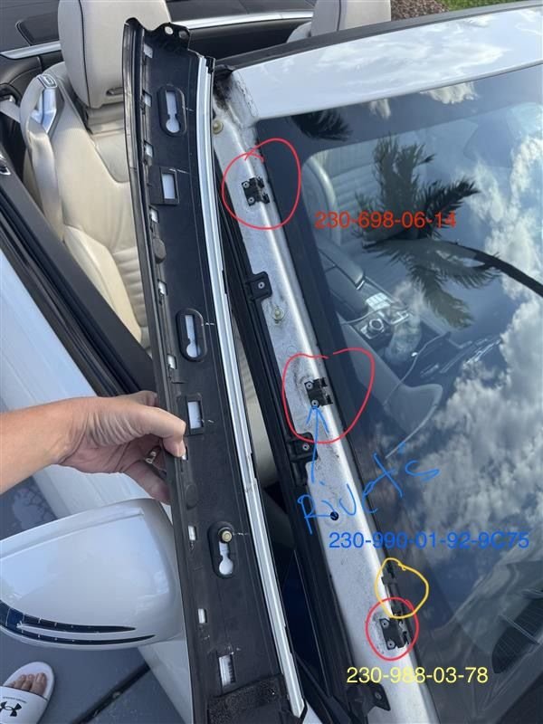

Finally got to take this apart. Looks like I'm missing 2 clips, have 2 broken snap fasteners and a missing plastic push rivet. So when getting the parts and adding them back does it still just go straight back in? No sliding down or anything? I slide the snap fasteners up in the trim piece, put the clips in place, then basically push it in place or do I put the parts in place and slide it down the pillar? Also from the above pic from @crconsulting I think I need parts 160, 210, 190, 180? What is part 200?

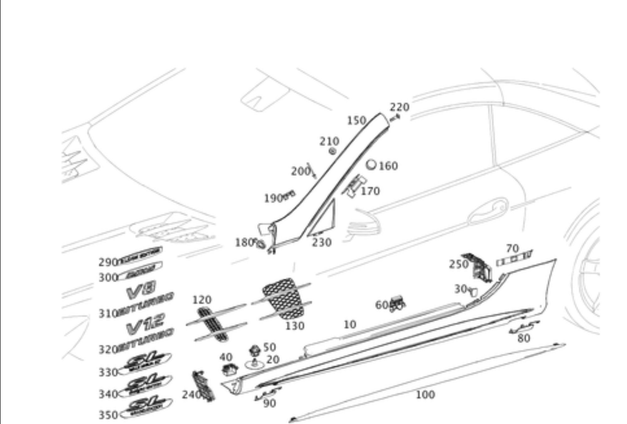

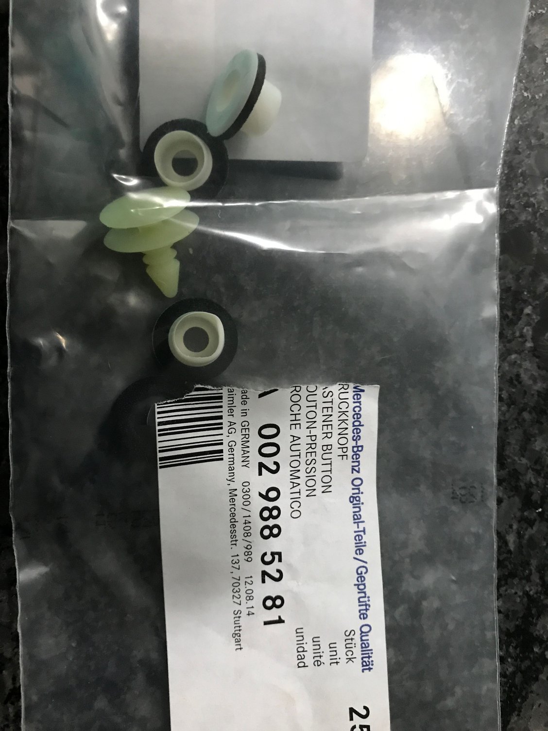

Looks like you need part 160 and 210 for sure. Those look like the parts THORGOD ordered: 002 988 52 81. (above)
180 is the plastic rivet under hood. If you didn’t have to remove it, it’s probably missing.
170 and 200 are on your car already and appear intact (the black “u” clips riveted in place)
Once you get all the parts, yes, the A pillar just pushes straight down. Be sure you align the clips with the holes before you push down.
Then the plastic rivet, followed by the two torx bolts at top of A pillar.
Easy peazy….
Good Luck
190 and 200 are on your car already and appear intact (the black “u” clips riveted in place)
If you look at the bottom clip there is 1 part of the clip that looks like it goes into the clip thats riveted in place. Unless I'm missing something. There was only 1 of those and there should be 3. I thought that was part 190?
You are correct, 170 is the metal clip and 190 is the plastic one near the windshield.
I can’t remember how many of those plastic clips the r231 has (there may only be one). Do you see holes for the rivets?
see pic with PN’s, may help

@crconsulting very helpful! OK the rivets are all there. I need the clip circled in yellow 230-988-03-78 and the plastic rivet under the hood (not sure which is the part number for this - 230-990-01-92-9C75?). As well as the plastic parts of course.

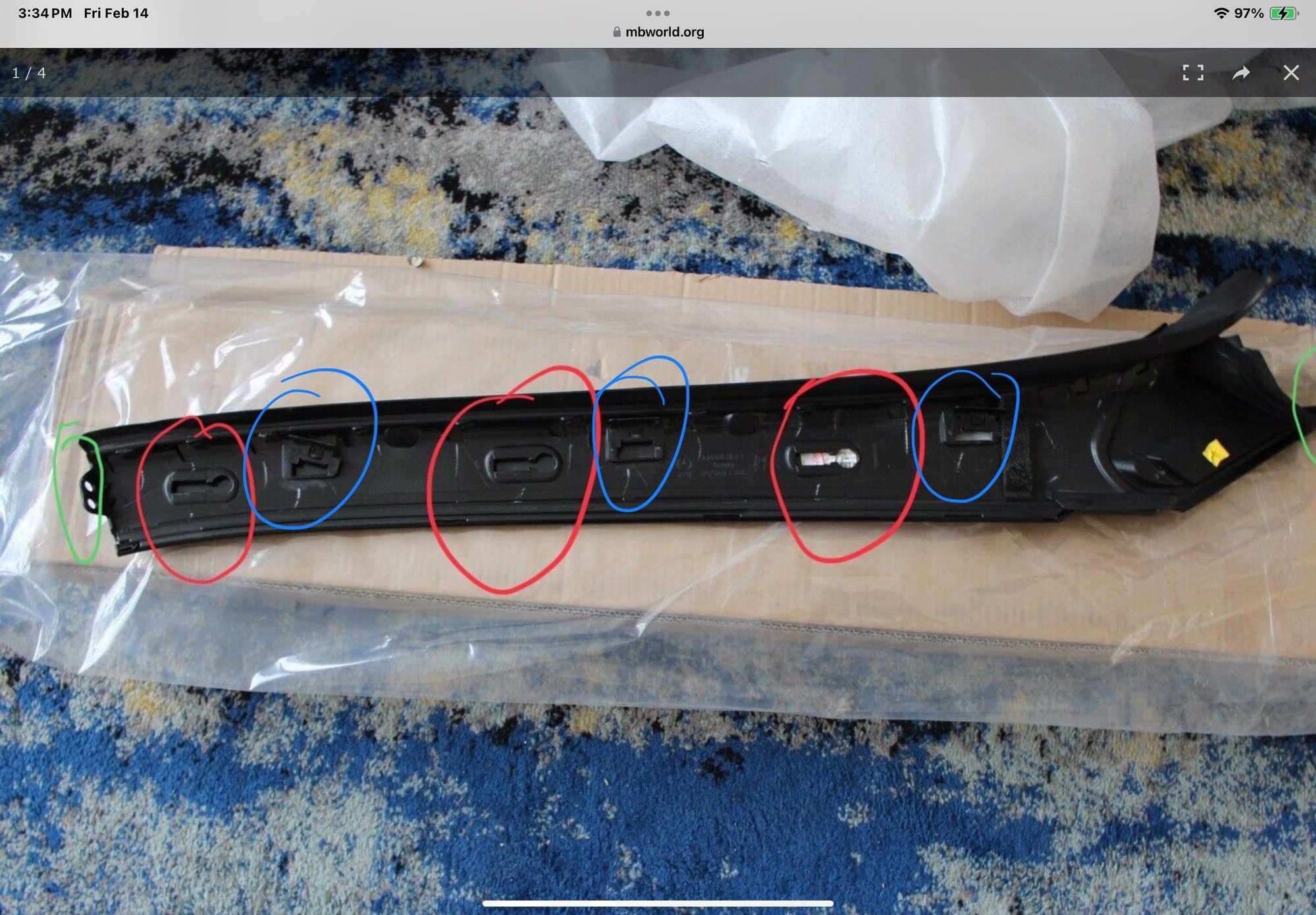

Also looking at your A pillar, you appear to be missing the mating “male” clip for the three metal clips riveted on. (Those could be part 17 PN: 230-988-03-78, hard to tell)
I have ordered whole A pillars and they came with all the clips and have ordered some and they came with NO clips
look at this A pillar below compared to yours.
see the mating clips for 230-698-06-14 circled in blue?

Oh I thought thats what 230-988-03-78 was, Thats what you had circled in yellow on my pic. It looked like it should go into the slots on the black plastic pillar part.
it could be, hard to tell from that mb parts image. I don’t have my laptop with EPC with me, but bet the illustration is the same.
It (230-988-03-78 ) could also be the part that I pictured in yellow in YOUR image…
But you’re definitely missing those mating clips (circled in blue) that slide into the slots on the A pillars
I would order them no matter what they’re, cheap and hopefully the right part will show up….

Brawndo,
You'll need:
0029885281-Plastic Female insert/ Qty 3 (210 in the diagram)
2309880025- Plastic Male insert/ Qty 3 (160)
2306980614- Metal piece that clips on to the pillar cover, Qty 3. It's the part that CR circled in yellow and should not be where it is in the picture. (170) It's referred to as a "Holder".
230988078- Metal Clamp riveted to the windshield frame. YOU DON'T NEED THESE. Yours look to be fine.
230-990-01-92-9C75- Is the plastic expansion rivet at the bottom, Qty 1 (Not sure if you need this part)
I just went through my parts and verified the part numbers you need. Should be pretty easy to get all the parts installed and then line everything up and go for it.
Thor

Hey all,
Wanted to add to this after what @crconsulting said. The metal 'bracket' as MB put it, part 230-698-06-14 has been superseded by part# 172-698-00-14. So my parts list, with MB names was:
230-990-01-92-9C75 - Rivet (the plastic part under the hood)
230-988-00-28 - Plug (the white tab that attaches to the pillar trim piece)
002-988-52-81 - Fastener button (this goes into the pillar itself, then the plug goes into that)
172-698-00-14 - Bracket (this is the half of the metal clip that attaches to the pillar trim piece and locks into 230988078 that is riveted to the pillar)
Hope that helps someone.
