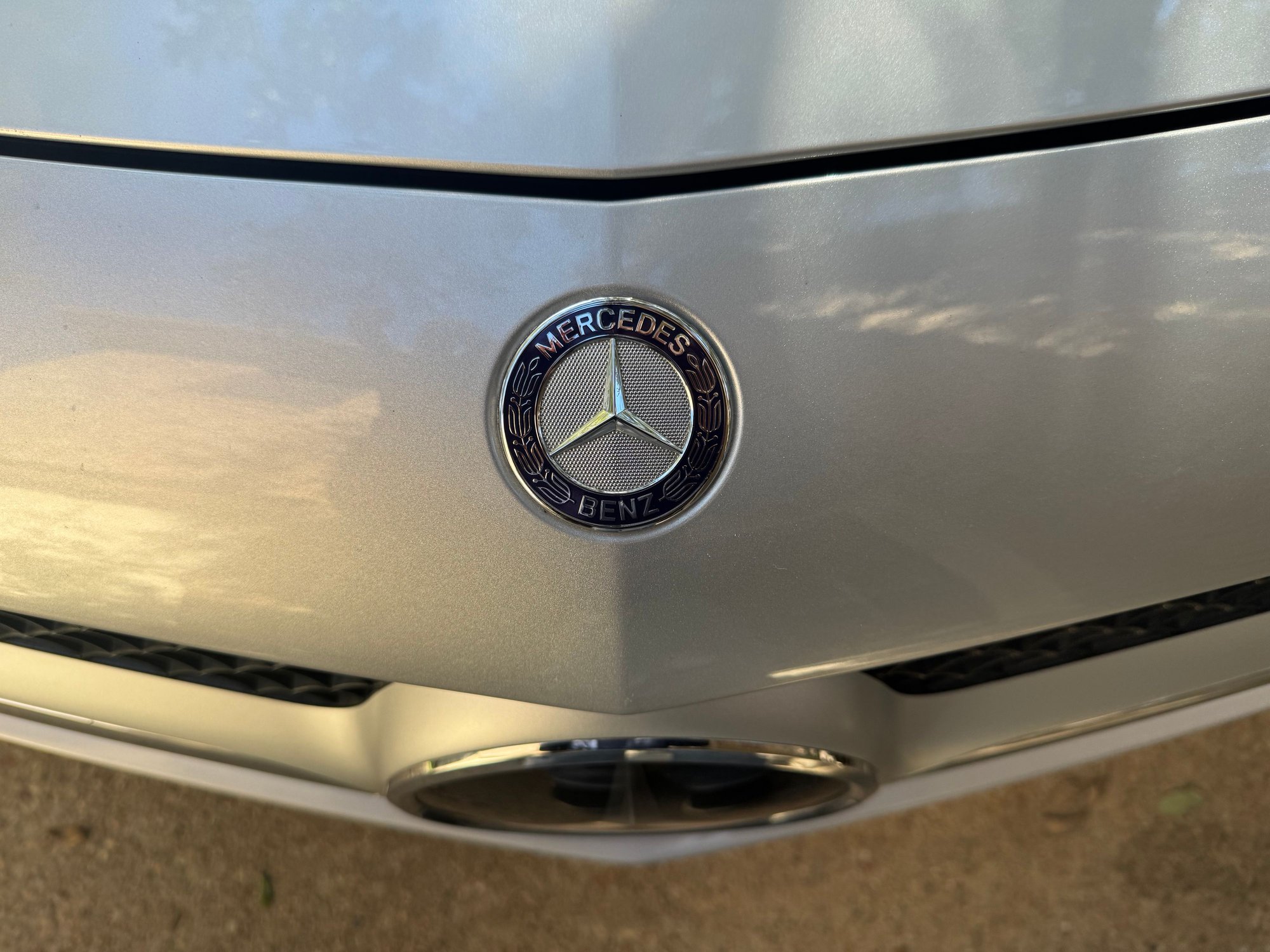

Has anyone managed to replace the Mercedes Badge/Emblem on the top in front of the hood? Mine is blue/silver and I would really like to replace it with the black/silver but don't know how to replace it without taking the front of the car apart. I belive it is just pushed into two gromets and can just be pryed out but I'm not sure and don't want to do anything irreversible.

They can be easy or they can be REALLY on there!
I think some shops must put them on before the paint is dry
I’ve had some luck slightly lifting one end with a small wood or plastic pry bar, and slipping dental floss just to lift it enough to slip fishing line in there. It can be a pain and fishing wire can dig into your paint so be careful. Tape all around the area.
Here’s a thread with some images of how it clips into the bumper, should give you an idea of what’s involved.
https://mbworld.org/forums/sl-class-...31-part-2.html
Good Luck!

Thanks so much. That is exactly what I was looking for. For some reason I wasn’t able. To find through searching what you pointed me directly to. Love this forum and the member.

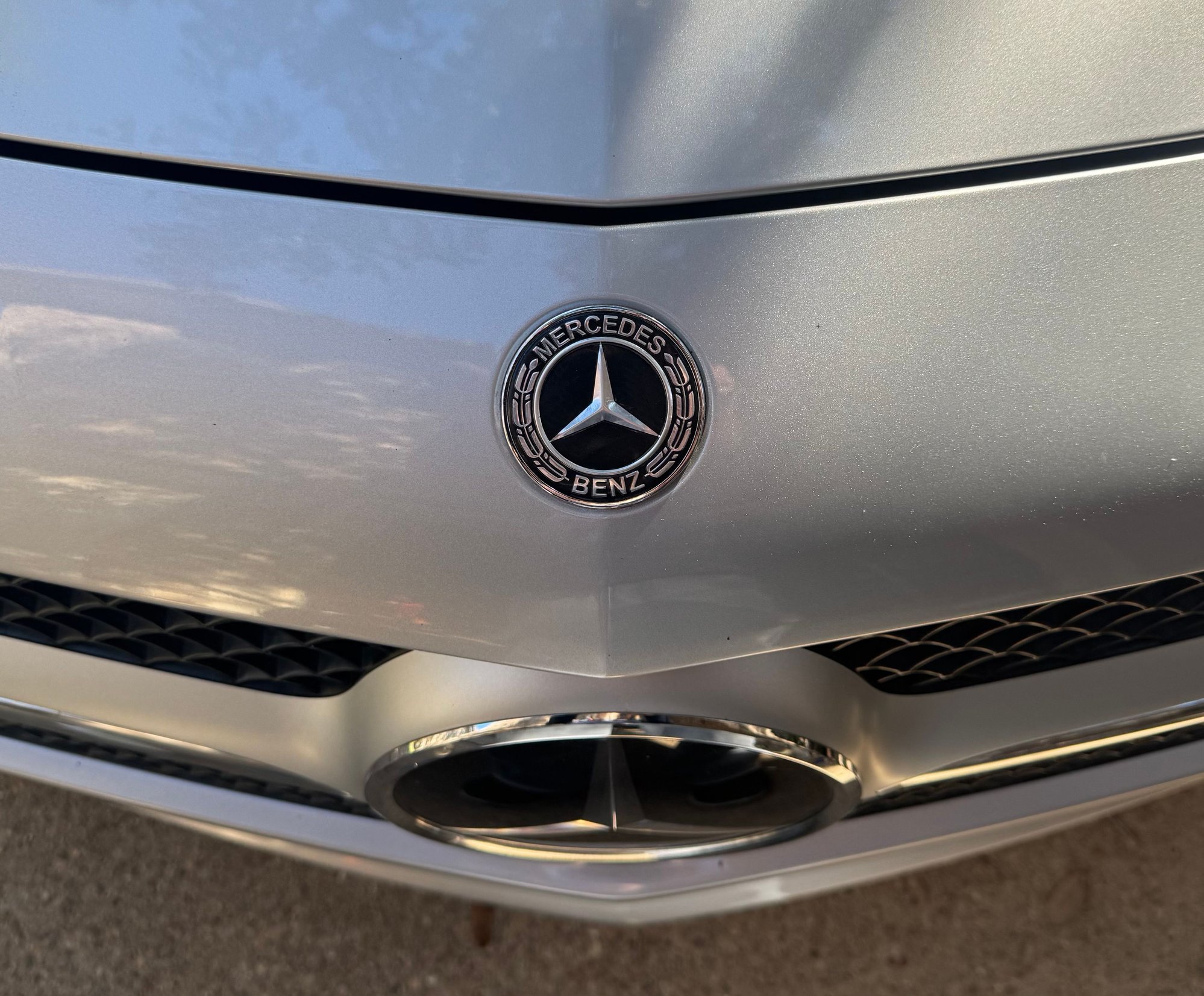

Done.
Original Blue/Silver
New Black

Good Job 👍
Did yours come off pretty easy?

It came off fairly easy. Once you get something underneath you can gradually work it out. Getting the new one on was more of a challenge. The piece your mounting it on flexes which works against the effort to click it in place. I ended up using sandpaper to witless down the posts a bit then used small strips of 3M VHB tape just to add a little more security.
