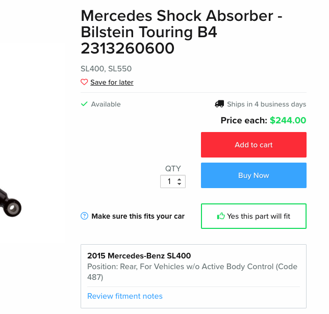

To answer your question, the shocks/struts are Bilstein DampTronic B4. For stiffer suspension, you can go with B6, but I don't think that is what you want. To my knowledge, they install like any conventional strut or shock, the difference being the electrical connection. I don't think you need to program anything.

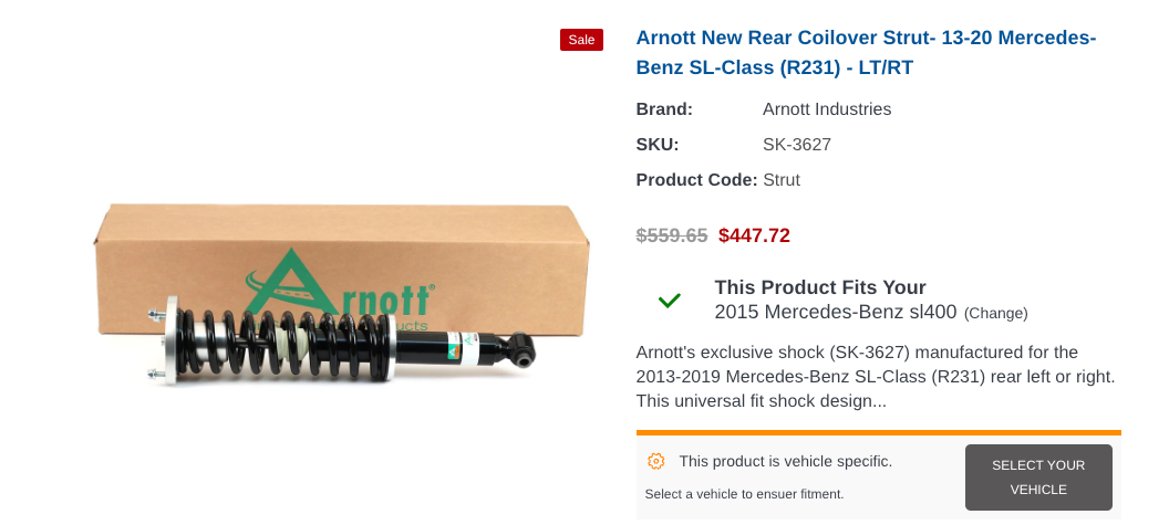

Arnott remanufactured.

Only for dynamic shocks and struts, such as ABC and Airmatic. If you have the Bilstein DampTronic (electric) shocks, stick with that. They are also cheaper than Arnott.

Old Mar 7, 2025 | 01:06 PM
