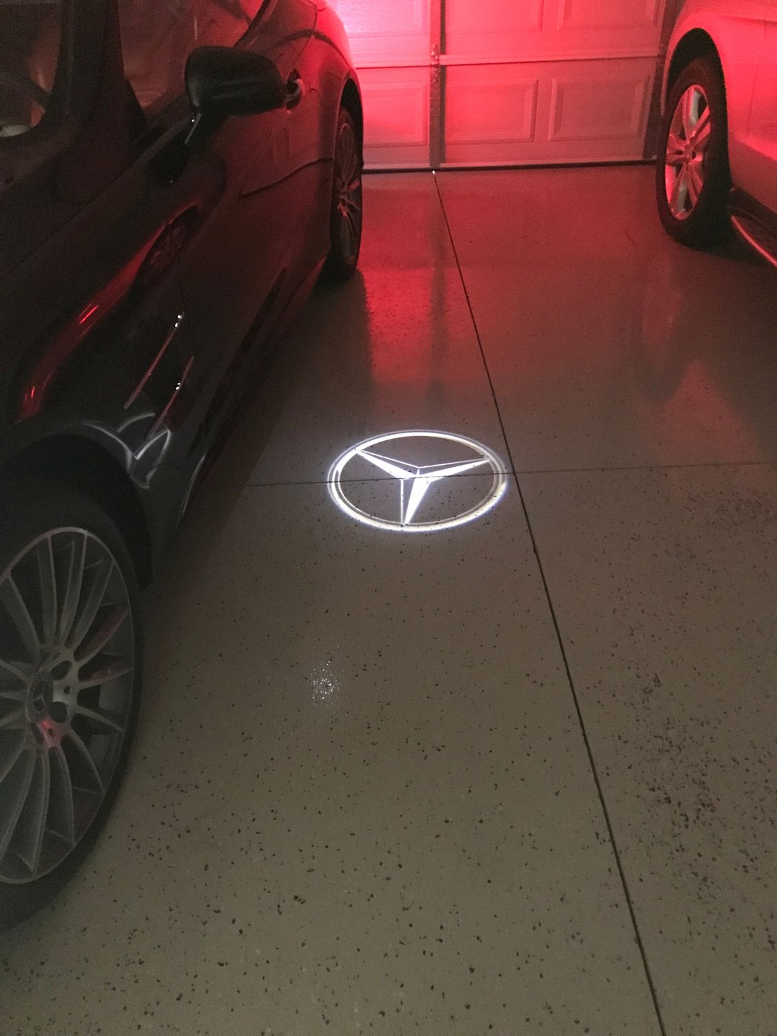

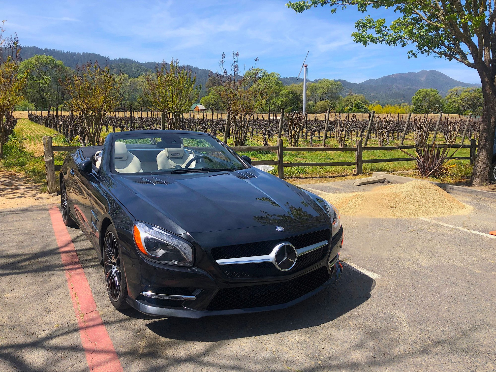

OP should check his VIN
Some 2013’s do have folding mirrors. (see below)
Projector puddle lights are upgradeable too
R231 in Napa Valley
