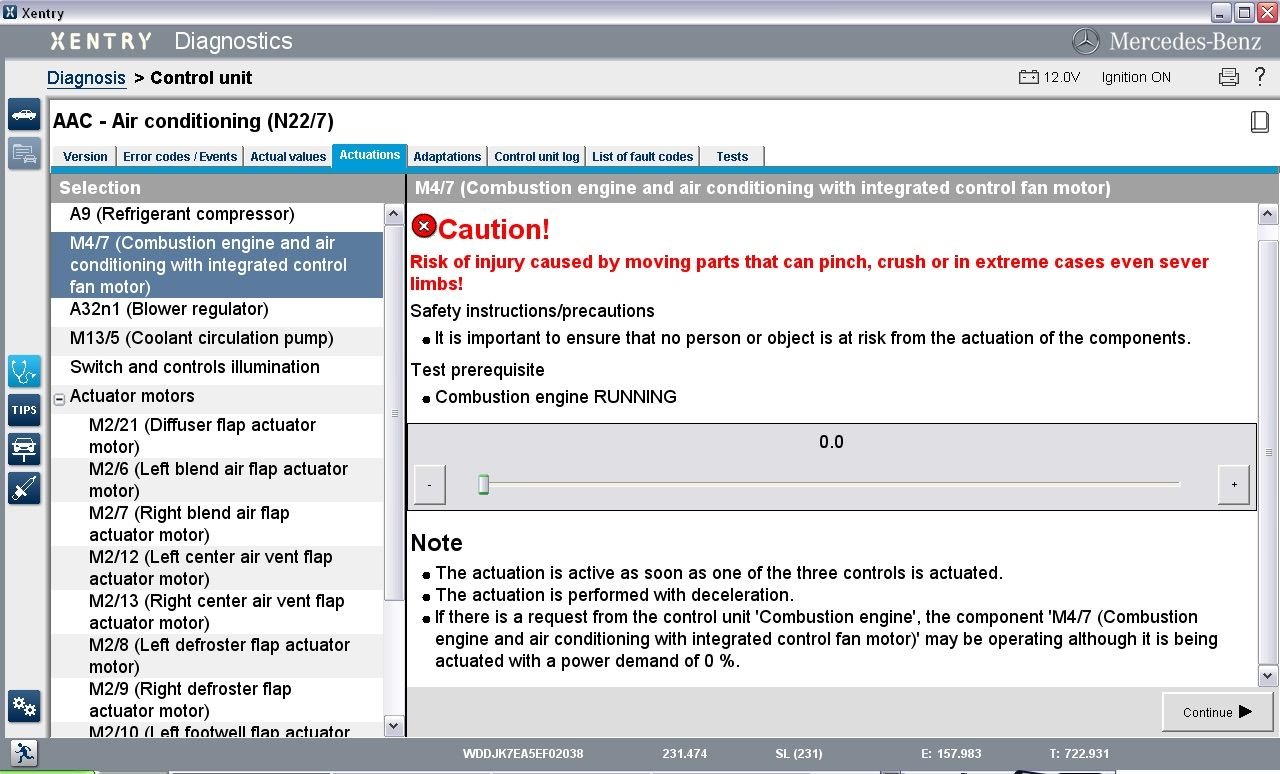

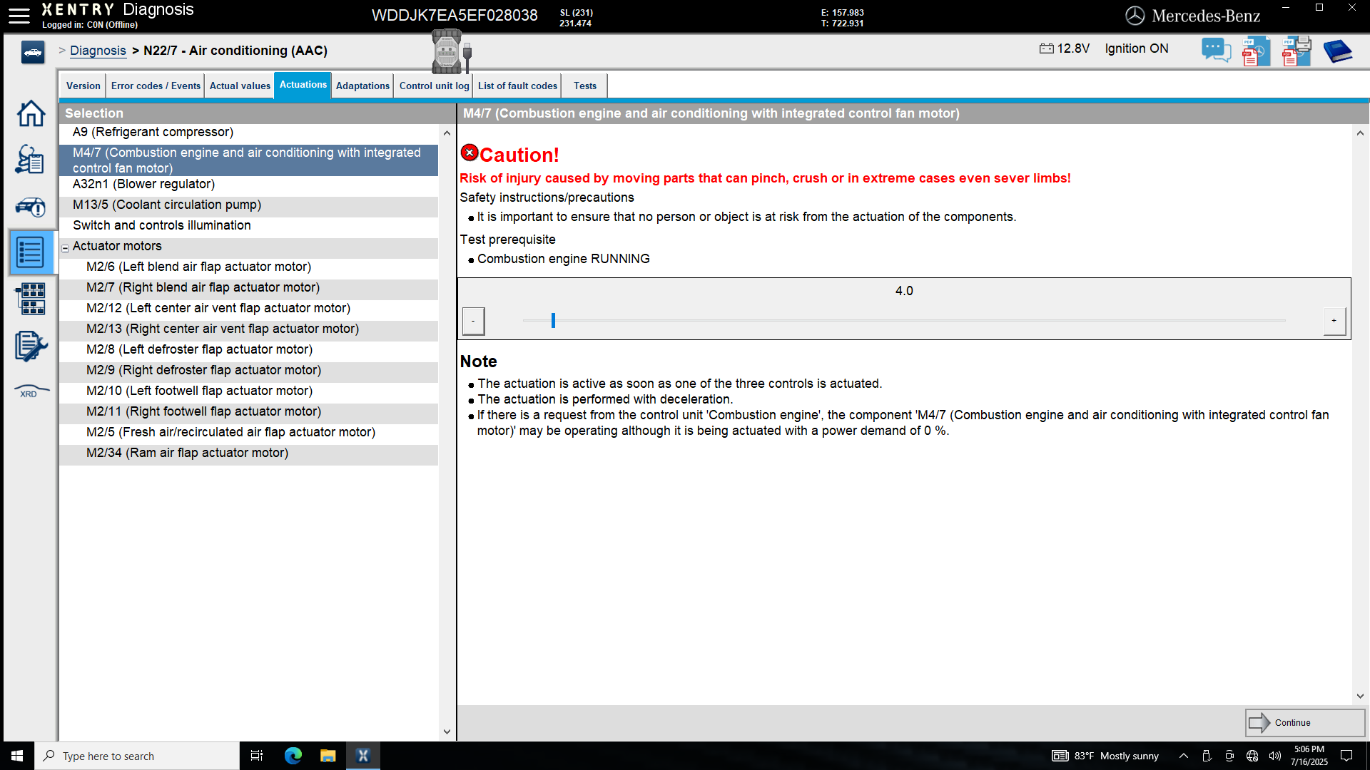

- WIS doesn't even mention breaking-in adaptation. I saw it in Xentry and it said it needs to be carried out when compressor is replaced. While it certainly is mechanical + electrical AND a calibration could sometimes hide the issue to an extent as it is it's job to calibrate to current condition of the whole system so it is capable of "mostl" calibrating within its range and it actually did. A temprorary win rather than constantly slapping the belt and quickly destroying stuff.
- To keep things working in the mean time, I adjusted from Xentry to immmediately turn off A/C compressor when A/C button is pressed. Normally it is delayed to remove moisture in condensator to reduce mold risk and smell. Pressing the OFF button does always turn off compressor immediately but also turns of the fan. You would do hard acceleration for a very short amount time so just temprorily I press the A/C button, fan still on so I don't immediately feel hot in Miami, the belt load is very little and then I turn that back on. I4 and V6 engines have this by default, under WOT their comprrssor are always turned off instead of just when shifting. Xentry says the setting for that doesn't apply to V8s and I tried, yes it doesn't. The setting in xentry tries to prevent smaller engines from stalling.

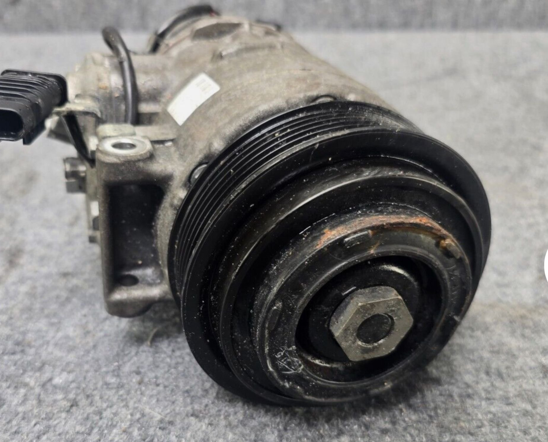

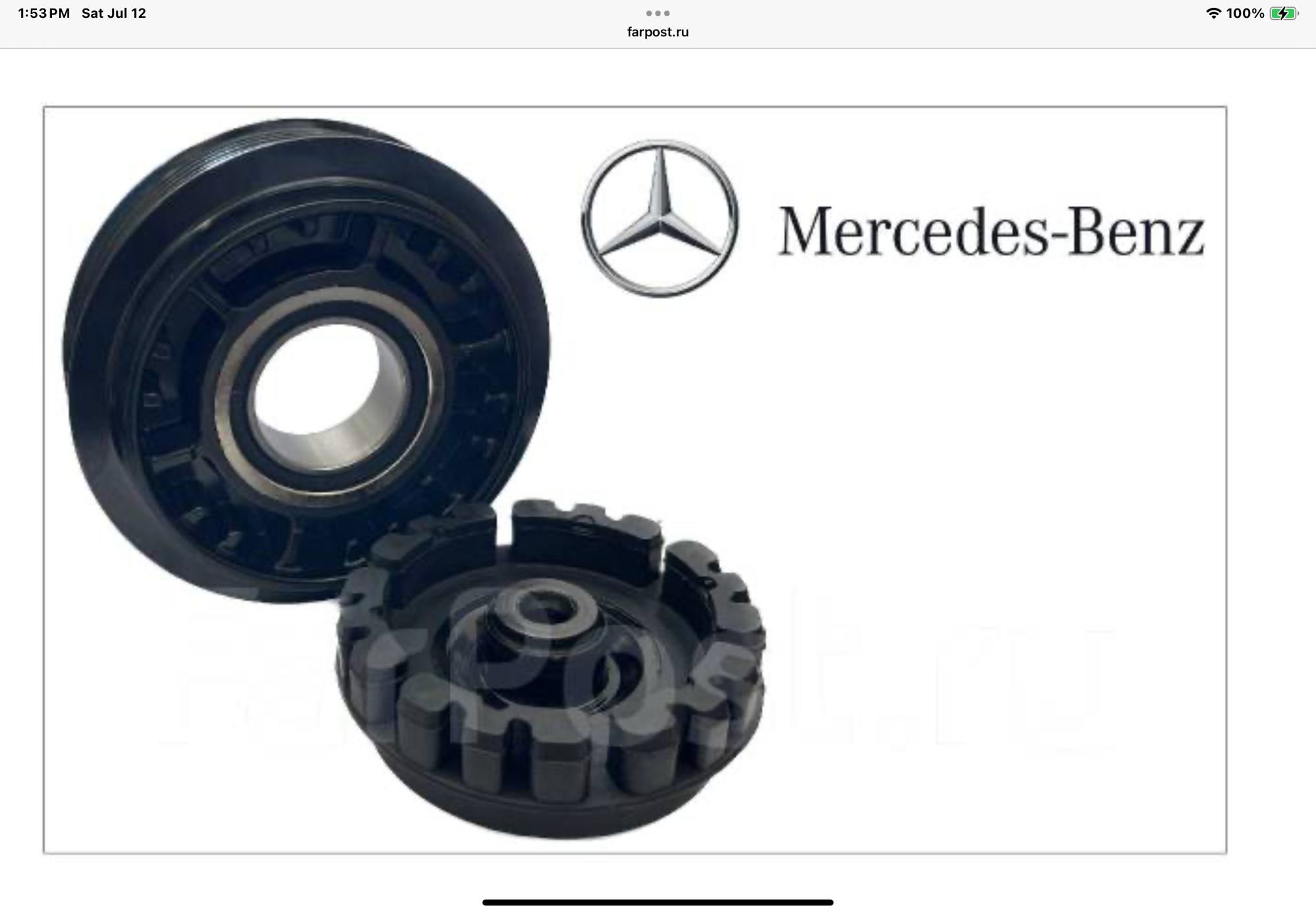

Just to give you an idea. Below is probably what your pulley looks like. You can see it is more dampener more than a “clutch”. The M278- M276 is similar but looks like more forgiving as fas as initial engagement. Closer to a traditional AC compressor clutch.
So getting the right “slip” is extra critical on the AMG cars….

This is your old compressor, no?

- BTW, I did some more testing, as of now, the condition is pretty bad, I tested some manual actuations from Xentry. IMPORTANT INFO COMING: When it was this bad, it actually started chirping (very little) just after 5% commanded which is about 275mA out of 1000mA for the control valve, and goes progressively more towards 100%. We can't say it is the compressor doing this, it is very possible that this happens and the compressor happens to lock as it doesn't have a clutch and not a one-way clutch like the generator, nothing else is this heavy load. NOW THE IMPORTANT INFO:
Xentry has a page in A/C control unit where you can set the compressor load in 1% to 100% manually. It works well. THERE IS ANOTHER PAGE, where it says the engine control units request or something like that. It says THE ACTUATION IS PERFORMED WITH DECELERATION. But it doesn't seem to do anything? Rev downs or upshifts? What I mean is, when I command let's say 3% or some slow actuation to compressor valve from the A9 Refrigerant Compressor page, it directly affects the high-side pressure, compressor load and the chirp as expected. But the second page (screenshot below) doesn't do anything. I though it would apply THAT perfecnt actuation during deceleration. Maybe that's why I have the problem as I believe the car isn't unloading the compressor on time or at all during REVs doing down. The adaptation does affect that btw but if it is not calibrating properly then it is not going to work. BTW the third note in the screenshot basically means, if the engine needs cooling too, the fan may turn on even when A/C requests 0. But the deceleration part is important. I expected this to work when I did set it to 1% and the chirp would be gone temprorarily just like there is no chirp with 1% actuation from the A9 compressor page.
QUESTION: I have access to startek.info by subscription, official mercedes parts catalog, same as what the services see. I see there are other services as well. Is there a service that you can pay to ask the big guys at Mercedes? (not Services or dealers)
elaration
So this is interesting, let’s talk about the version of XENTRY you’re using. Is it the Passthru version? (Never mind, Screenshot shows Passthru) Are you using a C3 (or C4) multiplexer? Which one? Legit copy (obviously legit since you have subscription) which adapter are you using? The passthru version doesn’t have the same functionality. I’ve also found the later versions of XENTRY, say post 2015 (with a C4) are not as reliable on the older MB’s 2010-2014’s.
Also some of the pirated copies of XENTRY can also be unreliable. I had a friend that used a pirated version of XENTRY to run some seat adaptations after a seat motor replacement. He was unable to get the adaptation on the seat to “take”. Even though adaptation seemed to be going thru the motions. Kind of what you’re describing. It’s possible adaptation is being reset, but just isn’t being “written” correctly.
You’re correct about the dealer, these types of issues are a time suck and the dealer techs will be under pressure to “get it out the door”. I don’t believe this is a common issue. So they’ll be starting from square one again.
It’s been a while since I looked at startekinfo, but there were services only available to dealers, This may have changed as they update the site. But MB definitely has always wanted to maintain their service advantage over independents.
Good Luck
(edit). just to confirm we’re seeing the same things, this is what the actuation screen looks like on my older version of XENTRY running your VIN. Fairly similar. Also assuming you ran pertinent tests located in the testing tab?
