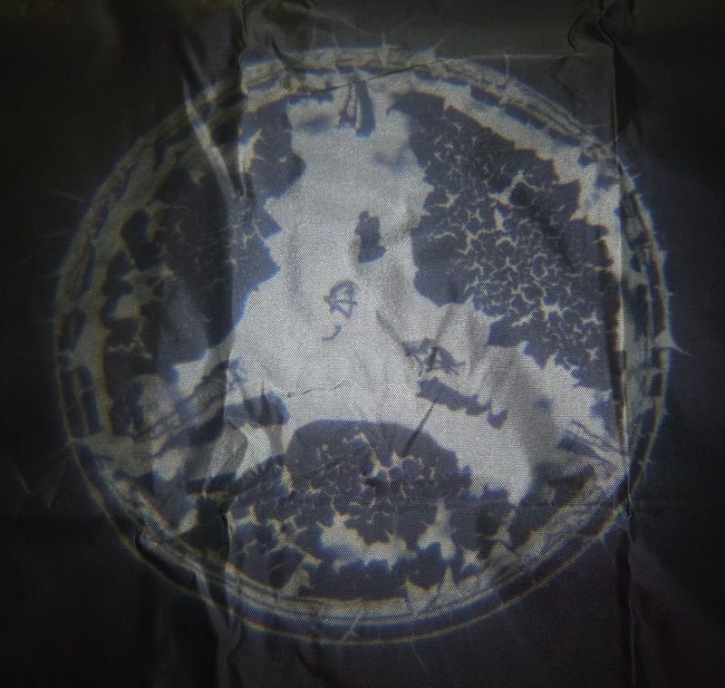

Fractured logos from side view mirror projectors
While our cars seem designed for daytime cruising enjoying the breeze with the top down, there are times when we might take them out in the evening after dark...
Given that my test drives happened during daylight hours, didn't noticed that my car has... "unique" logos that it projects onto the street in the evenings until after taking delivery and eventually driving in the dark!
I believe the projection is supposed to look like this (from GLS):
Haven't decided yet whether this is something that I want to "fix" but it seems like it would be a relatively inexpensive ($130ish in parts?) fix and just hoping for some confirmation on part numbers and process...

As best as I can tell, the exact replacement parts for my car would be the the same as those from the first above post:
A23181046009775 / A23181047009775 (last 4 digits being the color code for IRIDIUM)
The ones referenced in the 2020 post appear to be the older style (A2318101300XXXX / A2318101400XXXX where XXXX is the color code) that projects logo with MERCEDES BENZ text above and below the logo as shown in the first post.
@ThatsMyDawg also posted a photo of another style that has the "Mercedes-Benz" text next to the logo. (don't recall seeing part numbers)
I also found an older part # A1728100115XXXX / A1728100115XXXX that might be just side view mirror illumination WITHOUT a logo (or maybe a different logo?)? Can anyone confirm?
Anyway, debating here whether I want to a) live with the "unique" projections, b) restore the car to original function, or c) replace with non-logo illumination (if the oldest part numbers?)... any input welcome!
