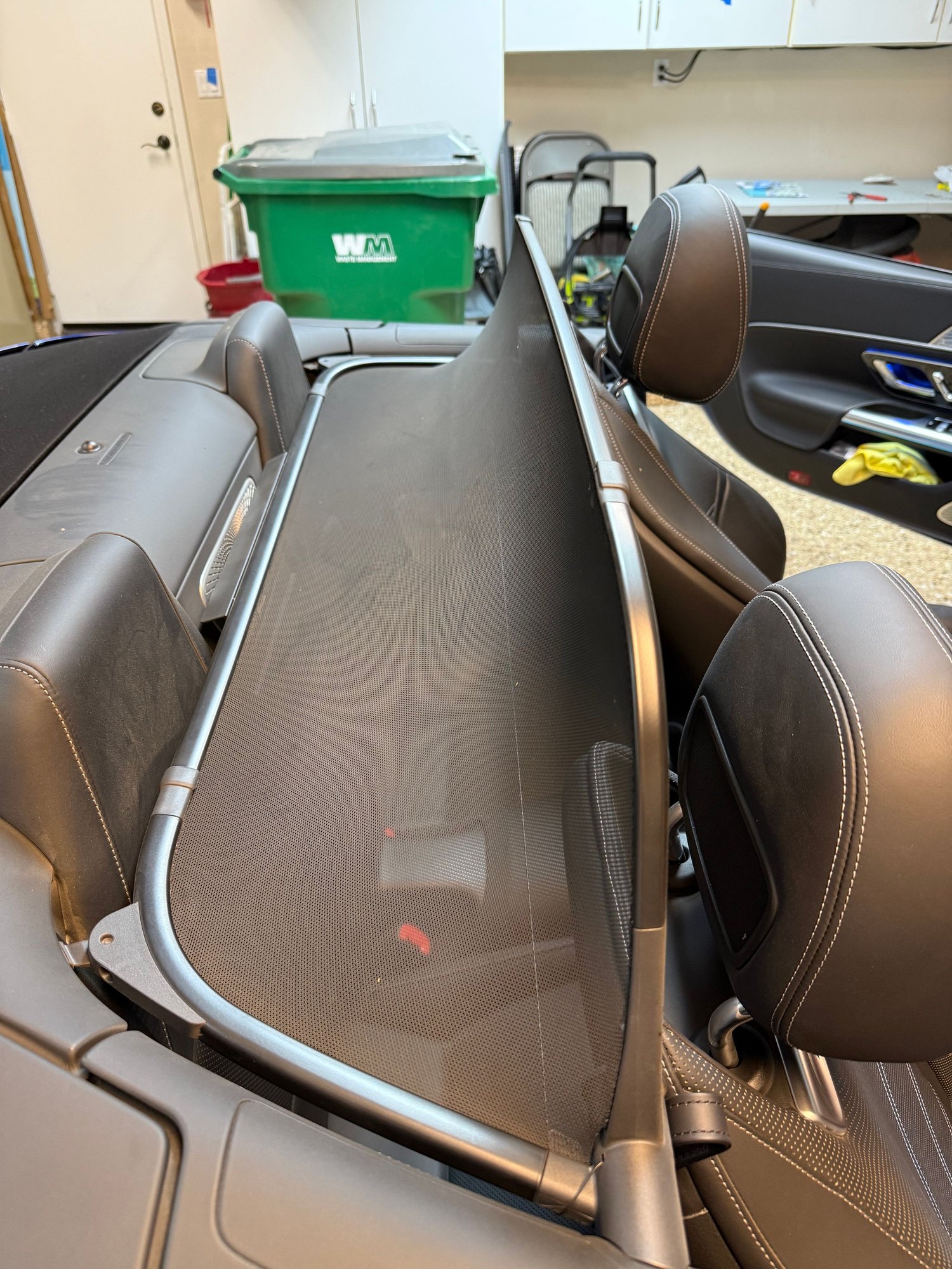

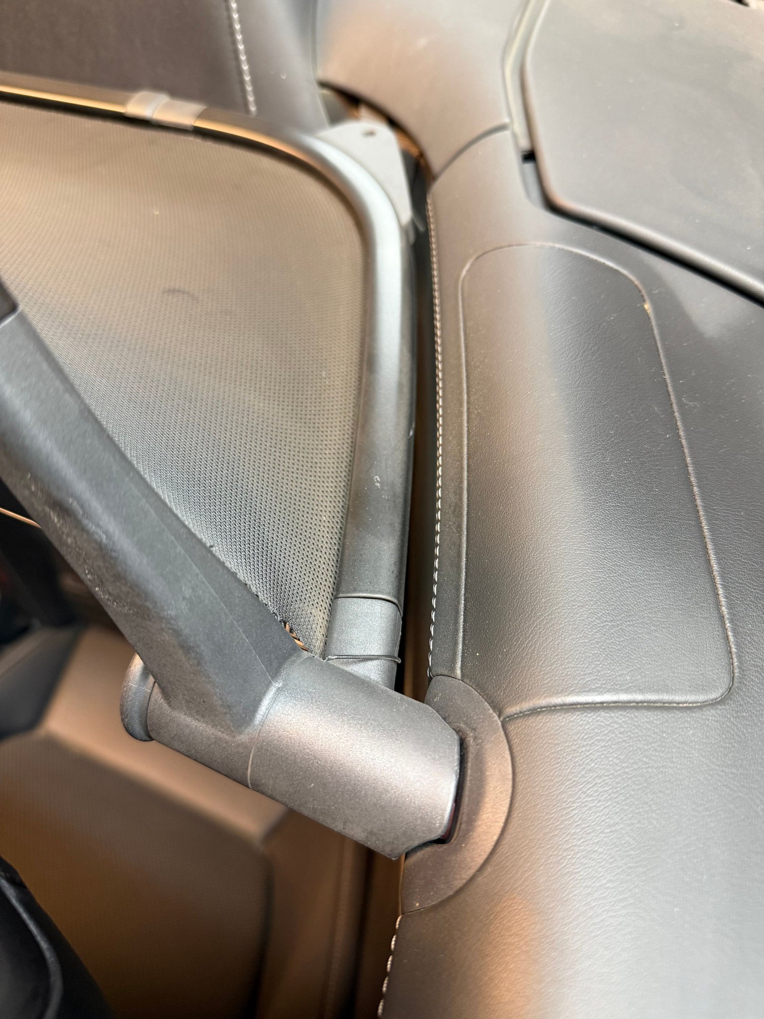

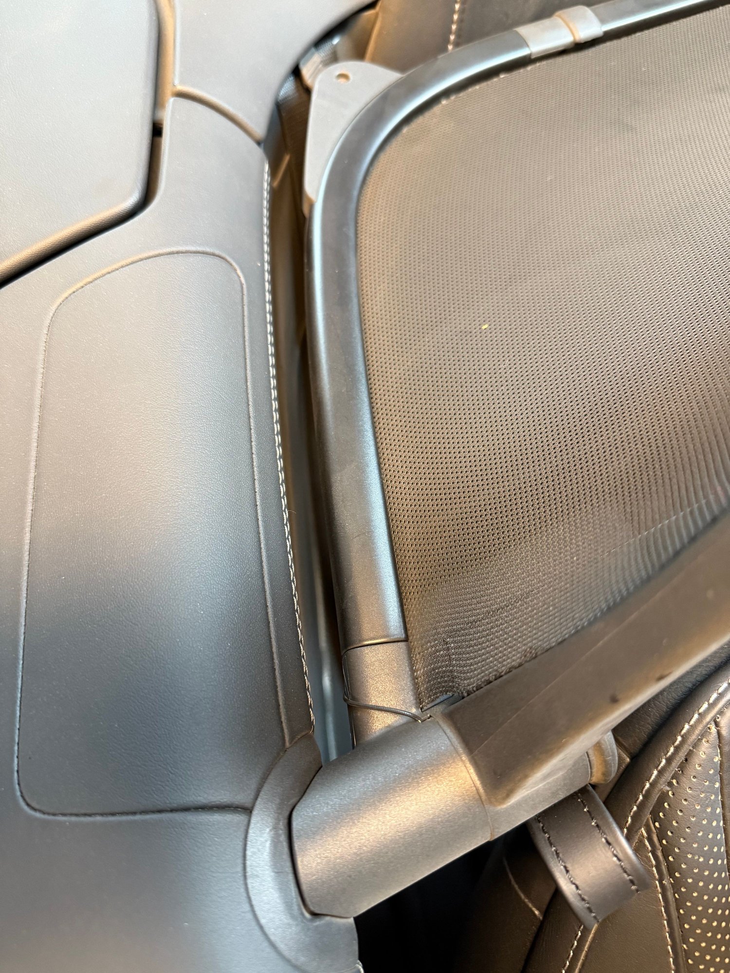

Does your setup look like this?
left side
left side
right side
right side

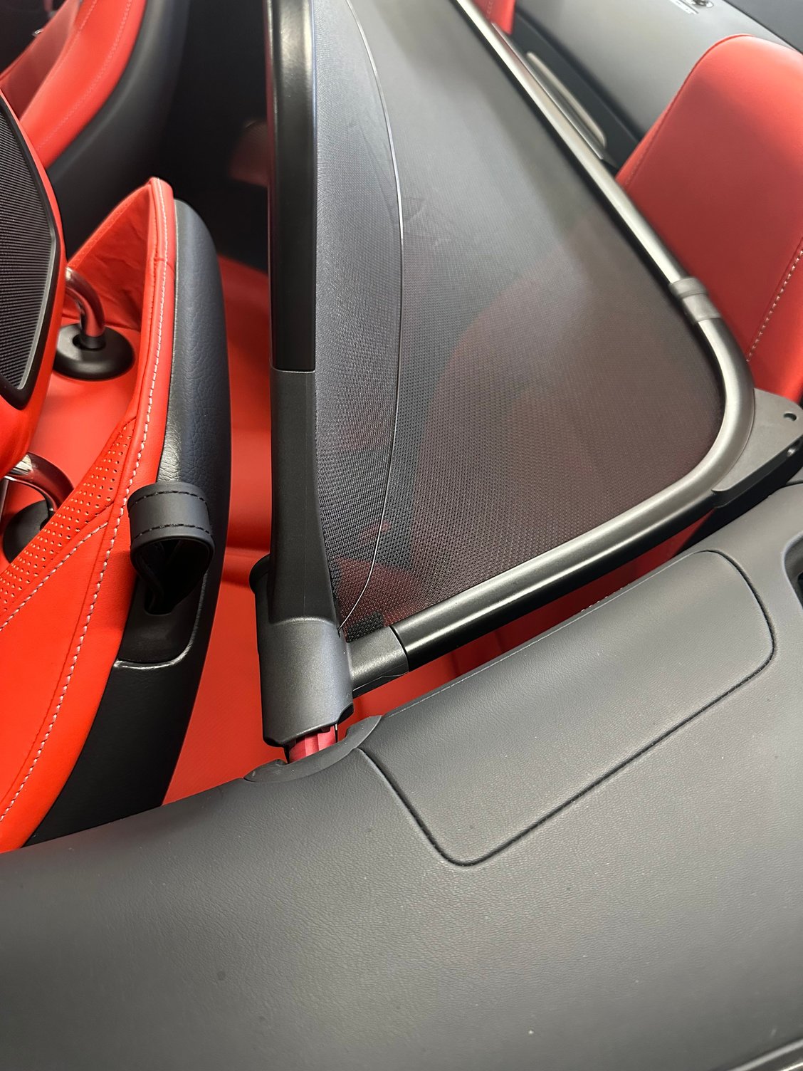

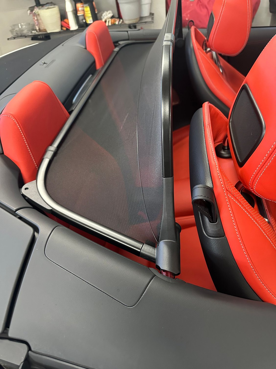

Yes it goes in like yours, but here is the fitment

For some reason, my description did not copy into my post along with my photograph from the owners manual. The fact that your fitment is different from mine is the crucial step that you are missing. You'll notice that the sides of my windscreen anchor in a flush manner, whereas yours show a red plug on either side. If you look at the photograph from the owners manual, you'll notice that it says to pull handle in the direction of the arrow until the red marking is no longer visible. And in your case, that red marking is quite visible on either side. So once you pull it until it is no longer visible then you push the windscreen down and anchor it into the side - once it is pushed down and anchored you let go of the handle and the red plug springs into place with a solid anchoring. Once you get the hang of it, it will be simple and be second nature and the windscreen will be solidly anchored.

Very helpful. I had read the manual, but apparently not careful enough. Did that and it fits well now. Thank you.
