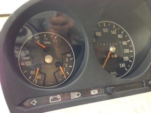

Now someone told me that my fuel gauge is not original for R107 500 sl. Is it true? I have done research and I have seen two types; my current one with 'economy' indicator and another one without it. It makes me confused.
Cheers,
Mo
Attached Thumbnails Need help on Fuel Sender Unit part number.-photo.jpg   Need help on Fuel Sender Unit part number.-kgrhqvhjdkfg-2gbpisbr-w4y77ow-60_12.jpg
