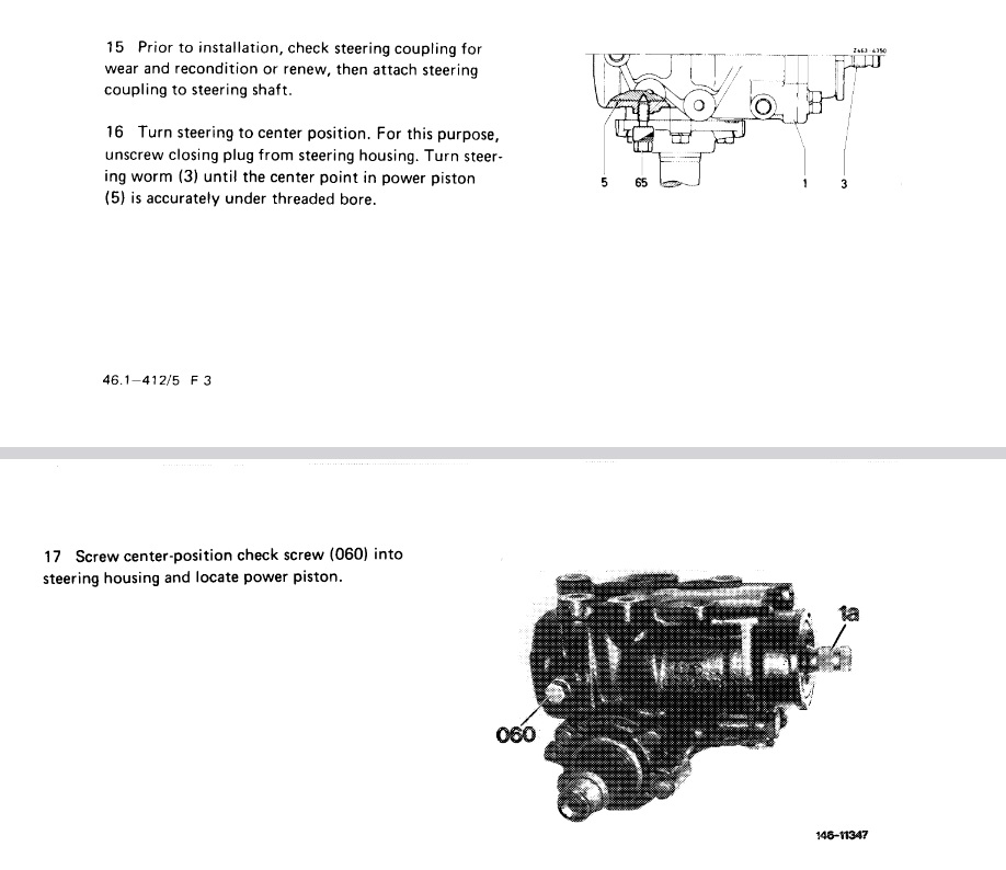

See attachment. There is a closing plug on the bottom of the steering box, this is removed and a centering pin installed when installing the steering box. This centers the piston in the middle of travel so that the steering wheel and pittman shaft can be correctly installed. I made my own centering pin, I think the threads are M8 so I used an M8 bolt with the tip ground to a point.
