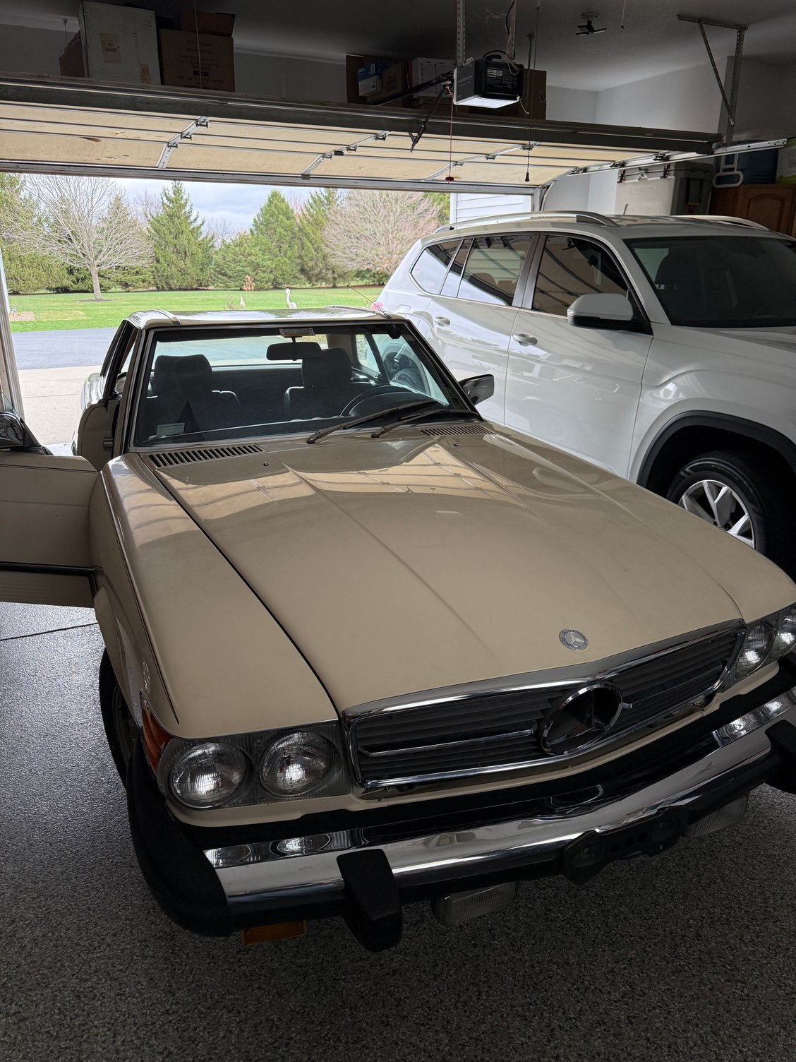

Hello all, let me first apologize for asking things that probably have been asked a million times, but I’m a complete noob. I found a deal I couldn’t pass up on a 1985 380 SL this week, and very quickly pulled the trigger. It had been in storage for a very long time, but surprisingly we were able to get it started and onto a trailer. I got it home yesterday, washed it up, and started trying to compile a list of all of its ailments. It ran, smoking and smelling of old gas, but after a couple mile run to the nearest gas station for a top off, and just warming it up, it cleaned up and started running pretty smoothly. It was filing a bit high, and a bit roughly. I popped the hood to see what I could see, and immediately see that the vacuum advance was disconnected, and the vacuum tube was not plugged. Boom, there is my vacuum leak causing a high idle I figured. Well, I plugged it back in, and then the car basically wouldn’t stay running. My thoughts are maybe just that someone messed with the ignition timing and set it to retarded, so when the vacuum is applied it is far too retarded. Need to pick up a timing light today (haven’t had to use one of those in a long time!) to try and verify. That leads me to my next issue of a service manual. I bought a manual on emanualonline and it is such a mess. Over 7000 pages from all kinds of manuals that aren’t in any order, and the search function isn’t working. Almost an unusable situation entirely. So, I need to find some data to use to set the timing. There is evidence that someone has been messing with this, as the green pickup wire has been replaced, but the old one hasn’t been removed from the group of wires it is run with.

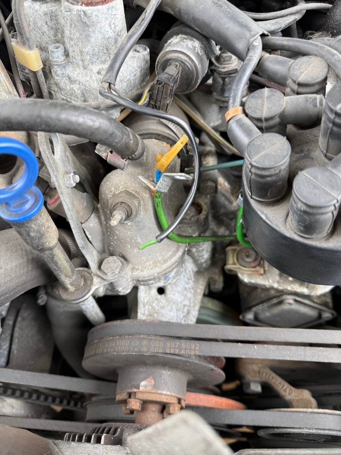

Right next to the distributor is the thermostat housing, and the temp sensor directly on top does not have a wire connected to it. The wire is right next to it, but the connector is broken off. I can fab something up, but would love to find a factory Mercedes connector for it. It’s just a one wire deal, that would just slide onto the temp sensor post.
