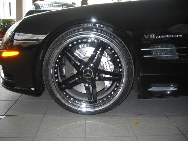

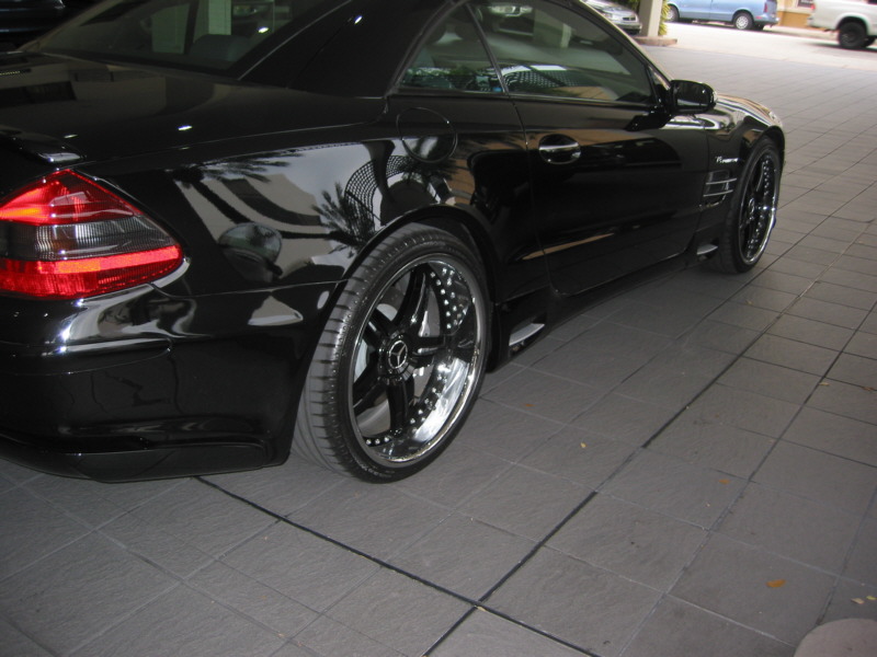

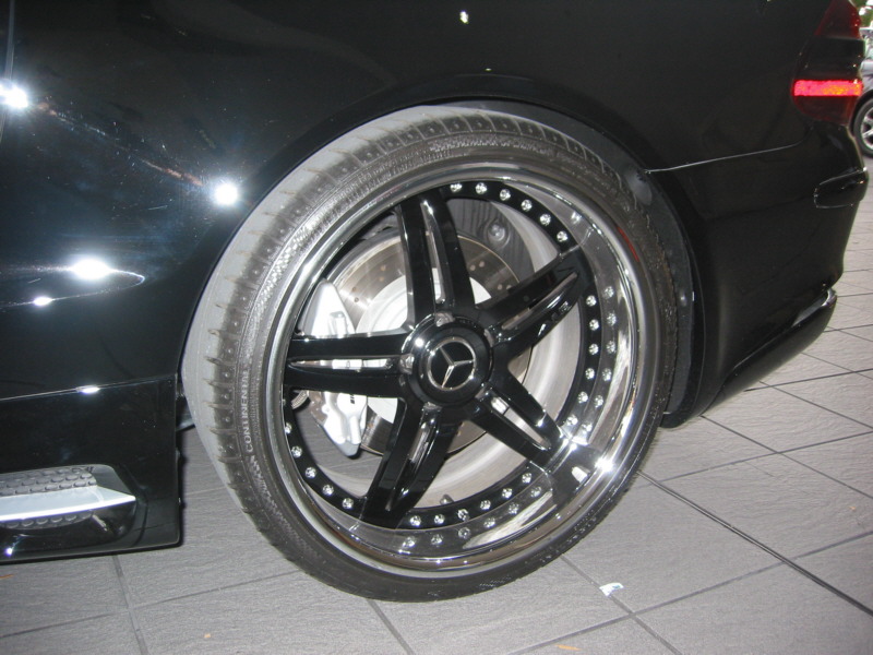

I want these rimms .. who makes them.. and where can i get them.. ??

Provide a better pricture, I can barely tell heh.

I think you can get those from two different high-end vendors. One I "believe" may be Foose but I don't recall the other. Do a search and you should find those on here (maybe in the pics section). They do look nice but probbaly cost about $4K-to$5K before the tires (if I recall correctly)

Here are more pics.. 4-5k´s that sounds allright.. but does anyone in europe carry these.. if not im sure i can ship them over..
But still take a look.. and any info would be appriciated..
