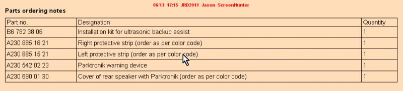

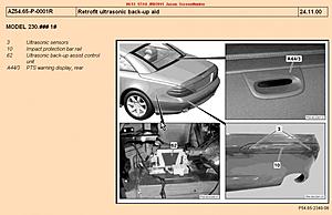

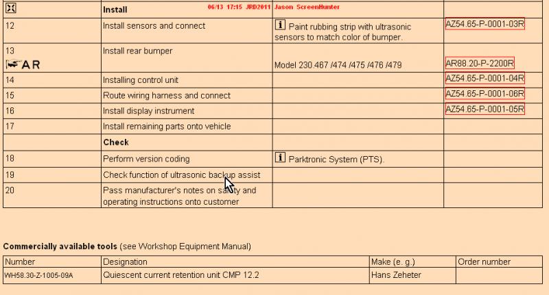

This is kind of a silly question as anything can be added aftermarket but how much do you want to spend???
EXAMPLE:
http://www.youtube.com/watch?v=f5S1N...eature=related
Searched the WIS and as far as retrofitting they have an Ultrasonic back up aid (not the same as parktronic as it does not have any sensors in the front):
