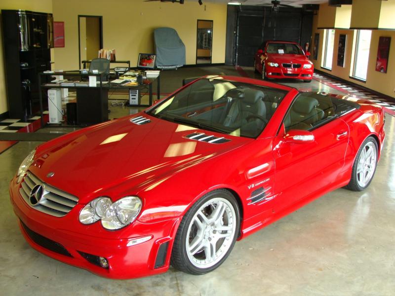

Old Jun 26, 2009 | 10:16 AM
allenjdmb's Avatar
Joined: Nov 2001
Posts: 2,619
Likes: 53
From: Georgia
E 63S Wagon Renntech, E55 Renntech, SL65, SL 55 030, ML, bunch of old ones--they come, they go...
Lets' see if this pic come up...
to give you an idea. Pretty low on lowest setting (but looks great parked), middle is about perfect. If you're in the Southeast, call me and I can help you get it set up. Not all MB delaers will do it, but while it's still in warranty, I like the idea of having it done at the Benz store.
Not my best picture, but will give you an idea...

It is possible to lower these cars through the STAR system. We do it all the time. However, the person doing the lowering really needs to know what they are doing.
