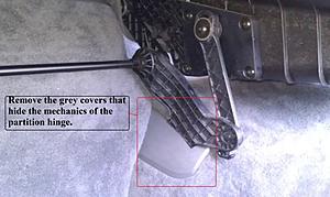

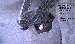

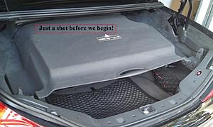

[QUOTE=NikleinR6;4915545]Thank you very much for all the information. I finally decided to knock this out yesterday. Took a little less than an hour. NO MORE KNOCKING SOUND. I took some pics from start to finish to help others in the future.
Rattle - Gas tank-9.jpgHHow do you remove the grey plastic covers that cover the hinge mechanism?

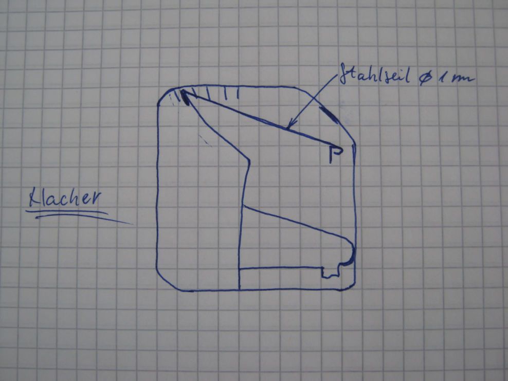

A clever cookie on a German forum observed the interior of his tank with an endoscope. Turns out there’s an L shaped flange running horizontally just below the opening. He used that to attach his non flexible hook to. The plate sits pulled up against the top of the tank.
He had two hesitations I want to share here fwiw:
1- a spring which allows the plate some swinging (don’t know if it does) could eventually make remaining spot welds snap. His plate, by the way, snapped behind its spot weld, not on it. It was the plate itself that failed.
2- liters of swaying fluid could pose a hefty strain on your fix. Think of some jerk accelerating and stopping a car while at the passenger seat you’re trying to keep still a few big buckets filled with liquid. Will the plastic arm of the sender unit cope with those reciproting forces, in the end? (The same can be said of the L shaped bracket and the rod of course, seeing that failing metal caused the problem in the first place).
All in all, a solution without drilling and leaving the sender alone has its elegance.
Old Feb 15, 2019 | 05:53 AM
  #95
Frederick NL's Avatar
Joined: Mar 2018
Posts: 1,442
Likes: 260
From: Netherlands
2005 R 230 SL350 (M112 3.7). Sold the 1966 W113 230SL recently
Sketches with post above
in this case at least, the ‘snap’ occurred in the foot bottom right of the drawing
