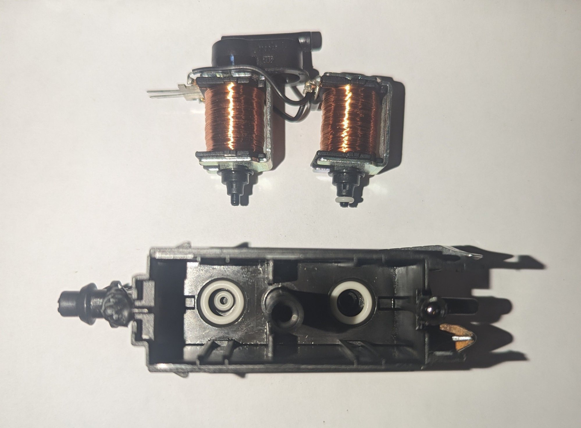

[img alt="These are the coils to switch air between the open actuator and soft close actuator.
My question, is one normally open and the other closed since its only a 2 wire plug ?
Ive got a picture of the micro switches over by the open ( hockey puck ) linkage too.
Is there a wiring diagram for this latch assembly ?
Thanks "]https://cimg3.ibsrv.net/gimg/www.mbworld.org-vbulletin/2000x1471/pxl_20241111_150259886_f28e8a58f4c5a6a0e56b2ed37fa 32cfed4f44b68.jpg[/img]
These are the coils to switch air between the open actuator and soft close actuator. My question, is one normally open and the other closed since it's only a 2 wire plug ? I've got a picture of the micro switches over by the open ( hockey puck ) linkage too. Is there a wiring diagram for this latch assembly ? Thanks

[img alt="These are the 2 micro switches
Top one is first lock position
Bottom one is soft close position
These are connected to the 3 wire plug "]https://cimg0.ibsrv.net/gimg/www.mbworld.org-vbulletin/2000x1504/pxl_20241113_025051705_mp_c636ea39ae88f9dc84787632 ce5c3ffbd3a227b0.jpg[/img]
These are the 2 micro switches Top one is first lock position Bottom one is soft close position These are connected to the 3 wire plug

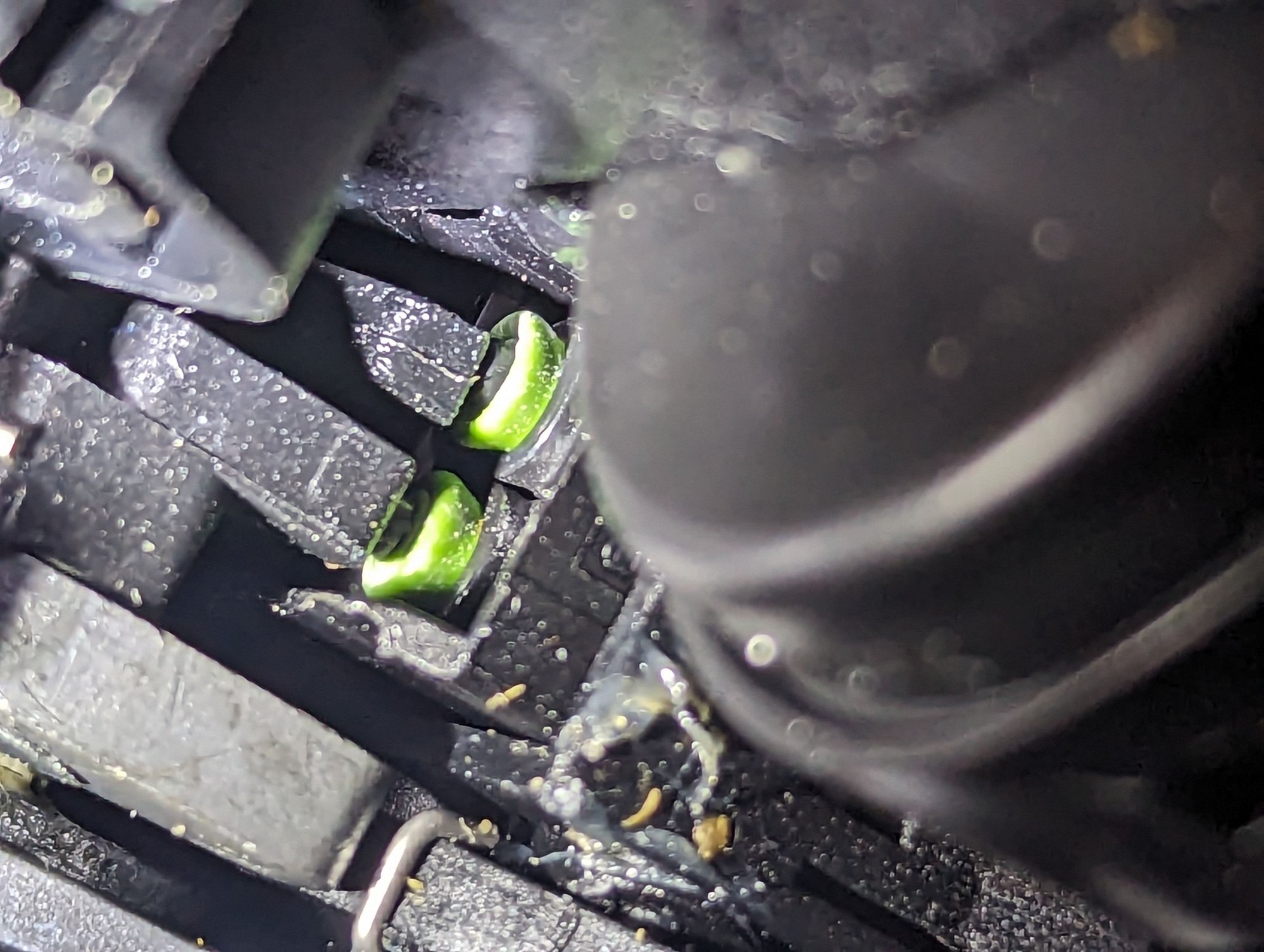

I'm reviving this thread because it seems to have the fix for the trunk not latching all the way. Which mine has been doing for a while. But, I only see 4 ports with a ball bearing.
