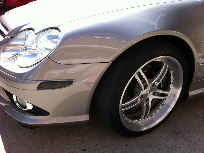

Finished 07 side marker install
Pics attached. Love the look on my color car. Also attached is a pic from the inside showing the phillips head screw that holds the side marker on. You can not "snap" the side marker off the 07. You have to remove the wheel and a few of the screws from the inside liner to get to the screw. Still, I did the whole thing in less than an hour for both sides.
