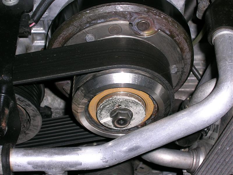

THESE SHIM. BETWEEN THE MAGNETIC FRICTION PLATE AND PULLEY..
YOU CAN SEE HOW WORNED DOWN THE FRICTION PLATE IS .
MAKE SURE THERE'S CLEARANCE

thanks for the pics and advice everyone - i just dropped it in today to have the whole clutch replaced -
