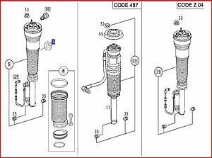

Old Jan 22, 2015 | 02:26 PM
ibeforreal's Avatar
Joined: Jun 2002
Posts: 1,284
Likes: 37
From: North Carolina
2003 S500 - Toyota Corolla (in the rain)
Sqaar, I looked at the part number on my S500 which has the ABC suspension and it is 220 327 02 92. Using that number I did several searches and came up with the following information. I figured if the thing has a part number then somewhere in this world there must be a manufacturer. Here is the link I found with the part. http://www.kakapart.com/products/5273577-1757859.html
It is a company in China. I tried several methods to contact them but none worked. I finally contacted the company directly and am waiting on a response. I will keep you posted.
Using your part number on the same website it came up with this. http://www.kakapart.com/search/defau...0327%2000%2092
