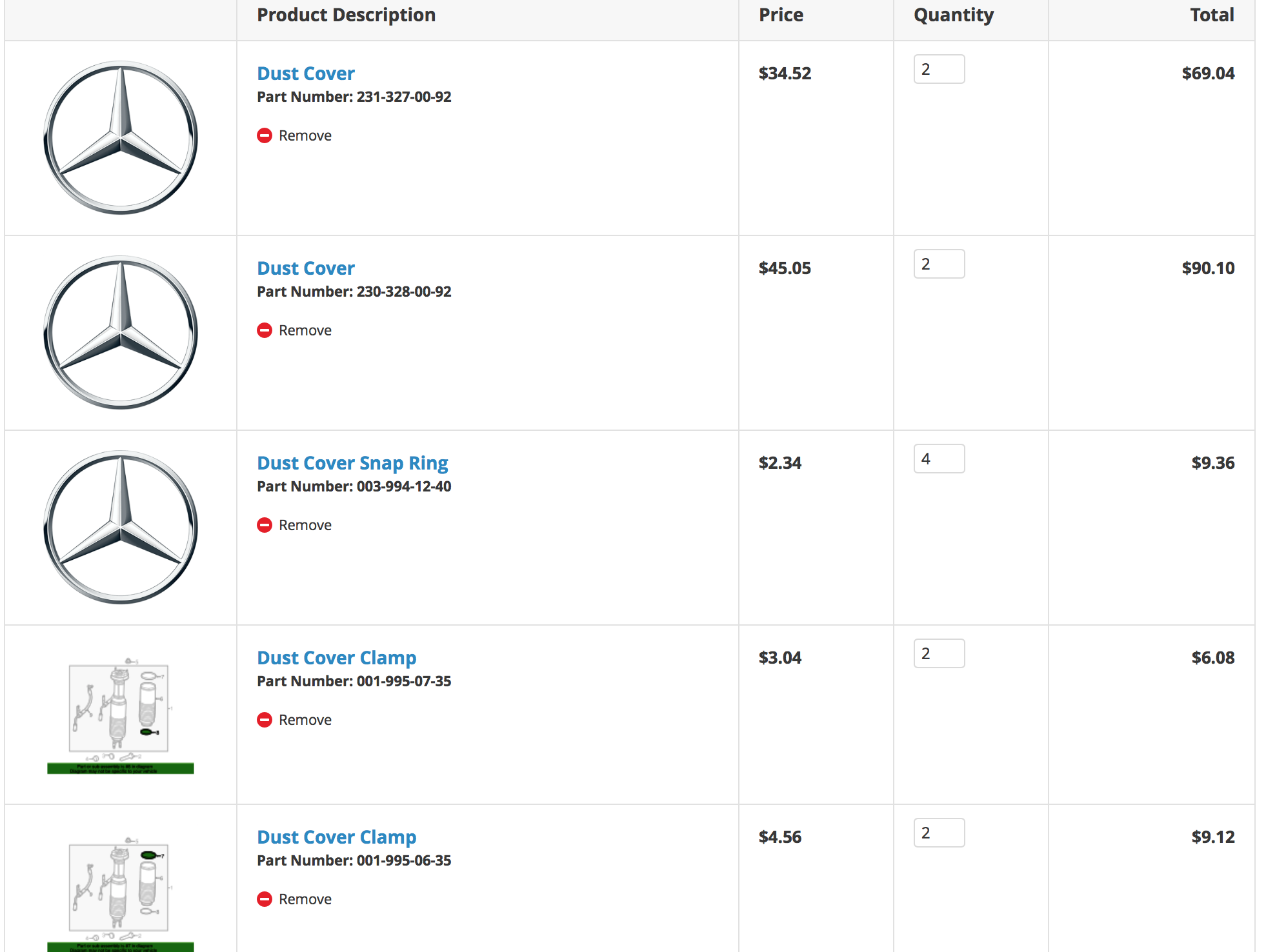

Well I came up empty searching the net for replacement strut boots/covers for my 07 SL550. Fortunately though, I know German so I started weeding through German sites as this problem surely must exist in the fatherland as well.
I came across the following site which in detail lists part numbers and backwards compatibility of certain parts, confirmed by a member from another forum, which I probably cannot name here.
So here it goes, this is the info I was able to gather:
Rear strut covers: They are (reportedly) the same for all SL 230 and 231 models. The part number, available as of May 2012, is 230-328-00-92. There are 2 snap rings that hold the covers in place, and their part number is 003-994-12-40.
Front strut covers: (reportedly) the lower strut cover for R231 models is backwards compatible with ALL R230 models. The part number is 231-327-00-92. On the above linked site under 1.2 you can find photos comparing the original strut covers (the ones you cannot get a direct replacement for) and the R231 covers. There is one difference, as in the bottom opening is larger and shorter, and the word is that this "exposes" more of the lower aluminum "spring plate", and the recommendation is to spray the exposed area of the spring plate with "spray wax" (not sure exactly what is meant with this but maybe someone can chime in). The upper clamp is part number 001-995-06-35 and the lower one 001-995-07-35, however they say you can use stainless steel screw clamps if you want.
Below is a screenshot of the parts I just ordered. I hope this helps someone, and I will certainly report back once the parts are installed.
Attached Thumbnails R230 Front Strut Dust Cover Replacement-screen-shot-2017-07-02-7.40.43-pm.png

That part is available thru US sources as well and you can use black zip ties instead of the SS clamps but there's also SS zip ties
"Spray wax" would be a generic term for paraffin based undercoating
http://www.mbpartscenter.com/mercede...me=dust-shield

Originally Posted by Hary Gahtoe
Precisely. The R231 boot from MB is a close alternative. Ooorr... try contacting Arnotts. They rebuild our struts plus many others
Good Luck
Read through the thread, saw many suggestions but no final resolution. Found and ordered a bellows kit on ebay for about $120 (unfortunately, it's Chinese). I plan on disconnecting the lower link and sliding them on. I'll follow up in Sept when done. (I don't get in a big hurry usually.)
You can buy replacement rear strut covers from Mercedes for £40 apiece part number A2303280092, for the front you have to buy the whole strut
Hope this helps
