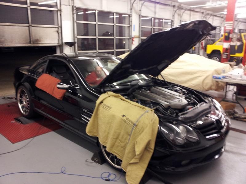

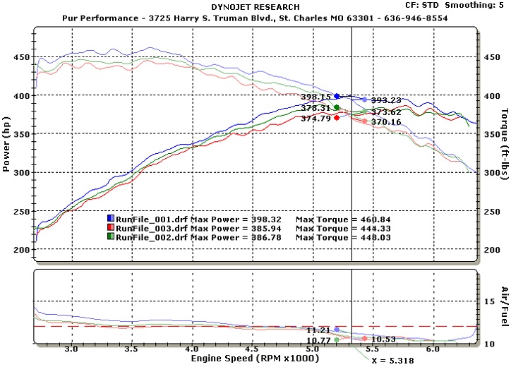

As suggested on the forum I took my semi-stock 2003 SL55 to a local shop to get Dynoed. Currently, the car has new plugs, new abc pump, new ac compressor, new secondary heat exchanger, new johnson cm30, new belts, new tensioner, new sc bearing, new transmission oil/filter. In the near future, I will add the Eurocharged 175mm pulley, ecu, tcu tune and open up the exhaust by removing primary resonators and adding an xpipe while reusing the existing mufflers.

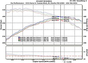

With that in mind, I believe that my secondary heat exchanger and pump might have not have been bled properly. The car sounded great and the coolant temp was slightly above 80*c ~200*f. I wish I had my scangauge to monitor the IAT and MAP to see that the boost does not drop off.
Please take a look at the attached output of only 398hp max and 460 torque max. In all runs we did a 3rd gear pull and idled the car for about 10 minutes between the runs.
One more thing I noticed was that the car was running very rich towards the end I hope that Eurocharged will take care of this during the tune.
http://youtu.be/7pCPqVom2y0
Also, the car was not in dyno mode and in the future I will make sure to bring the software to put it in dyno mode.

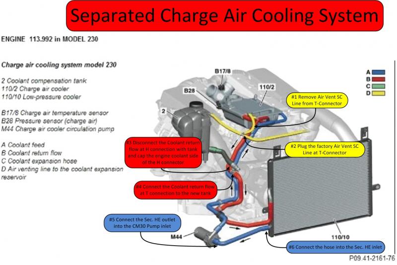

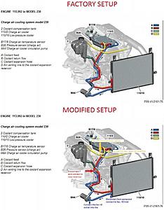

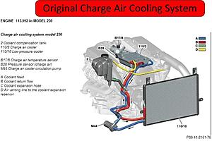

I believe I have an understanding and have put the following image together as far as how to seperate the Engine Circuit from Supercharger Circuit. To make this happen you will need a reservoir and a secondary heat exchanger. I have used the PTE one from Ebay but it had to be modified (write up coming shortly...)

I cant make out the text in the pic. The hose coming out of the hot side that goes into the IC will be vented to the res and the other outlet on the res will be teed to the pull side of the system.

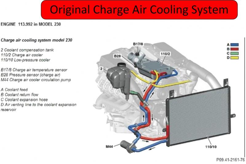

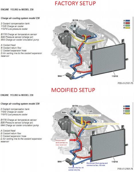

Updated photos please take a look and let me know what you think.

Yes thats correct...pic of my tank and vent hose, the other hose gets teed into the hot side
