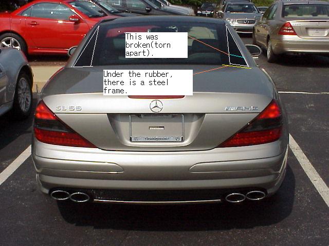

As above people say, you may open the top while very slow
moving .
I recommend strongly not to do.
I did it 3 times at reverse way. I mean I closed the top while slow
moving . At that time , no problem I had.
But later , when I open the top at the stop position(yes, parking
position!) , one of plastic covers ,which are installed at the sides of back glass, was suddenly broken during the opening peration.
(See the attached picture:FYI-this is not my car picture).
When you open the top, the steel part under the rubber
may push up and break the bottom part of that plastic cover
if there is a mis-alignment at the mechanism.

i had the same parts come off on my top around the rear window. they have a upgrade for the covers and the fasteners underneath. if it happens again check with the tech.
