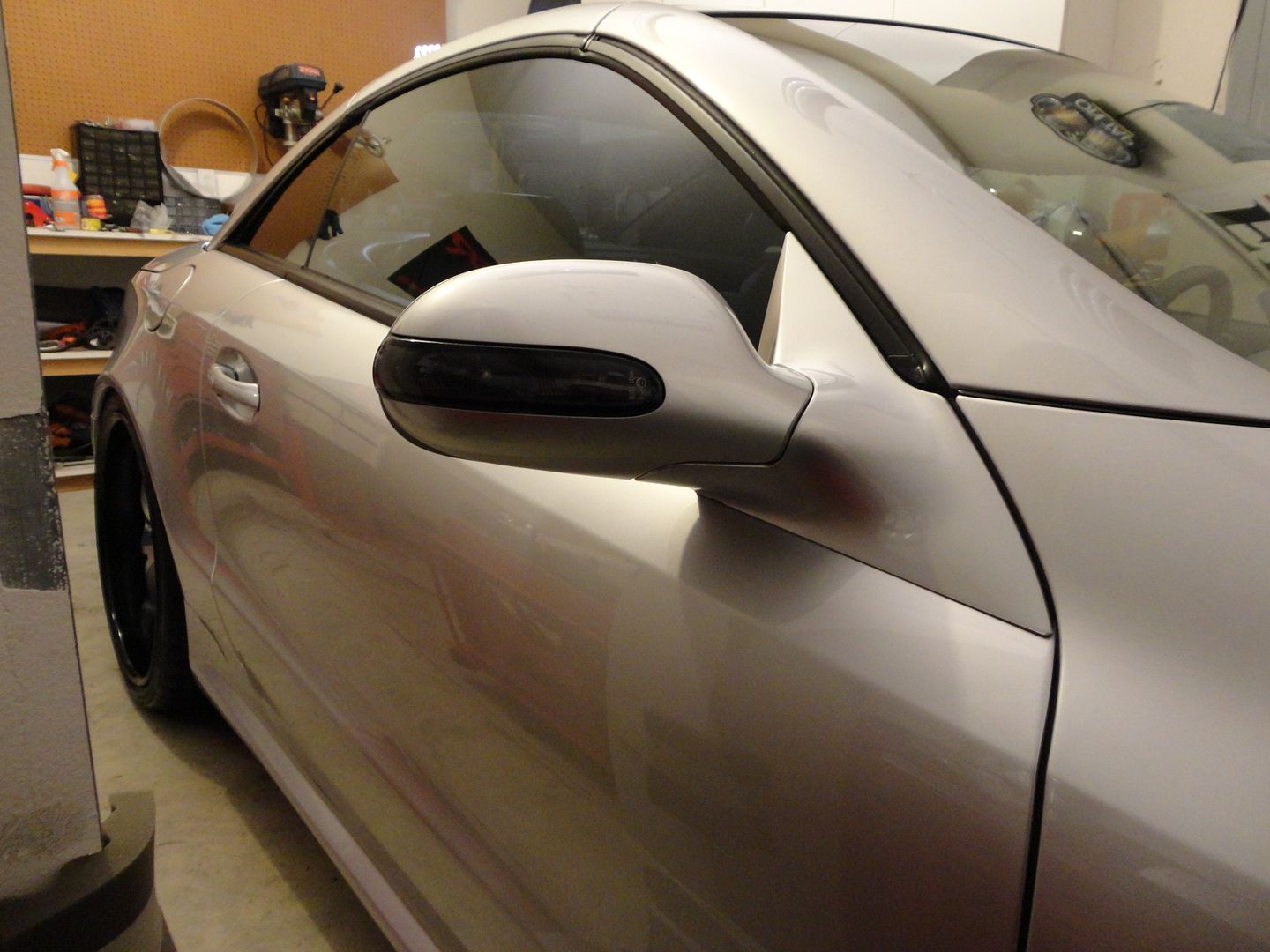

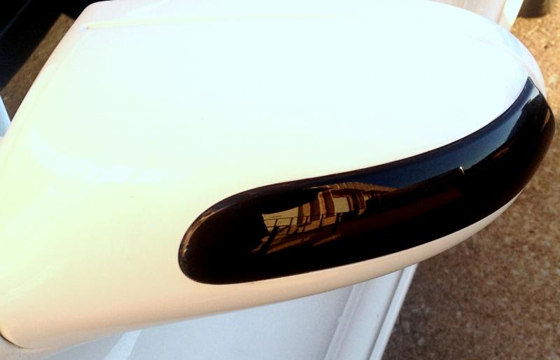

When researching turn signals I don't recall ever seeing any tinted versions either. I am still waiting on my new style mirrors to get back from paint. I actually tinted my stock signals on Friday. They turned out pretty good. I found that many light coats seemed to work best. Turned out pretty smooth but I likely did them darker than most will do. I just taped everything off really well. I used the painters tape and tucked it into the mirror along the lens and papered off the rest of the door and fender. It pulled out really easy when done.

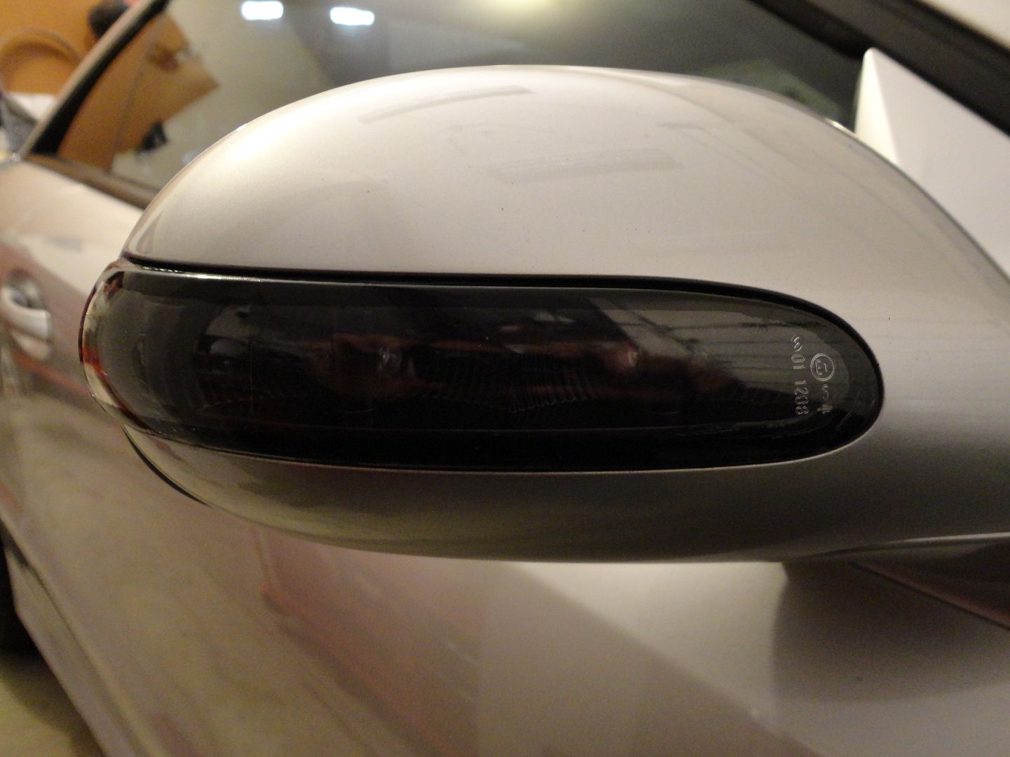

I don't have a close up photo, but I matte smoked my turn signals with some film from eBay. Only took like 5 minutes per side.

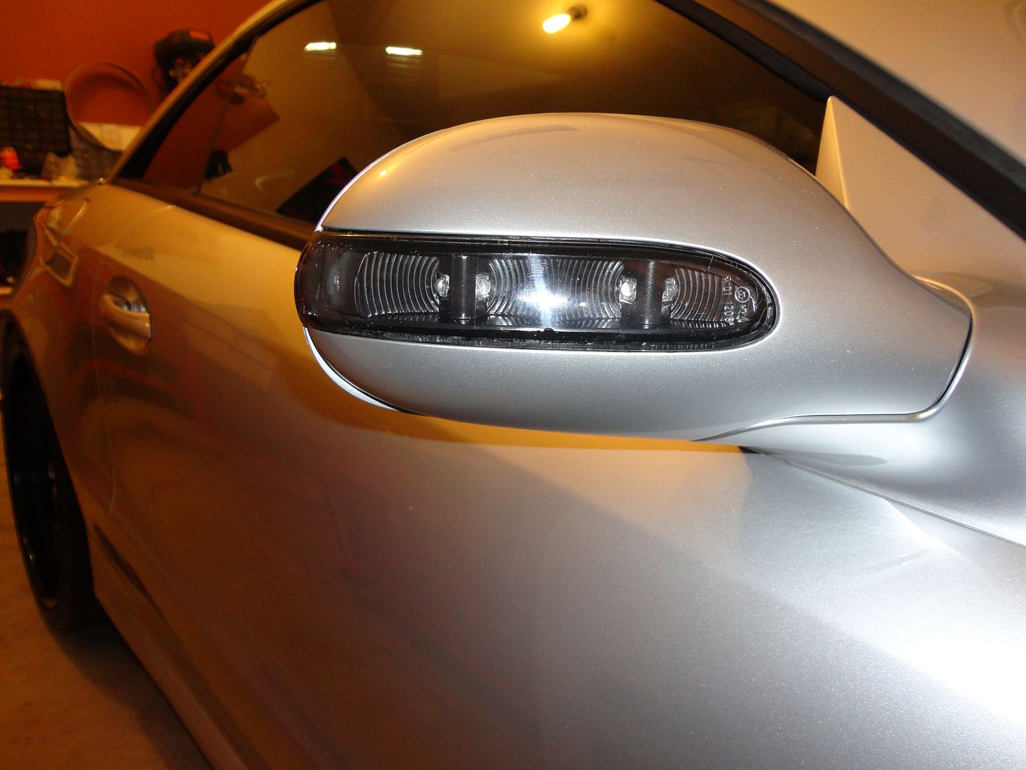

well, it looks good on the car. but, when led shines behind it you can see tiny little cracks that happened due to using the chemicals i used on it having to wipe silicone and paint off till figuring the correct method. think i feel good enough about it to do the drivers side now. should come out perfect now i know the process i will have to use and no need to back track. it is super hard to see the flaws in the pass. side, and nobody will be close to mirror while it is blinking (unless they want to get run over!) but i do have another one lined up if i can't live with it.

you can see the very small cracks in the pic with the flash. it was due to the chemical i was using to remove the previous paint tries. i believe it chills it on evaporation and puts tiny stress cracks in it. or maybe too much heat with the heat gun.
