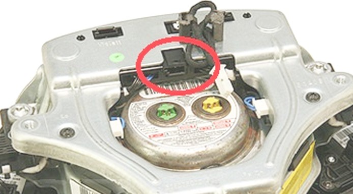

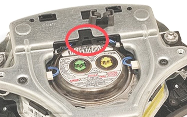

What i meant is that the steering wheel buttons and Lin-Bus module is integrated in the Airbag
The Airbag works no matter what, but the Lin-Bus module for the buttons is R230 Only.
I have new 3 spoke steering wheel in my 2002 with old cluster, no problem at all.
Look at the attached picture for the visual difference on a SL versus SLK/CLS Airbag/Switch module unit
First Picture is the SL unit with the "stepped" BUS connector
Second pic is the SLK/CLS unit with the square connector with one "tap"
To complicate things a bit the SLK/CLS version also uses a R230 Spare part number
Spare part number for the 3 spoke R230 Airbag is A2308602202
This is for the standard and the flat bottom AMG steering wheel
The Performance Pack steering wheel with the Aluminum part in the bottom uses Airbag number A2308602802
