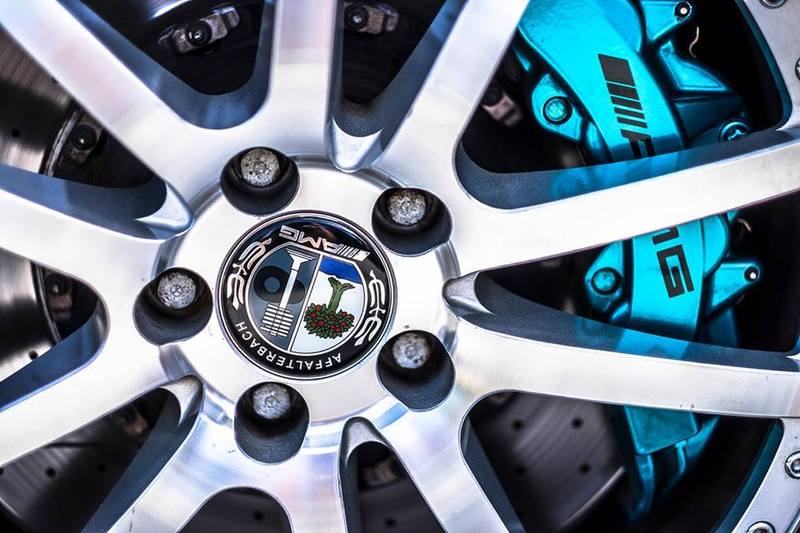

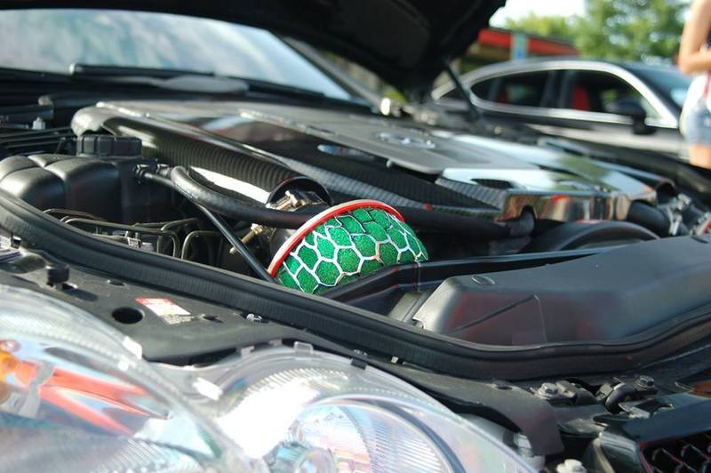

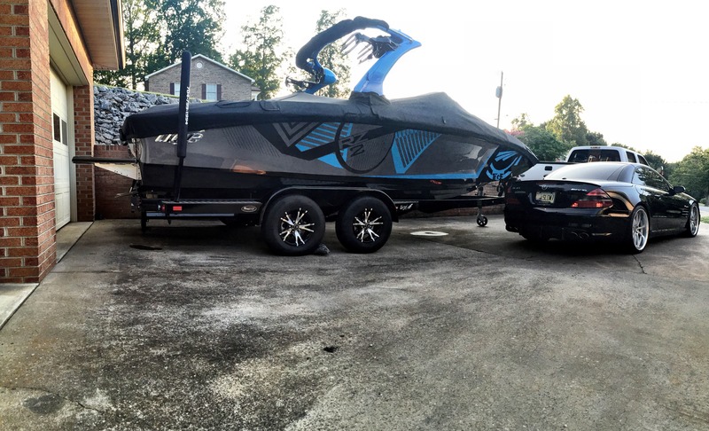

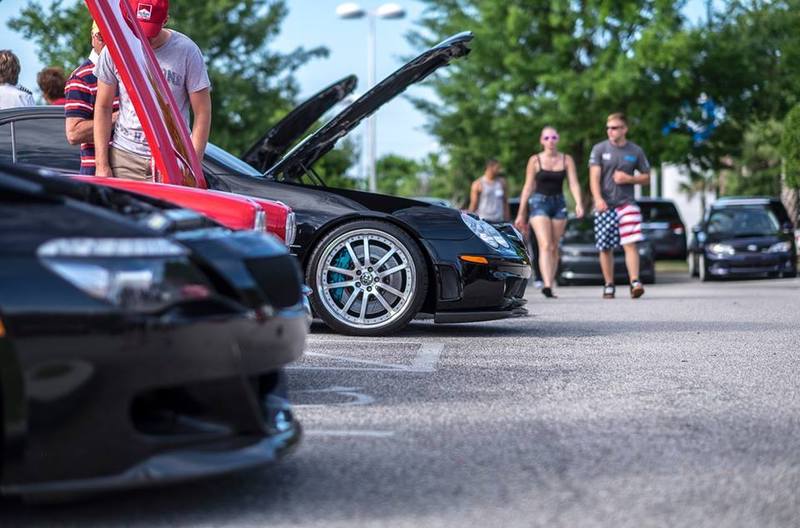

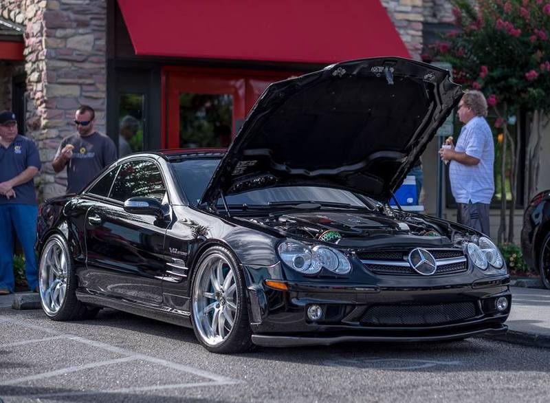

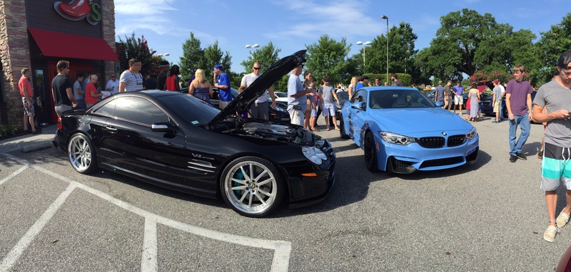

Picked up a SL63 style carbon rear wing like I had on my SL55 from a memeber and will get that on soon. Need to stop being lazy and upload some of the videos I have. Here are a few pictures from the local Cars & Coffee and with my buddies new wake boat.

looks nice!

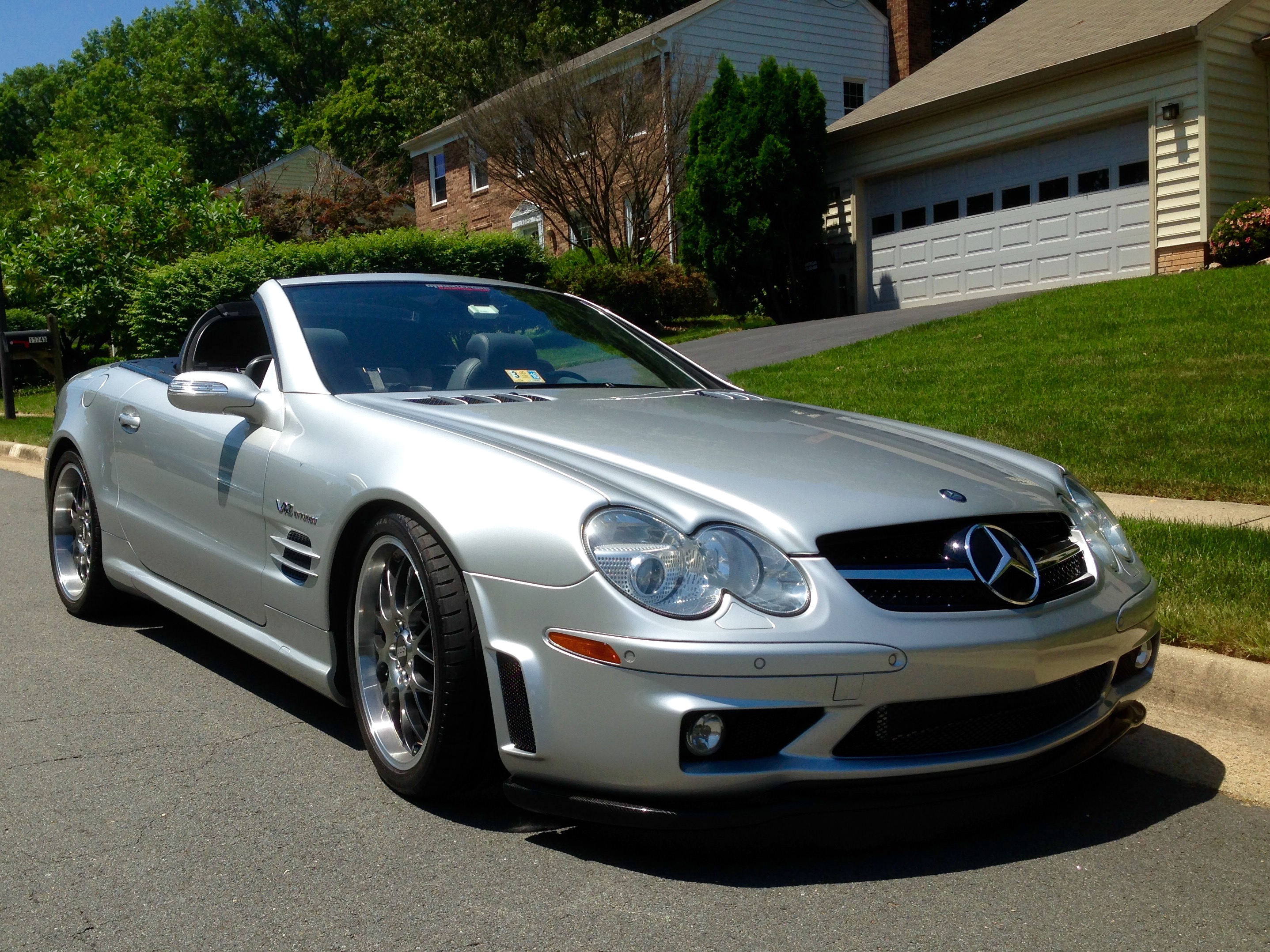

euphoriaDSM - can't help ya with the ABC hose diagram, sorry.

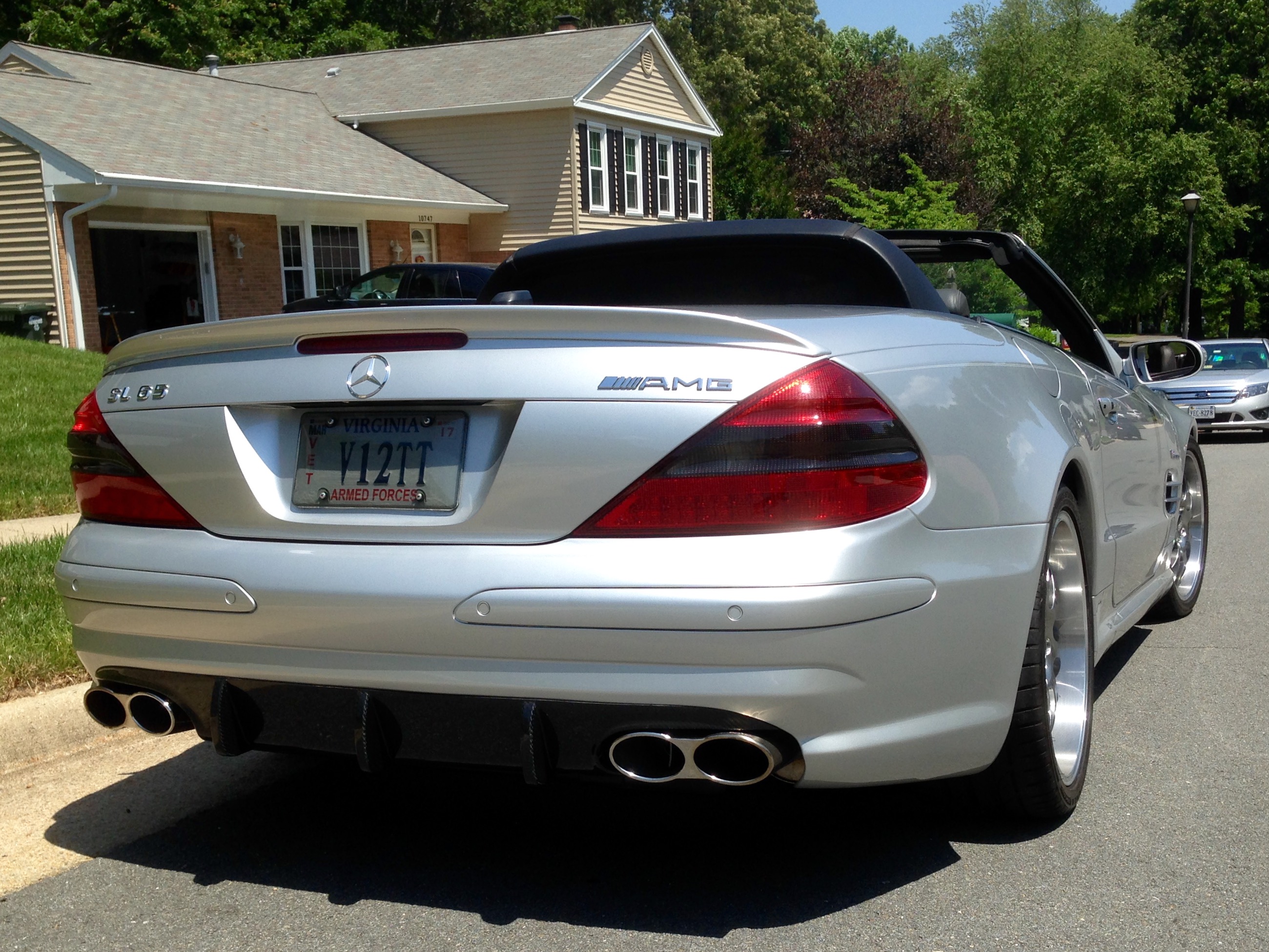

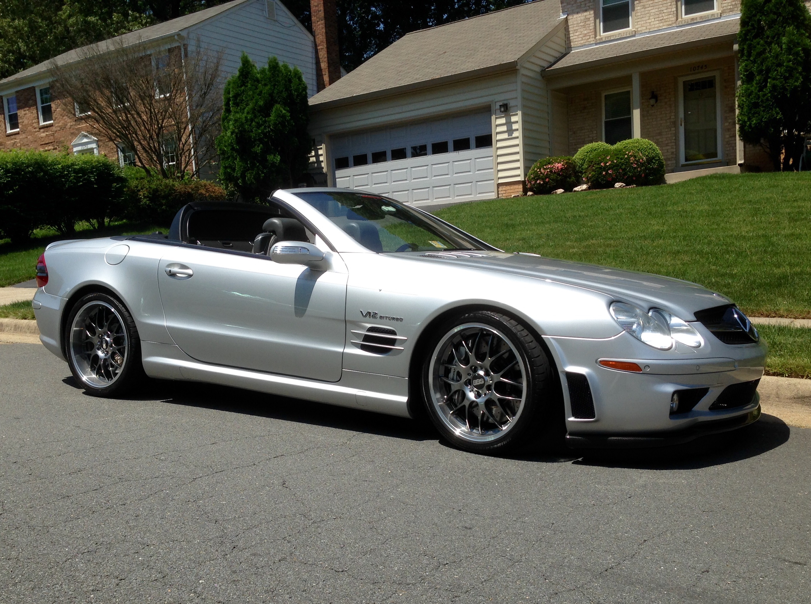

Your work has given me some good ideas for my 65 so I figured I'd share a few photos with you. One of the photos was taken in your neck of the woods - the old Lotus testing grounds, now NCCAR.
My OEM wheels are in storage, the car has BBS-GTs installed. Lastly, my Meisterschafts sound real nice; hollow rumble at idle and a screaming jet at speed.
Thanks for sharing your work...
