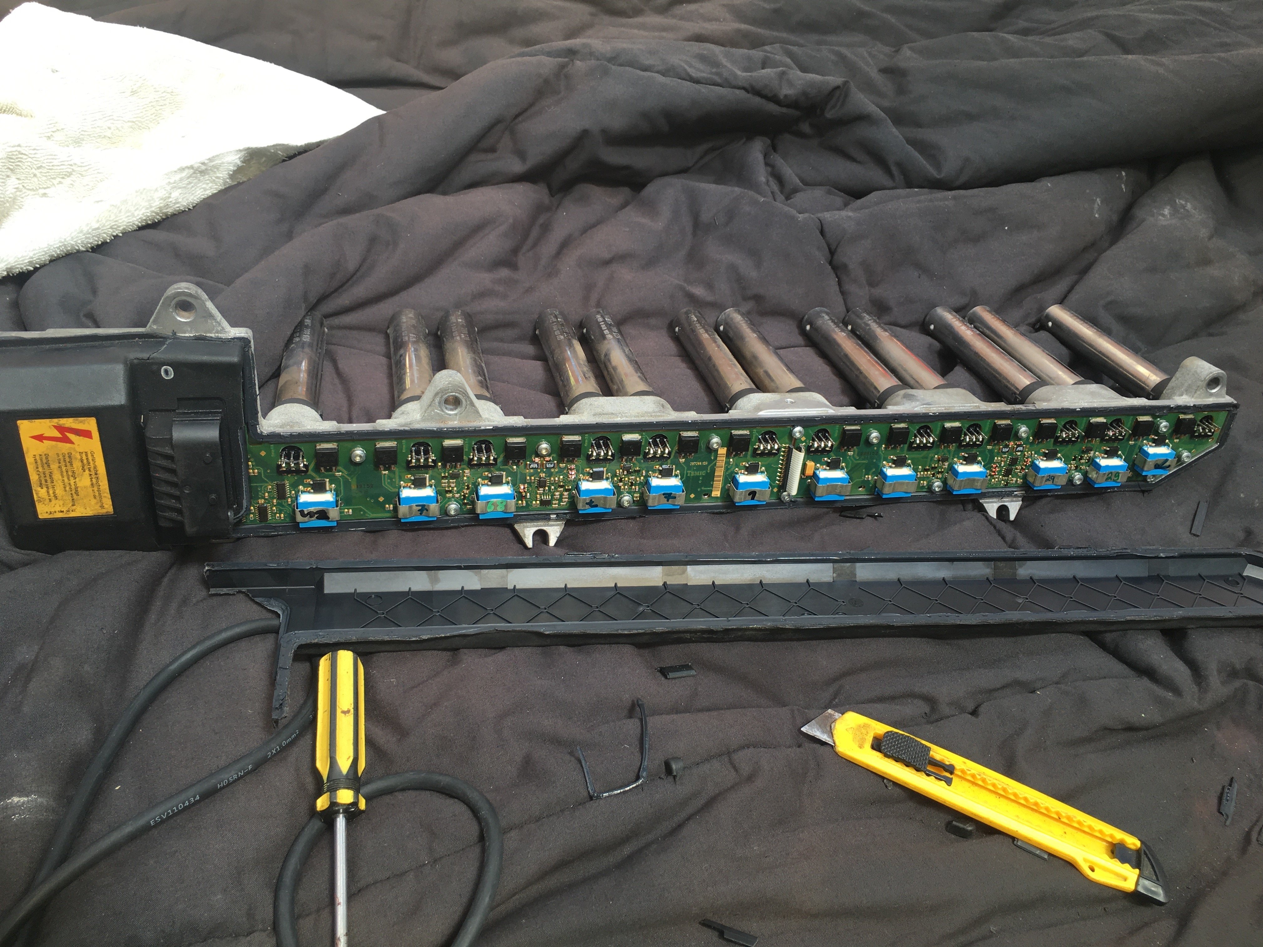

opened coil packs today! internal solder looked okay, no visible burned out components.
There's nothing there to see.
When a coil pack fails, you MAYBE see a bulge in the cylindrical metal screen around the coil. In bad cases you see a bulge or a burn. It might just be a slight split in the longitudinal welded seam.
Nick
Nick
Several members have said its usually the "top of the coil solder joints that crack" that usually makes them fail, but mine seemed intact. I did find condensation on two of the coils where the plugs go into, and two rubber plug boots cracked, am thinking this has come from the expansion tank IC nipple. About a hour ago I was reading your write up on cooling pumps , IC, HE wow , did you end up going parallel yet ?

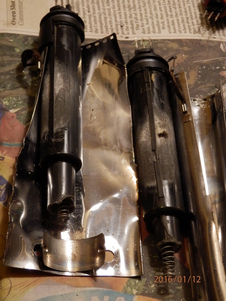

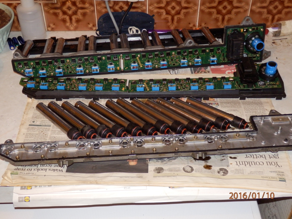

This is what I did with my two bad coil packs.
First I tried removing the coils without disconnecting them from the inside first. You can do this, but you break the three electrical connections, and then you have to open up anyway, and repair them afterwards. I found the foils broke, rather than their tiny welded joints. I was hoping the joints would be the problem, as they would be an easy fix, but I never found one that seemed remotely weak. And I pulled 20 of them.
Where I saw any indication of a coil overheating, I removed it and pulled it apart. They're tough! A bad coil seems to overheat in the centre, and burn through to the outside. The plastic is pushed out and the metal cylinder is pushed open. It must take a lot of force to do that.
Even on a coil that had obviously failed, I couldn't find any electrical measurement to identify a faulty one. Each leg of a good coil measures about 600 milliohms, but then so does a bad one.
Replacement coil can come from new MotorKing replacements from eBay, or from a "bad" used OEM coil.
Nick
Nick
How can you tell which coils needed repairing ? hit or miss by the sounds of it considering measuring ohms doesnt indicate anything. There must be a way to test them, and not just look at a coil from the outside with a marking and automatically assume its faulty.
Maybe if you have a photo to post of what markings to look for from the outside of the coil stainless steel housing?

Ultimately you just have to read the diagnostic trouble codes.
