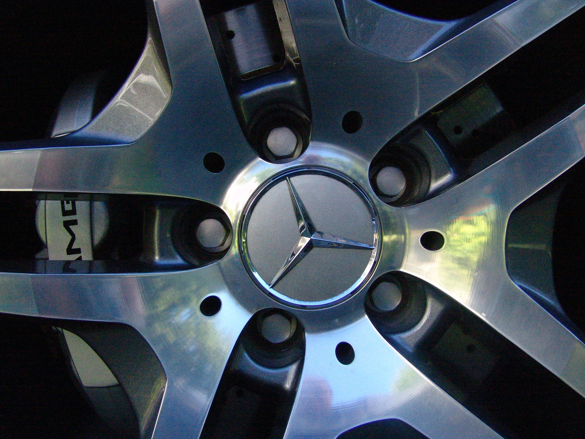

Couldn't stand the rusty lugbolts on my SL63 any longer. Bought a new set, and prepped them like this:
- brushed with a wire wheel
- cleaned with naptha
- 2 coats of Rustoleum high temp silver paint (heads only)
- baked in the oven for 45 minutes at 450
- lithium grease on contact surfaces and threads
One note: the Rustoleum high temp silver is a bit bright. Depending on your wheels, you might want something a bit darker.
Nice, easy project and man, what a diff! Hope these will last a while. Going to brush the old ones now to see how well they clean up.

Grease on the threads???? Not a good idea

no, if its all clean it is good

Grease on the contact surface I wouldn't do. You want that to seize. You will stretch the bolt more for the same amount of torque. You are not the first one to do it though.

looks good, nice work
