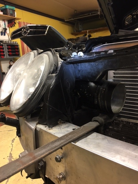

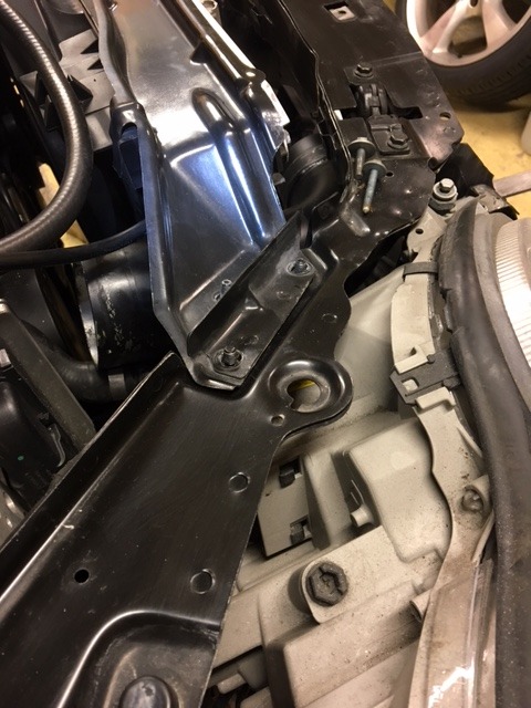

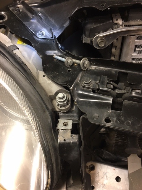

Hello.

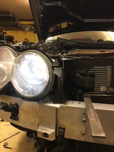

Today I had a chance to install the "old" model of headlight. Many of you have wondered is there space enough for the 3" CAI tube. Yes there is space enough. As much as the facelift headlight has. No problem at all so my CAI system fits also SL65AMG / SL600 and CL65AMG / CL600 with the old style head lights.
Maybe all 55AMG's also.

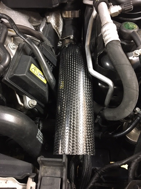

Test fit.
Its very tight but its there . 3" Carbon fiber pipe al the way.
No big heat soak problems anymore.
Soon ready.

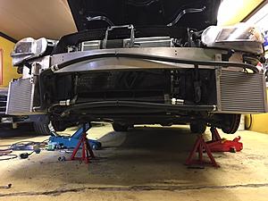

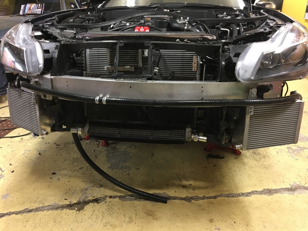

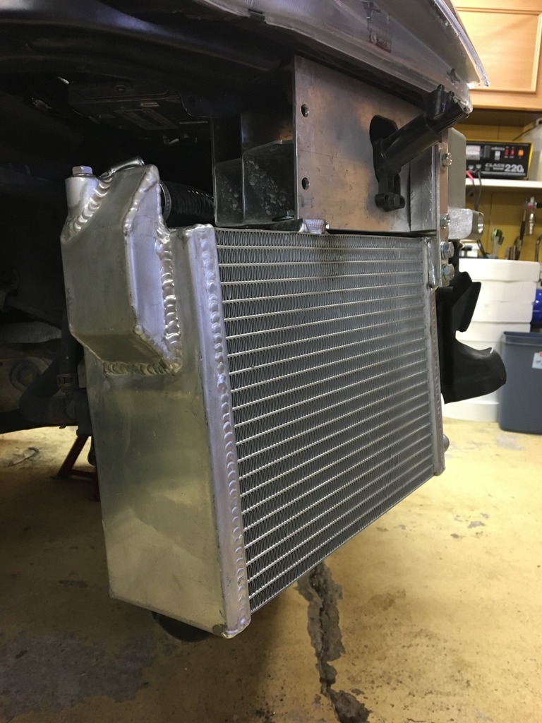

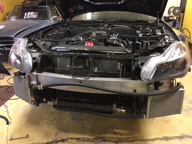

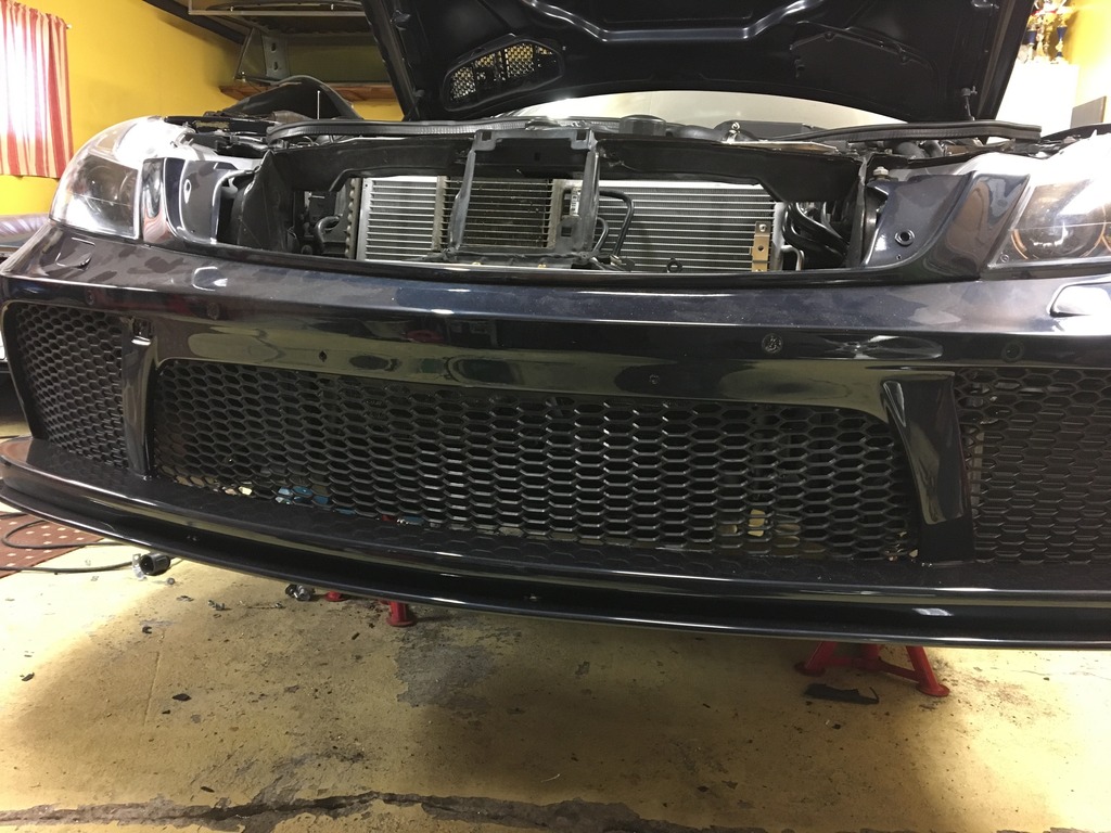

Finally the new HE exchanger has been installed.
I love the look.. I think this is the best place for the exchangers. No heat from the engine. So now I have 3 HE at my car. Very interesting too se how much suction temperature drops. It was very tight everywhere. No space at al. I had to do new engine oil hoses also because it was so tight. But I think these places are the best place to install the HE. No heat from the engine at al.

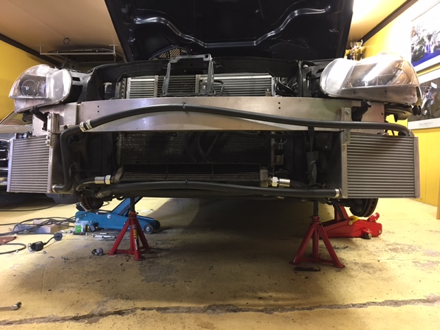

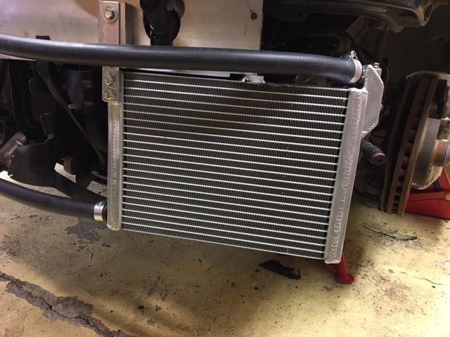

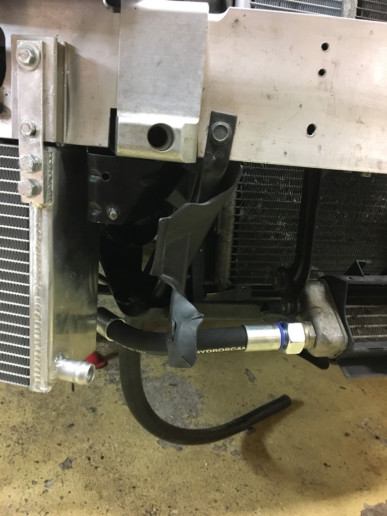

Well.
Now they are pre-installed. I changed to better hoses. It looks great.
