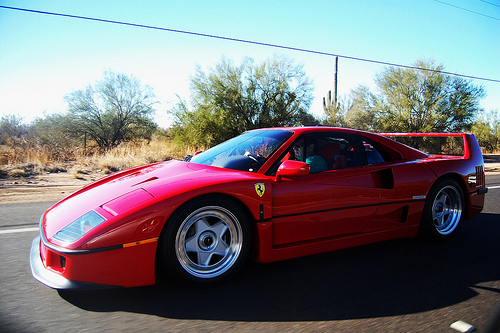

Thanks on the F40. As far as your Sl55 goes..... remember that it is a $150,000 car and as such, in order to keep it running as it should, it's going to cost a bit of money. If $400 is causing you to feel like you are bending over, this is going to be a rough ride! It sounds like you got a great car, just maintain it and it will be even better.
Here's a shot of the F40...

As for the F40. It doesn't come better that that. Just sublime.
