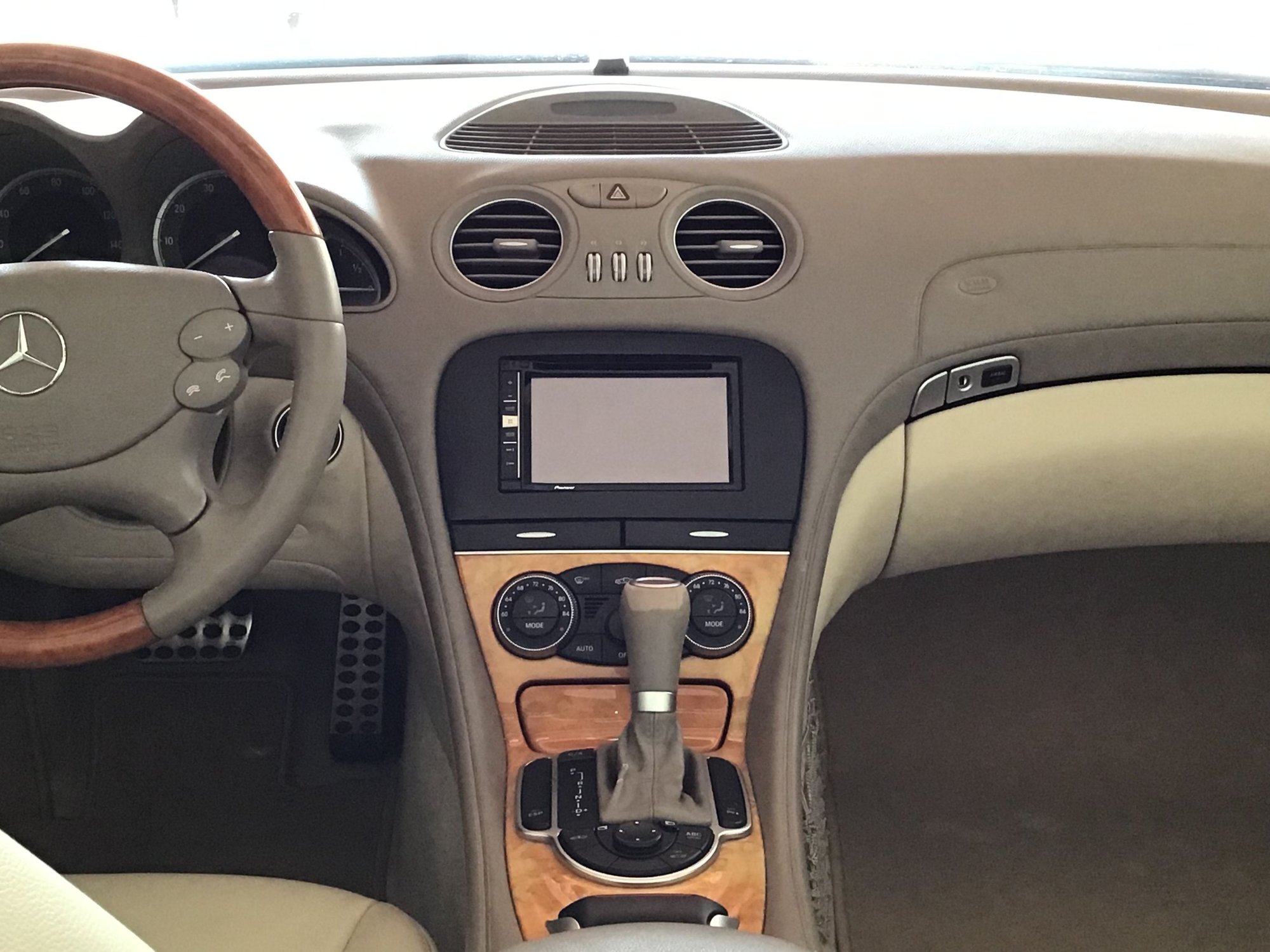

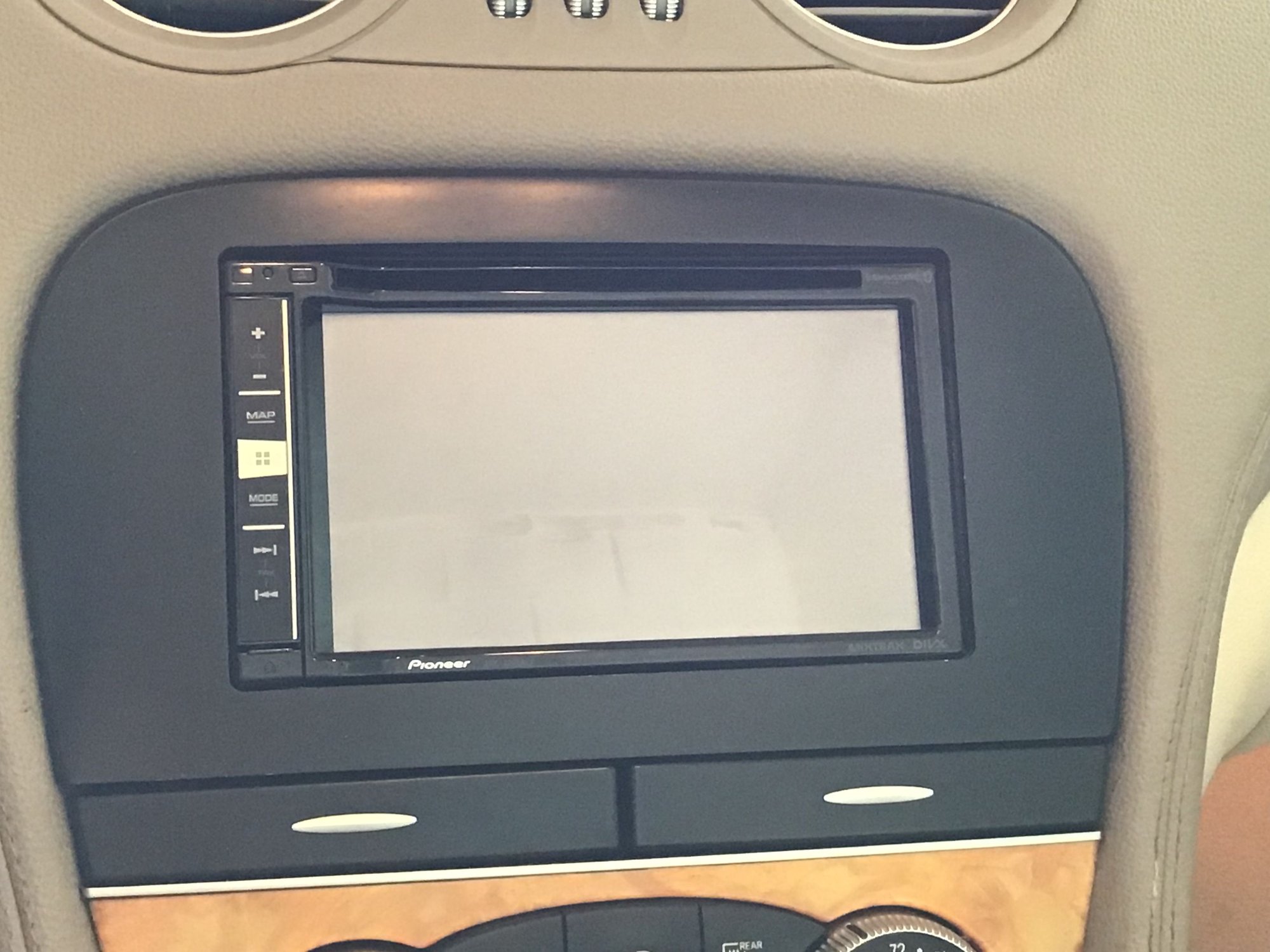

I upgraded my 2003 Sl55’s radio with an Android unit. Tried everything under the sun (aside from opening up the circuit board) to get better radio reception with zero success. I gave up and just use the local station or mostly use Pandora from my phone or listen to music I have stored on the sd card inside the radio. Overall it is a huge improvement over the stock radio since I now have Bluetooth capability... much better navigation, etc.

The Metra steering wheel control adapter would definitely fix the steering wheel controls. Your install looks pretty good and probably already has it. If not, it would be very easy to install and would definitely fix the SWC issue. Here is a link: https://axxessinterfaces.com/product...s-instructions

What year is your SL? If 2007 or 2008, perhaps the NAV-TV kit would help to convert it to work with the MOST interface? I am trying to decide what to do for a 2007 SL55, and this fiber conversion kit seems like a good idea. I am trying to decide between the Seicane and Alpine, but based on what I am reading the Alpine seems like a safer bet.

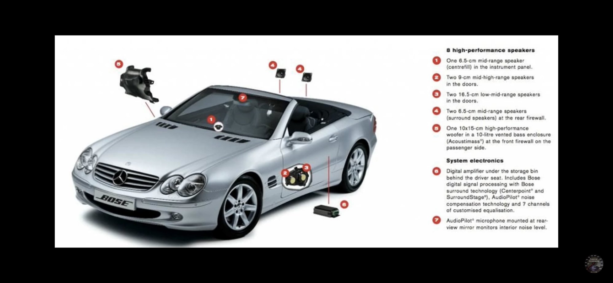

You need a lot more than just center trim. 03 SL uses a proprietary fiber optic loop whereas from 05+ they switch to MOST fiber optic loop. This means you will need to replace your head unit, amp, and wiring.
I have a full MOST wiring harness, just trying to determine if it's worth the hassle of an upgrade.

Does anybody know if my car has built in amp?
It does not.
Originally Posted by acmw
...they send me the radio with a 6m wireharness that plugs into the bose AMP.
The audio input to the Bose amplifier is light instead of electricity. I presume that harness plugs into the existing Bose amplifier connector and bypasses the Bose.

Center fill speaker
My 04 SL55 does have the fiber optic amp which I will have to replace
does anyone know of an amp that has a center full channel? Wasn’t planning on replacing speakers. The dash speaker is a center fill that apparently is a blend of left and right
