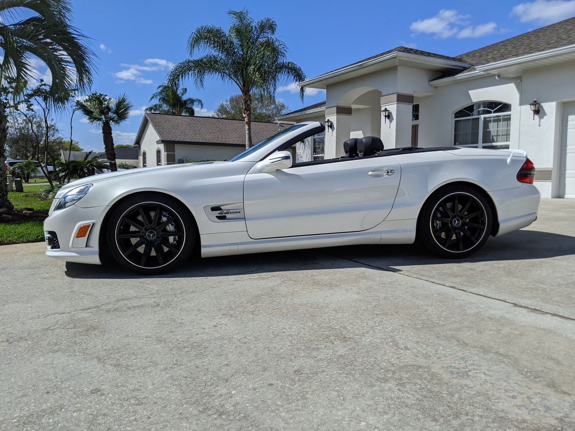

Here are 19" black wheels from my 2014 E63 on my 2009 SL63
The tires are the same size on both cars, the front wheels are 9" versus 8.5" stock on the SL 63. Rear are 9.5" on both. The E63 offset was off by 20mm so I added 20mm spacers to the rear. Front have a 10mm spacer as shown in the photo. I don't mind the look but will go back to the originals when I get back to Canada in the spring. I had damaged one of my front wheels and didn't have time to repair it prior to driving the car south for the winter. I don't mind the look though, it is a nice change and the car gets of lot of good comments.

Here are some additional pictures
I agree with OKbarnett on tire and wheel size. There are some calculators available that will give you optimum tire/wheel size parameters. With respect to our vehicle I do actually think the first person who posted was also correct and the diameter will be out by about 3% but you can also use the calculator on this site to figure that out.
i think you could live without the 10mm spacer in the front. I needed it for my other wheels but left them on as they were glued to the rotor.
Hope these help make your decision!
James

Like the white car, I think those are aftmkt wheels, you may be better off to get a wheel which is the right size, than to space the wrong wheel. depends on $

Thanks OKbarnett. These are oem amg wheels but I took them from my E63 so I could get the car to Florida for the winter, hence the different offsets. I had cracked a wheel on the SL and didn't have time to repair /replace before I planned to take it down south. These wheels will go back on the E63 in the spring and I will put either the originals or the after market set I have back on this car.

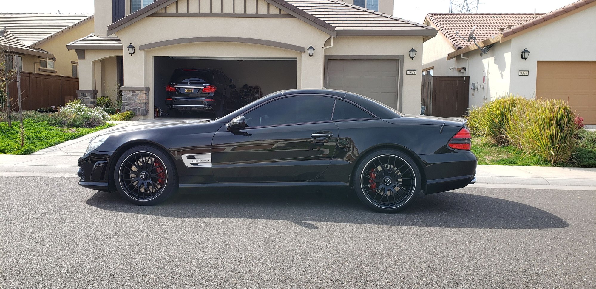

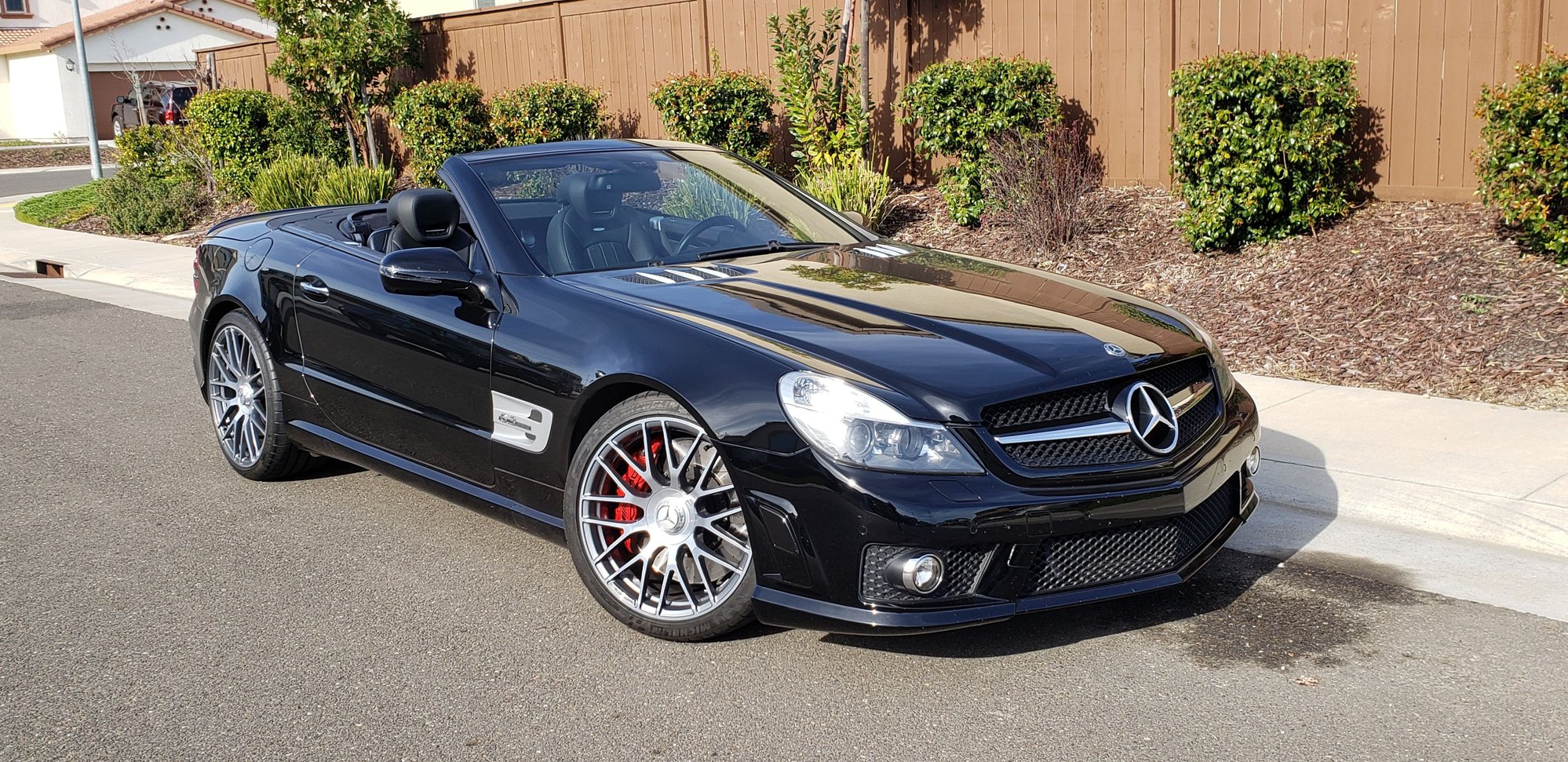

Current situation update with photo 📸
I didnt go for the 10 spoke after all.
I got my hands on these 19/20 split spoke polished and titanium design
this current situation just looks right 😈 so much more appropriate.

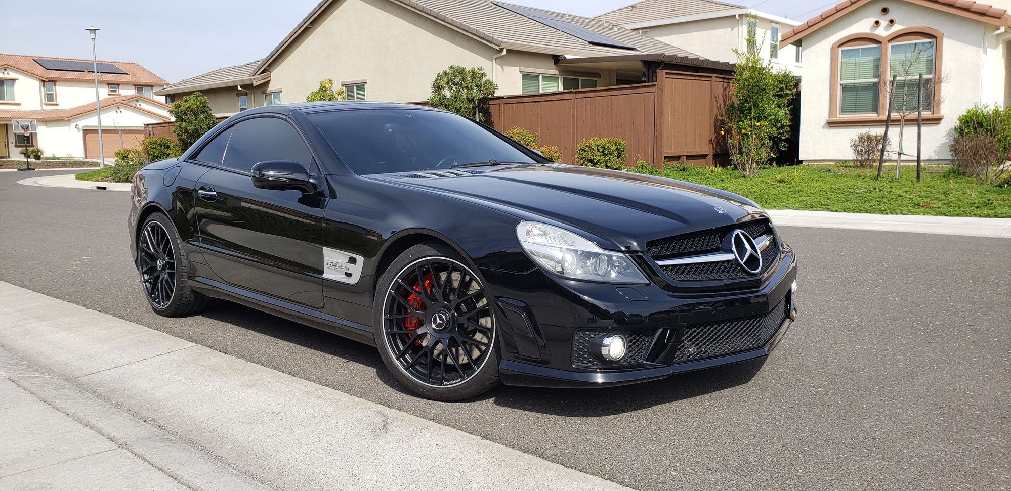

Finally complete. Just how I wanted it 🖤😎
Had the wheels refinised to factory satin black with machined edges
Finally complete, just the way i wanted it. This just looks completely appropriate
