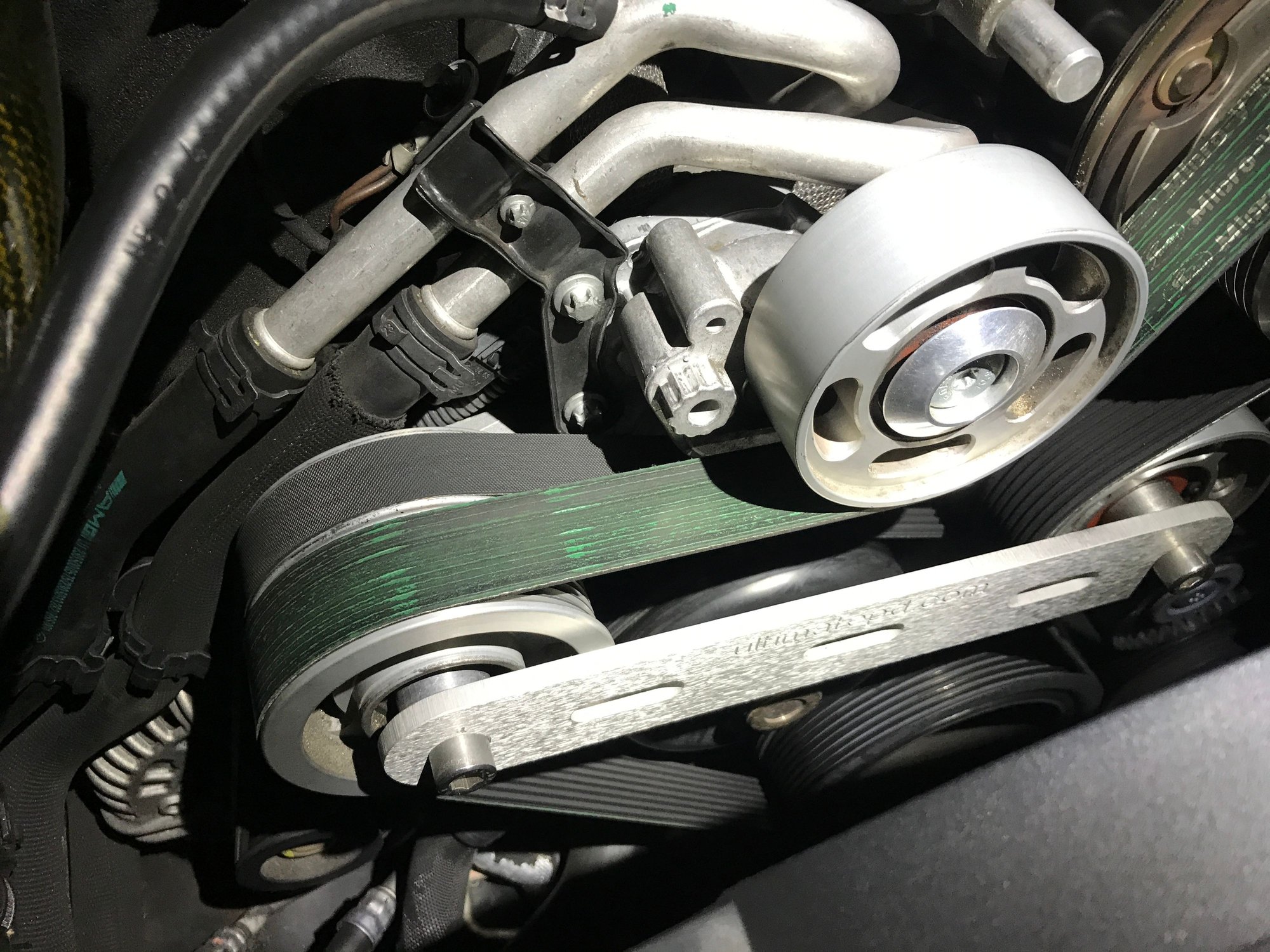

I could use some help guys.
I purchased a smaller s/c pulley, tune and belt wrap kit from VRP Performance. Now when I get on it a bit and let of the accelerator a little the car jerks violently. It feels like something is not disengaging or like something in the drivetrain should disconnect and freewheel but remains locked up. Does this make any sense to anyone? Belt wrap kit causing this or maybe the s/c not disengaging properly? You guys are the gurus. I'd sure appreciate your opinions.
Thanks, Bill

Did you do a tune? Any change in the stock pulley requires an accompanying tune. If so, with a feeler gauge, how’s the gap between the pulley and clutch plate? Spacers enable you to keep it within spec.

Yes sir i did a Race IQ tune as well as their smaller supercharger pulley. I've not checked the gap but was looking online last night and haven't found the spec yet. That is the next step I guess, and if that doesn't do it I guess I'll remove the belt wrap kit and put the old belt back on for a minute to see if anything changes.

The spec is .035-.045, But mine’s a bit smaller than that. I already verified with UPD that it’s fine. If it’s too grabby, it will result in premature wear and possibly the jerking that you’re experiencing. I didn’t use a BWK since I only went to 83mm, which was verified as OK. No slippage that I can tell.
