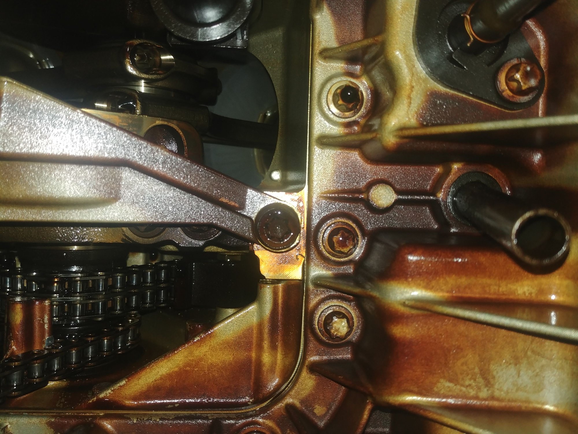

You just need to cut off a section of the tube from the bottom, and you'll have enough room to wiggle the tube free after that. I used a tiny pipe cutter to avoid throwing sparks and getting a mess inside the bottom end of the engine. Cutting the bottom of the tube off is the only possible way to remove the dipstick tube without removing the cylinder head instead.
I didnt measure it, to be honest, but this should give ya a good idea. If you pull the dipstick up as high as you can and then make a mark on it from underneath, just cut it a tiny bit above your mark and you'll be good to go.
This is the view directly from beneath. There is still more than plenty of the straight piece of tubing for the dipstick to remain straight.

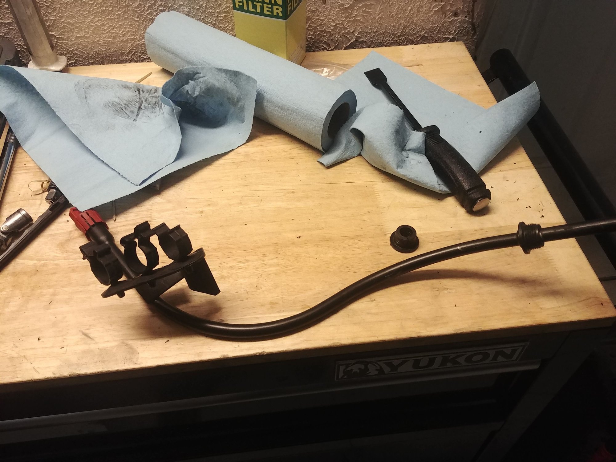

This is what the dipstick looks like out of the car. Not really important, but i took a picture anyway so here it is.
