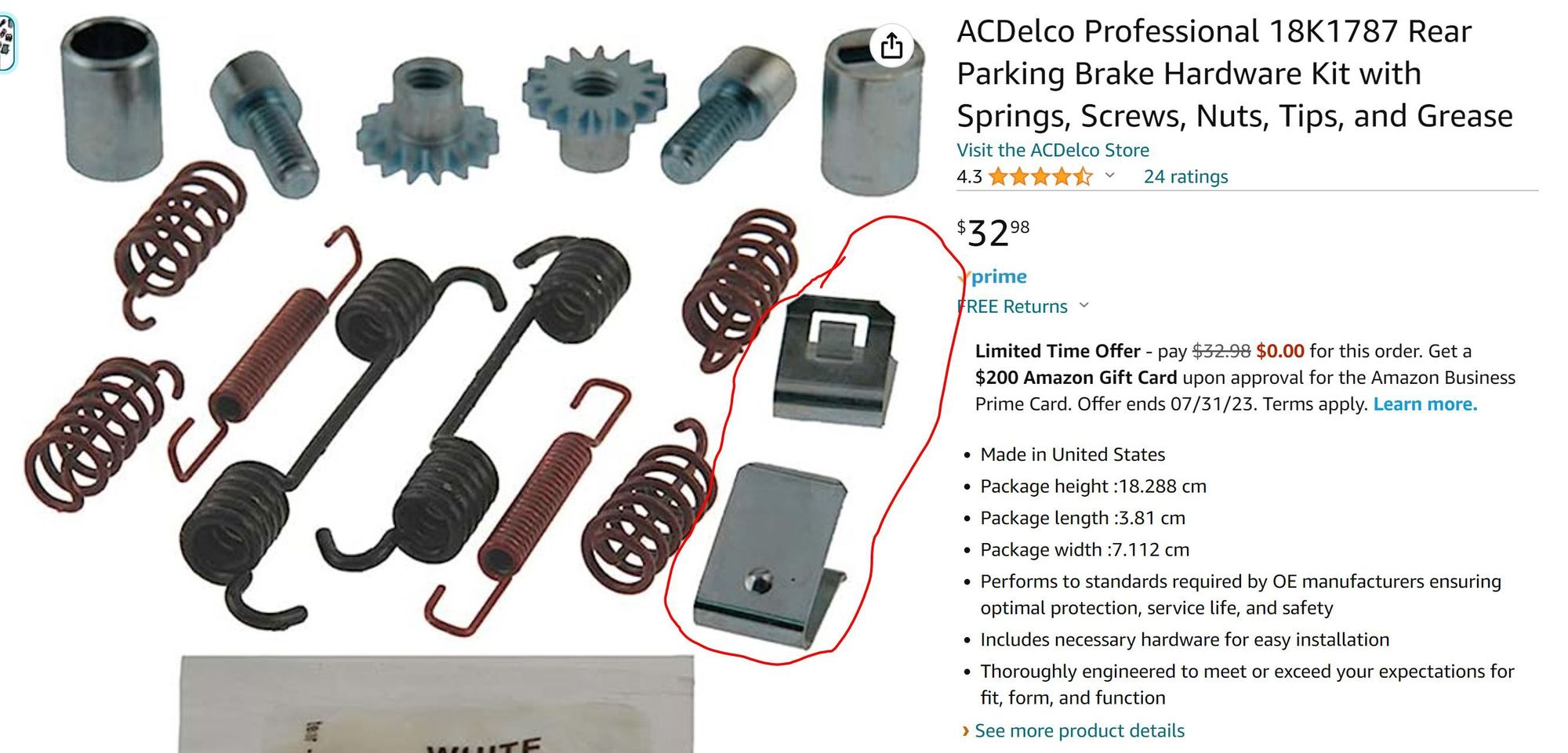

I found something loose inside the drum area... I don't know what it is. I can't find a spot that looks like it would go there. I took the other side apart to look and didn't see anything that looks similar. Anyone recognize this?
If you look inside the drum area, it's sitting at the top.

If I look at a hardware kit, I do see the clip that was in there. See the image below. Every video I've seen does not show this clip being used.
