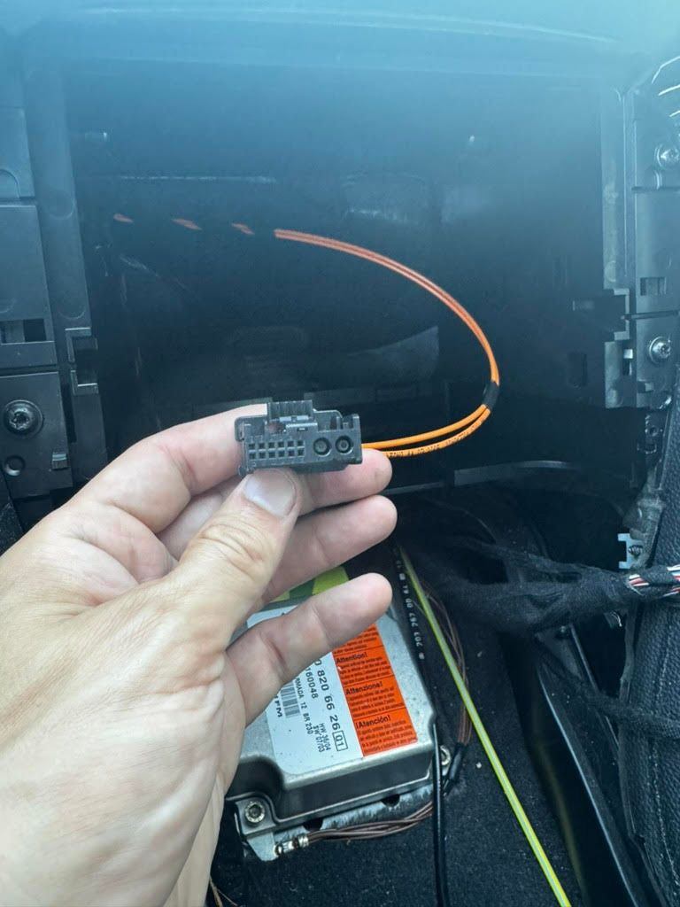

Has anyone tried to install and aftermarket head unit in the SL2005 edition with optic fiber ?
I ordered a
OEM Android 13.0 for 2001-2011 Mercedes Benz SL R230 SL350 SL500 SL55 SL600 SL65 Radio with Bluetooth 9 inch HD Touchscreen GPS Navigation System Carplay support DSP
with the 8h Rom edition. link

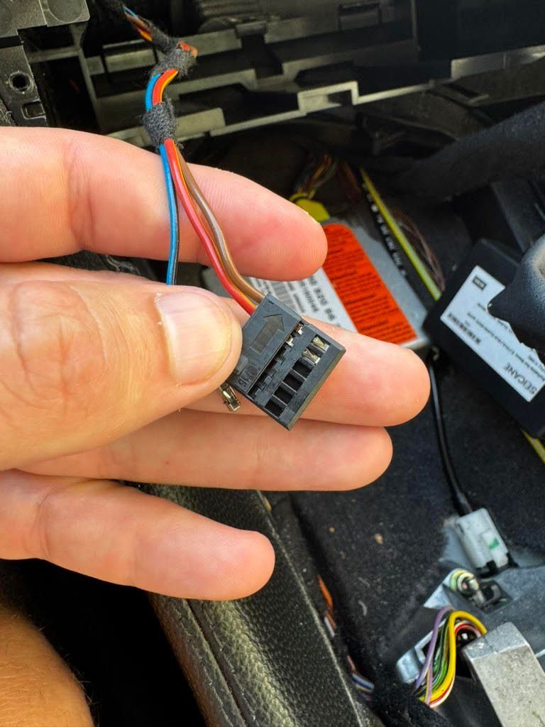

However there is no way to get power on this system, I have tried all possible guides on the whole internet including the one your support team sendt. the unit won't turn on.
Diagram from seicane
Optic from car
Optic from car
Plug from car
Plug from car

Hi - the stock harness only has constant power (red/yellow) and ground (brown) - the Seicane also needs an accessory, you can tap into cigarette lighter and figure out which pin it needs to go to.
